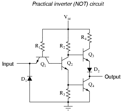

@Laplace Would it be possible to use a PWM circuit like the one attached to do this? Then the output of each of the 2 circuits would be connected to pin 5 for voltage control. Otherwise I could use a NOT gate (also attached) like you suggested, if I understood correctly. If I needed low voltage DC pulses, let's say 10-20v and no high amperage or anything, what would to your idea be the most efficient setup?My electronics knowledge is quite basic so dont hold back on the details,thanks for answering
