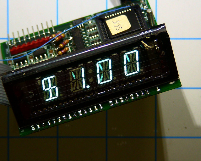

vfd display: Noritake al041ma

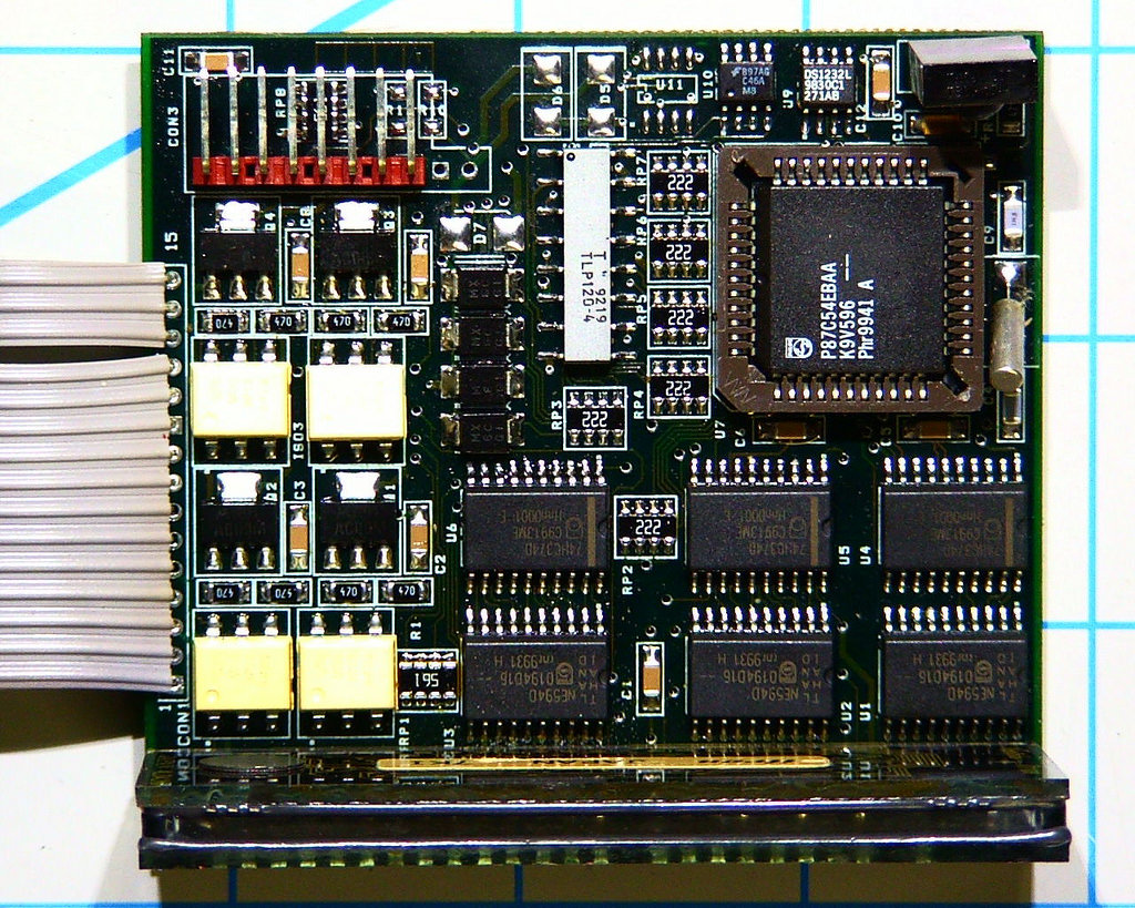

74hc374d octal d-type flip-flop: http://www.mouser.com/ds/2/302/74HC_HCT374_CNV-466055.pdf
ne594d vfd driver: http://www.digchip.com/datasheets/parts/datasheet/364/NE594D-pdf.php

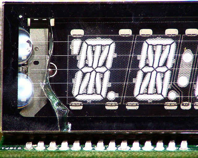

Yes.... I believe the vfd displays are at fault. They seem to be getting the correct power when checked with a meter. But I am just checking the vfd pin voltages. I am not sure how else to check with the chip setup on the timers?
Some are buzzing, some are cracked and some seem to only have segments burnt out.
I've had a quick look at the drivers used for these displays. As expected they're a high voltage, low current driver.
If you can determine the pinout of the display it may be possible to make something to drive a LED display, but practically, $100 is unlikely to cover your costs unless you make quite a number of them.
