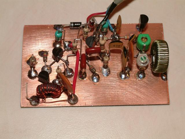

Superglue works well for Manhattan Construction (I've used it), so it
ought to work for gluing two blanks together (I haven't done it).
For those not familiar with it, Manhattan Construction involves
gluing rectangular or circular PCB material pads onto the copper
side of a blank PCB. Point to point wiring is used between the
pads. If you make the pads from double sided PCB, you can solder
them in place - like surface mount - instead of using glue.
Ed

JeffM said:
ehsjr said:
[...]Manhattan Construction
involves gluing rectangular or circular PCB material pads
onto the copper side of a blank PCB.
That is not what I identify as the primary characteristic of that term
--nor even a necessary characteristic.
I guess you haven't done any "Manhattan Construction" boards. Using
pads and gluing (or soldering if you want, when pads are made from
double copper sided boards) _is_ what makes it "Manhattan Construction".
See any of the following sites, including the one you posted for the
description of "Manhattan Construction". I'll quote from the site
you mentioned after the list.
http://www.piclist.com/techref/pcb/manhattan.htm
http://www.eham.net/articles/16536
http://www.offcycle.org/index.php?option=com_content&task=view&id=43&Itemid=26
http://www.w7dk.org/ARDF ATTEN PROJ only SCREEN.pdf
http://www.arrl.org/news/features/2002/12/27/1/?nc=1
http://www.k8iqy.com/construction/ConstructionMethods.htm
http://www.cliftonlaboratories.com/Prototyping.htm#Manhattan_Construction_for_RF
http://k7qo.net/lab.pdf
When I think of this technique, I envision the skyline of NYC.
That is, the components are stood on their ends:
http://www.w7zoi.net/bboard.pdf
This can be done with standard perfboard
or with a purpose-built PWB (for a small footprint).
From the site you posted above, read the information it
contains. See page three, figure 2 and the text:
"Several other construction schemes offer similar grounding fidelity,
including those where small pads of circuit board material
are glued or soldered to the ground foil. These pads then have
components soldered to them. I've found this to be useful when a
slightly massive component such as a floating (non grounded) trimmer
capacitor is used. The specific glue type has little impact on
circuit performance. Variations of this method have been called
"Manhattan Construction," and can be mixed with other breadboarding
schemes."
Ed

krw said:
I've never seen "Manhattan" overloaded for that sort of construction.
"Manhattan Routing" is done using wiring at right angles, rather than
"as the crow flies", and "Manhattan Distance" is the distance from
point-A to point-B at right angles. "Manhattan" here being limited to
the streets and avenues since leaping over tall buildings isn't
allowed. Your "Hanhattan construction" doesn't seem to fit on the
same island. ;-)
You can see photos of it here:
http://members.ziggo.nl/cmulder/nc20.htm
http://www.qsl.net/k8gd/images/2N2_30_VFO.jpg
And this site shows it sort of step by step with photos:
Enjoy.
Ed
