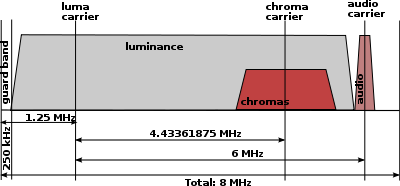

I was under the impression that NTSC CRTs ran with 525 horizontal lines, either clocked 1 thru 525, some being blanked, or interleaved. Half the lines on first pass and other half on second pass. Odd number lines then even number lines sort of thing. I have no knowledge of LED monitors but assume that it is similar in the notion that each pixel is lighted with its unique data package and pixels are enabled sequentially.From back in another life ... TVL, television lines, is a semi-subjective measure of the maximum image resolution ***in the horizontal direction only***. Vertically, resolution is fixed by the number of scan lines in a frame. Horizontally, resolution is based on the signal bandwidth - the highest possible frequency of rapid changes from very bright to very dark. This value is tightly regulated for signals that are broadcast over the air, but not for a privately contained system like what you are describing.
So, even though the nominal horizontal resolution is around 400 lines in NTSC, it is entirely possible for the camera's signal system to support 1000 lines. Now the limiting feature is the quality and resolution of the image sensor in the camera. One would think that it is simple - 1400 pixels horizontally could make a signal with 700 alternating white and black signals for a resolution of 700 lines (one TVL is a two-pixel pair, one bright and one dark), but it's not that simple. People get away with all kinds of claims about resolution. Check the datasheet or press the manufacturer for the sensor "size" in horizontal and vertical pixels.
The NTSC vs. PAL resolution debate has been on for decades. For still-frames and non-broadcast, PAL has an obviously higher vertical resolution and probably higher horizontal resolution (back in the vidicon/plumbicon days). NTSC has fewer motion artifacts because of its higher field rate, for better apparent resolution in a moving image.
