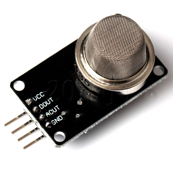

It has four pins, but I don't know which are the triggers. All of them? How do I connect it up to a simple circuit that, for example, would sound a buzzer as soon as a certain level is detected (can be set on the module) and go off when the under that level.
Hi Chris, does it have any markings for the pins on the other side of the PCB. Your going to have a TTL (Digital) output an analog output and +V and 0 V (Common)

Thanks Adam, the product listing states there being a signal output indicator and a dual signals output (analog output and TTL output). TTL output signal is low level, allows to connect with SCM directly. Analog output 0~5V.

I think it could be that simple. What buzzer are you going to use?

That's the IC they are using to generate the TTL level. What I was trying to find was the data sheet for the actual module. However it does tell you the output can sink 20 mA. So you need to find a buzzer that draw this much current or less. Otherwise you are going to need some kind of current buffer on the output.

Alright. So it should work by hooking up the ground and signal pins in series with a 5v source and a suitable buzzer, the sensor and module together acting as a switch? Or is there a little more to it than that? Electronics aren't usually that simple in my limited experience haha

Nope that's it, the LM393 has an open collector output so you connect the buzzer - Pin to the sensor and the + Pin to 5 Volts. These sensors normally draw quite a bit off current in the 150-200 mA region, because they have a heating element inside. So make sure your power supply can supply this much current without overheating.

This image may help with wiring that puppy up:
