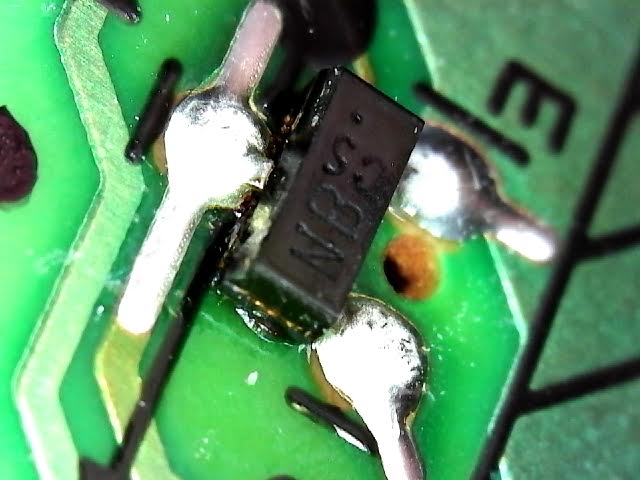

Can someone ID this Transistor ? Offer Equivalent part ?
Its from a SHARP TV LED. Model: LC-26DV24U. Specfically its Q419 on the Power board. Thanks in Advance.

NB could be a BF599 or a FMMTA55R
I have those 2 listed for that code ... but with the same code often used for many different devices from different manufacturers, one can never be sure
in this case, those 2 choices are the most likely
A service manual would be the only way to tell for sure
Yes, that part matches up with common parts in the SHARP service guide that I have. Multiple points on the board with that part...

hence why I followed the comments with the proviso of same code for many part numbers
in this case those 2 I gave were no good
the Q419 transistor, a compound transistor = a digital transistor with 2 built in resistors and is NPN
the best data for the KRC102SRTK is this one .....
http://pdf.datasheetcatalog.com/datasheet/kec/KRC101_6S.pdf
and that datasheet even shows the correct SMD code NB
If Sharp cannot supply a replacement, it may be difficult to find one considering it's a specialist type
