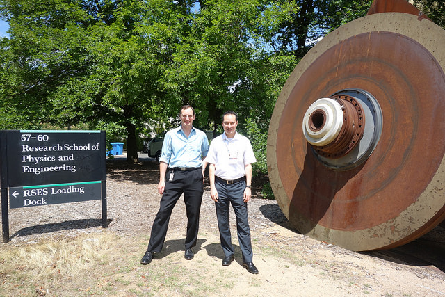

Each time the Navy rail gun is fired, humongous forces are created in the wiring to the rails and between the rails themselves. A major part of the engineering design is figuring out ways to allow for those forces. Early versions of synchrotron research were performed at the Australian National University using a copper disk spinning in a strong magnetic field aligned with the axis of rotation. This configuration constituted a homo-polar generator capable of producing two-million ampere pulses while decelerating the spinning disk. We considered proposing this as a portable power source for a vehicle mounted rail gun in the 1960s, possibly spinning up the disk with a gas turbine engine. However, weapons-grade rail guns did not exist then, and there were problems associated with switching two million ampere currents.
Rotator from the Canberra Homopolar Generator, developed during 1951-1964 at the Research School of Physical Sciences, Australian National University, under the direction of Sir Mark Oliphant. The CMG was dismantled in 1985. Certain parts were constructed into an artwork, and placed beside the school.
With the availability of rare-earth "super-magnets" comes the possibility of constructing a can crusher excited by a homo-polar generator. This would replace the somewhat dangerous high-voltage capacitors with a rotating copper disk. The electrical circuit could be completed with a "hockey puck" SCR which is capable of switching tens of thousands of amperes on a pulse basis. These are now commonly used in capacitance-discharge welders as well as large three-phase motor controllers, Might be a little pricey unless you can find one in used condition. A fast-operating mechanical switch might be good enough for a can crusher, but a triggered arc gap for high-voltage capacitor discharges is cheaper and probably more reliable. Building a triggered arc gap is itself a challenging project.
