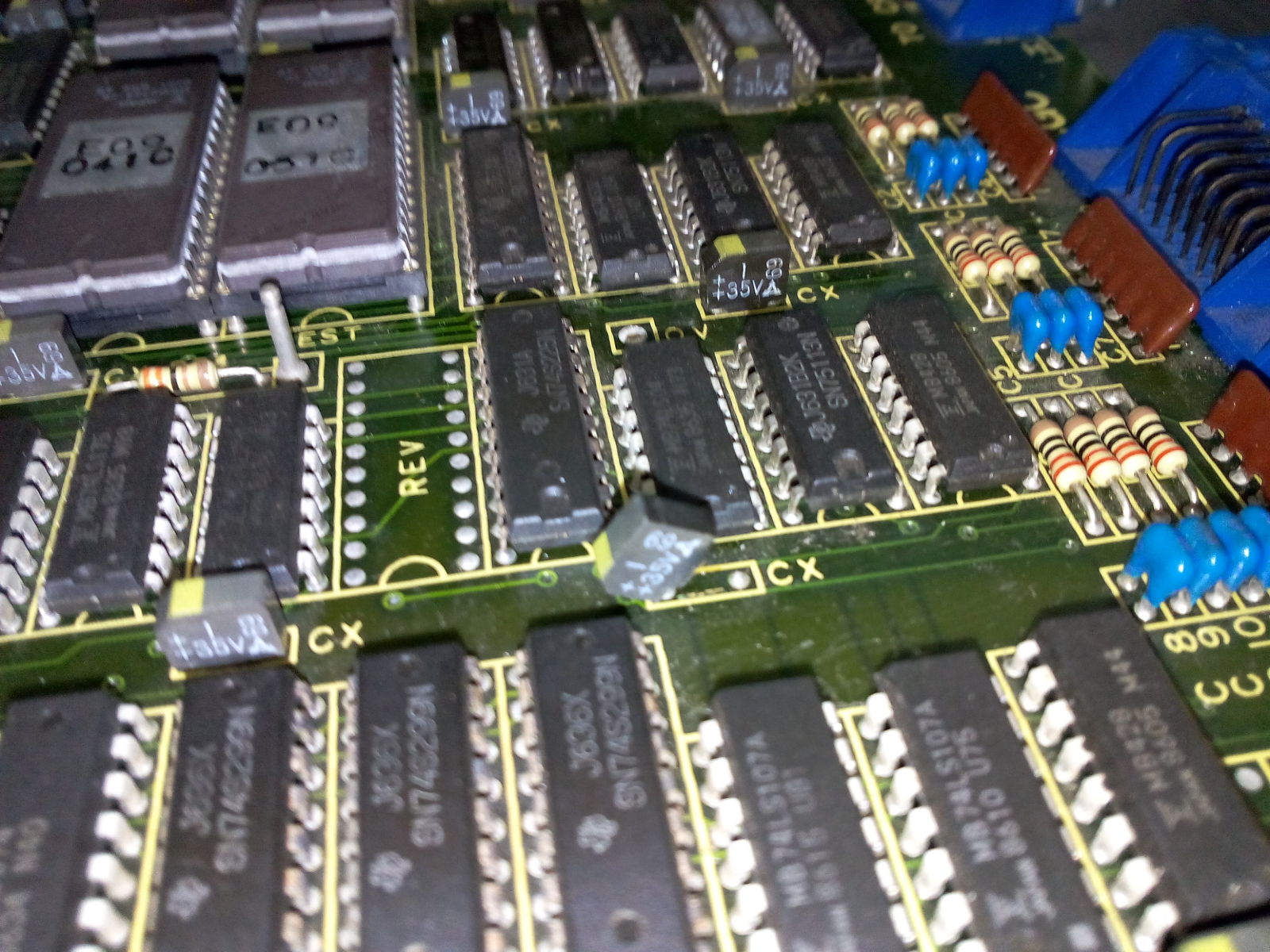

This is a part from a Fanuc edm video board. I bought it to replace mine and it came in like this. And anyone identify it? It is the block with CX next to it. 35V.
I am thinking a 1uF 35V Tant, but to be honest I have never seen them look like that before. One of the other guys might know for definite.
Adam
Looks like the bus line decouplers, you could remove a good one and test it, even if it is with a Ohm meter, you should get a fairly accurate reading, not super critical for that.
