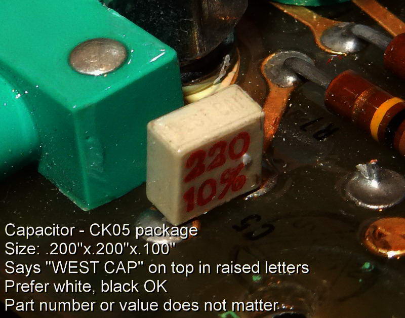

Can anyone help with finding this vintage capacitor?
Package: CK05
Size: .200" x .200" x .100"
WEST CAP in raised lettering on top
White is preferred, but any color would be okay if the package is identical
The capacitor¹s value is not important and it doesn't matter if it works, as long as the size matches with WEST CAP on the top. I
am doing a visual restoration.
I would be happy buying any number of these.
Thanks,
Chris

OK so have you googled West Cap ?
I have never heard of that brand
and if it doesn't need to work, why do you want to replace it .... all seems very pointless
You might have better luck searching using the correct size &/or one of the non-milspec designations - CK05 is 0.190" x 0.190" x 0.090" (all +- 0.010"), and is equivalent to Kemet C052 (among others) - on the surplus dealers & stores.
West Cap (aka WestCap, West-Cap, etc) became Arizona Capacitors.
