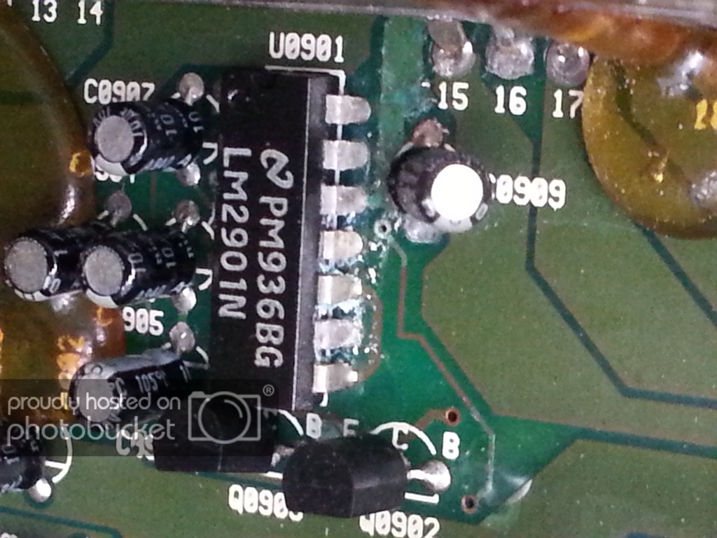

I found oxidation on what I assume is the power amplifier board by a 14 pin quad comparator LM2901N - the corrosion was found underneath and what seems to be a burnt out diode?

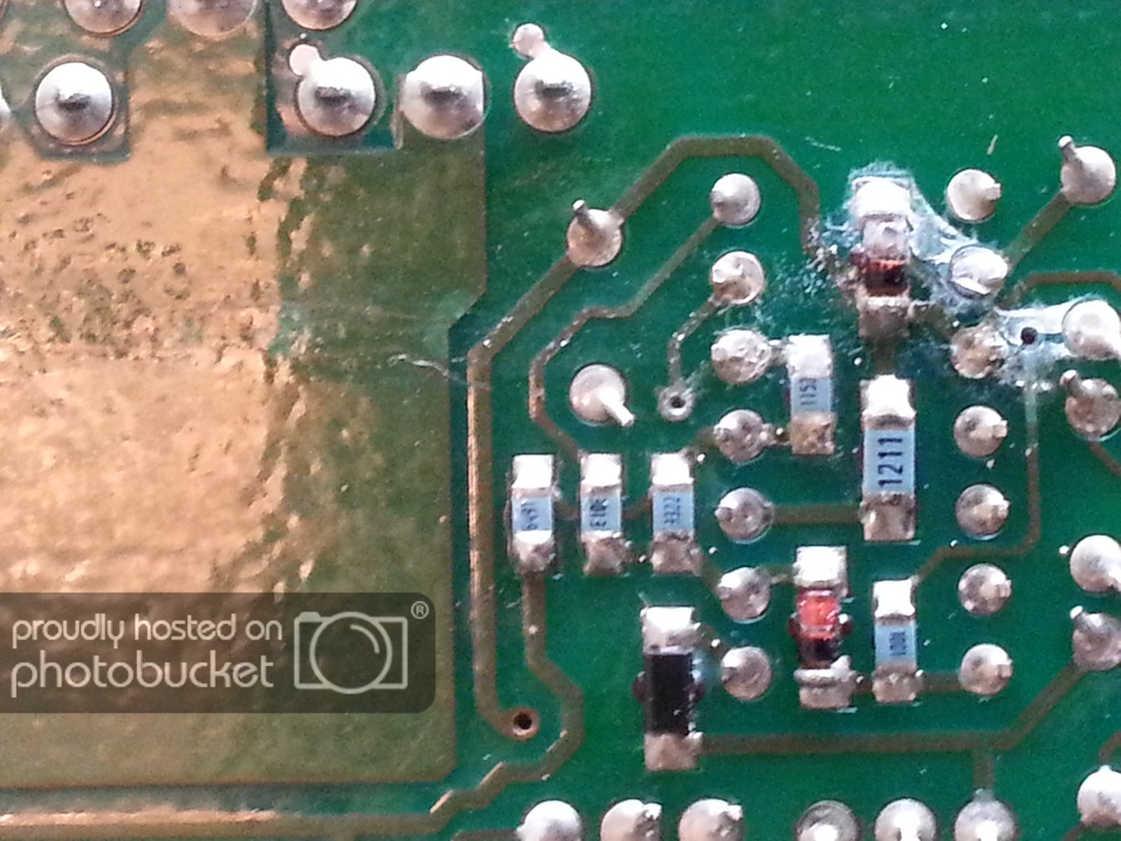

This pict. is directly under the IC - the 'burnt' diode is top right. It looks like it was a red glass barrel type smt diode, similar to the lower one.

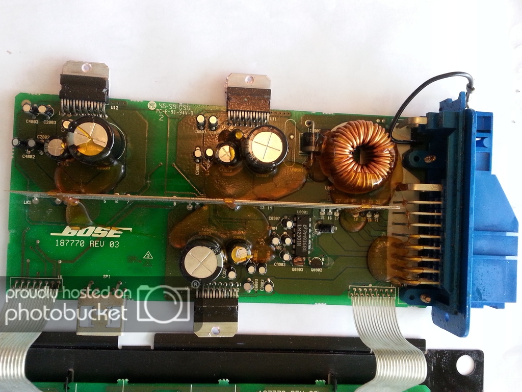

Here is a complete shot of the 'power' board

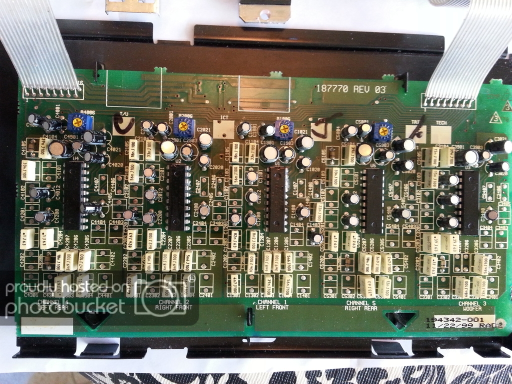

Here is the board that is attached by those thin wire ribbons - I assume it is the audio processing board, as there are 5 IC's and there are 5 channels to this system.

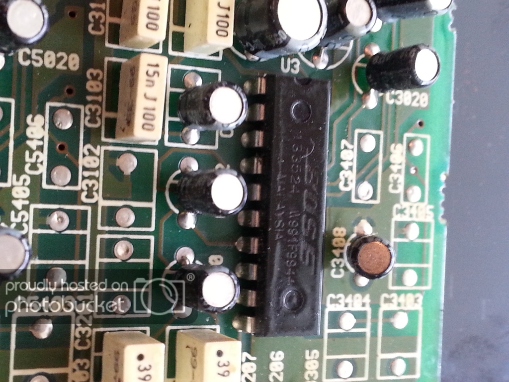

A close up of the above IC is marked Bose.
