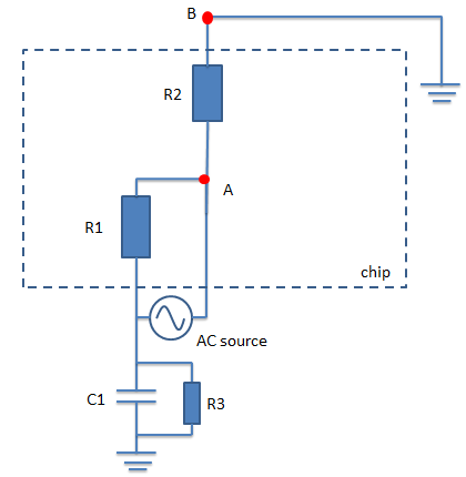

I put a chip which has the following simplified circuit inside Scanning Electron Microscopy(SEM), an electron beam is irradiating on R1.
upload_2015-3-17_21-20-57-png.80525
The AC source is isolated from earth by using a capacitor C1 and resistor R3 in the middle.
I found that the electron beam is oscillating with a frequency the same with the AC source.
So I think there may be electric field resulted which deflects the electron beam periodically.
Then I did the following experiment.
upload_2015-3-17_21-24-43-png.80526

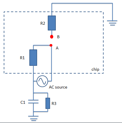

The only change I made is cutting off the connection between point A and B.
I found this time electron beam is no longer oscillating.
My question is that 1. how does the oscillating electric field produced?
2. why in the second situation, there is no electric field?
I know that electric field is produced due to potential gradient in space.
upload_2015-3-17_20-54-37-png.80520
I think in the second situation Point B should have a potential of 0V since it is connected to earth, Point A has a potential not equal to 0V, there is potential difference between them, why there is no electric field be produced between point A and B?

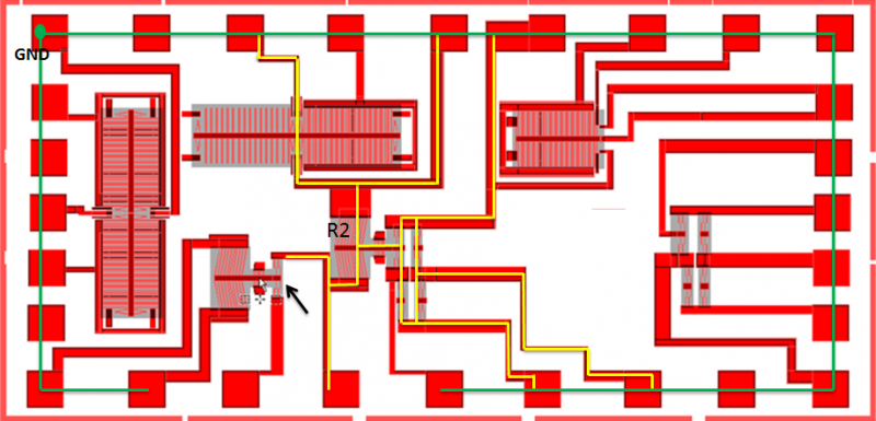

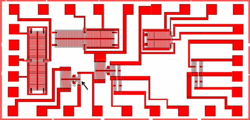

We fabricate a chip, a MEMS chip, mainly used for mechanical testing of nanostructure. The inner design of the chip is shown below.
upload_2015-3-18_10-28-34-png.80559

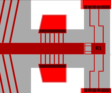

R1(250Ω) mentioned in first thread is the area which the arrow points at. Enlarged image is shown below.
upload_2015-3-18_10-33-57-png.80562
R1 mechanically function as a thermal actuator, it will oscillate under AC voltage.The aim of the experiment is to measure oscillation amplitude under different frequency. The part on the left is a fixed structure, it should always be stationary.
R2(500kΩ):
one end of R1 is also connected to other structures as I highlighted in yellow color. I simplified them as R2. All the pins are electrically connected(green line) using conductive tape, except the two pins through which the AC voltage is applied to. I connect the upper left corner pin to ground when doing experiment.
upload_2015-3-18_11-50-22-png.80588

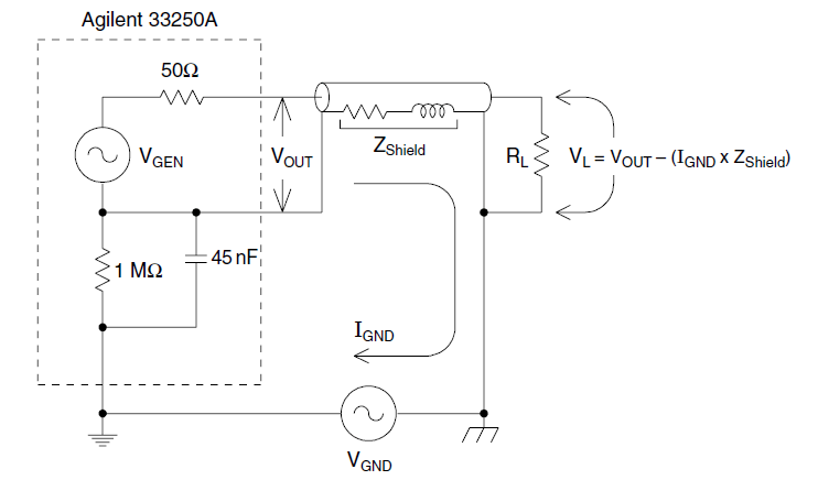

R3(1MΩ): The function generator we use to provide AC voltage is Agilent 33250A
upload_2015-3-18_11-28-39-png.80587
On the manual, it says "Except for its remote interface connectors and trigger connector,the 33250A is isolated from chassis (earth) ground. This isolation helps to eliminate ground loops in your system and also allows you to reference the output signal to voltages other than ground."

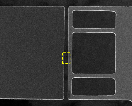

Below is the R1 under electron beam.
upload_2015-3-18_11-14-10-png.80584

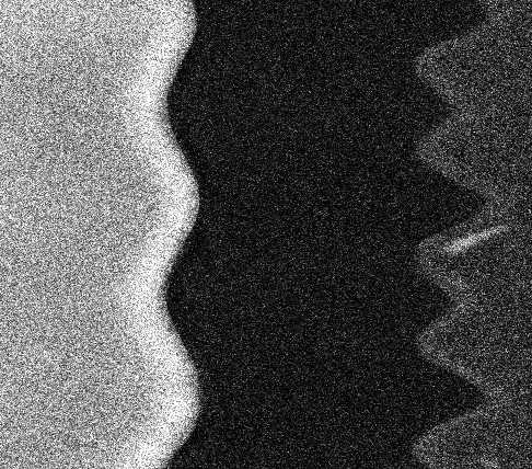

As I mentioned the left part is always stationary. But when I applied the AC voltage, I found the left part is also oscillating.
upload_2015-3-18_11-16-34-png.80586
I think the only reason is electron beam is deflected periodically.
If the electron beam is deflected due to magnetic field and magnetic field is due to AC current running through R2, then my question is AC current also runs through R1 and it is larger than current running through R2, then why the electron beam is not deflected in the second situation in the first thread?
