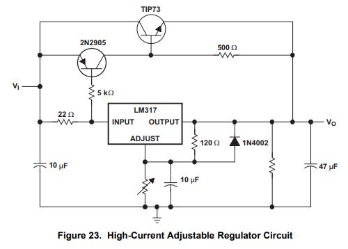

I am referring the below circuit diagram to make a High Current Linear Voltage Regulator circuit. This circuit is given in LM317's datasheet.
I need the regulator circuit to handle no more than 5 AMP Output Current. I think TIP73 a little overestimate for this current. Moreover, I do not have this transistor handy. For 5 AMP output, what would be the alternatives for TIP73 and 2N2905 transistors in this circuit?
Can I replace them with 2N3055/TIP3055 and TIP42/MJE2955 respectively? Would 2N3055/TIP3055 cause any interference to the LM317 to regulate the output voltage?
![2jfja7q.jpg](/forums/proxy.php?image=http%3A%2F%2Fi65.tinypic.com%2F2jfja7q.jpg&hash=3dc78d9fd2f480eb49e18ef2090e57af)
