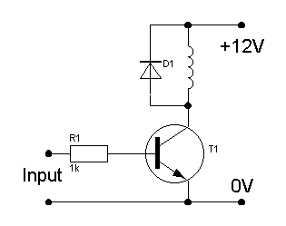

Will adjusting the frequency mess with the output voltage at all up or down?
And one other thing, I'll be driving this by 12v, my solenoid right now it 12v, this module outputs 5v, its that easily adjustable to output 12v? I'm sure my solenoid will work on 5v too or I can get a 5v solenoid but if I could output 12v it would make my life easier.
Sir supak111 . . . . . . .
This unit should be giving you a full logic level LO-HI from its supply . . .at all frequencies.
The OOOOMPH power required for the drive of a solenoid coil would be requiring the feeding of the pulsed signal into a transistor base . . . .preferably a darlington type . . . .or into the gate of a FET. . . . . . . . . preferably with a low Rds on spec.
That has full 12VDC then being your solenoid POWER drive level and the 5v feeds into to the driver semiconductors base or gate..
The solenoid should have a damper diode across it for protecting your connected semis from the the coils back EMF "kickback"voltage . . . . that is developed at turn off time of each pulse fed in..
  • Typical transistor utilization:
  • Typical FET utilization:

Awesome, I can't wait to try this. I'll focus on getting the frequency down and if it turns out that this can go low enough I'll then add a transistor.
