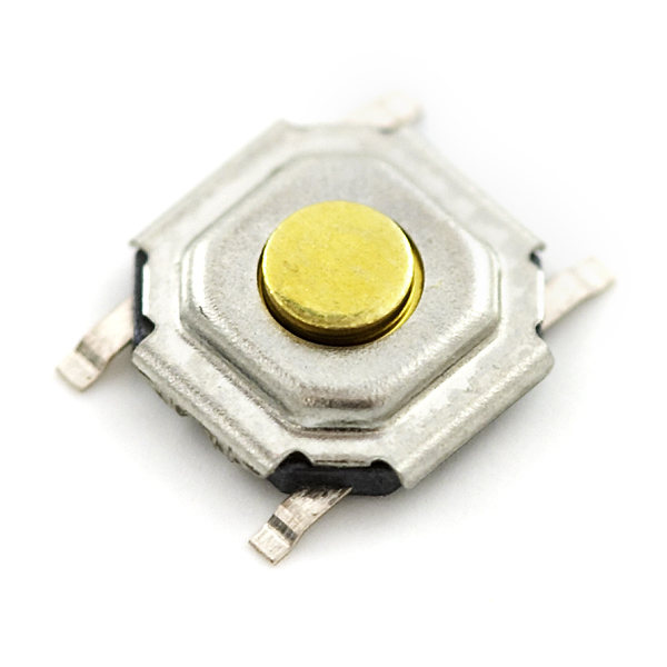

I'm thinking of using switches like the ones in the below photograph which I will glue in position on the case. I'll lead the wires along the top of the case too and try to give it the cyberpunk look that's so hot right now :p
