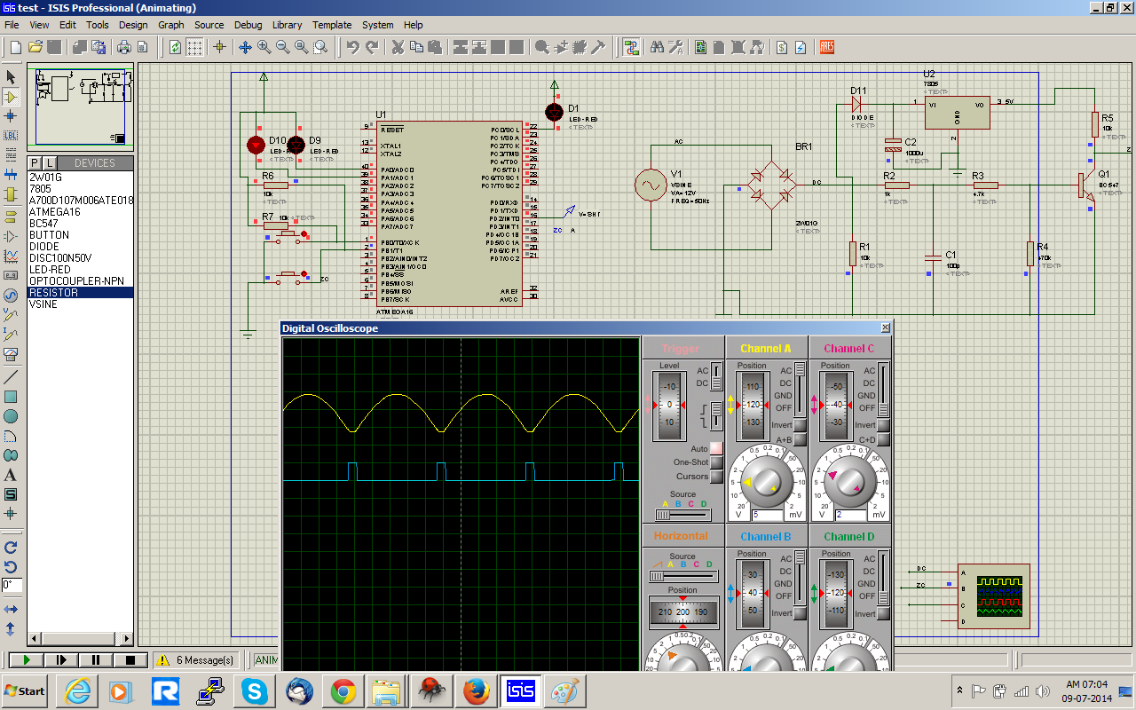

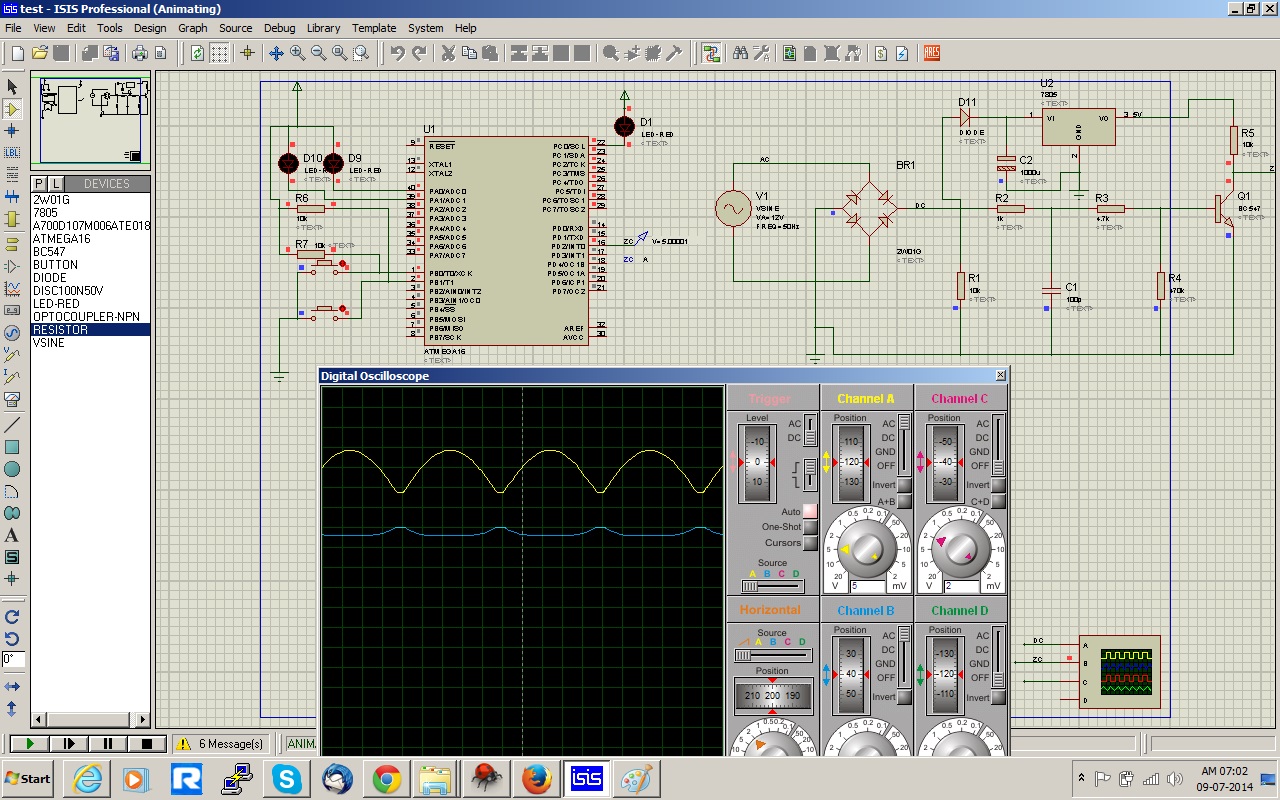

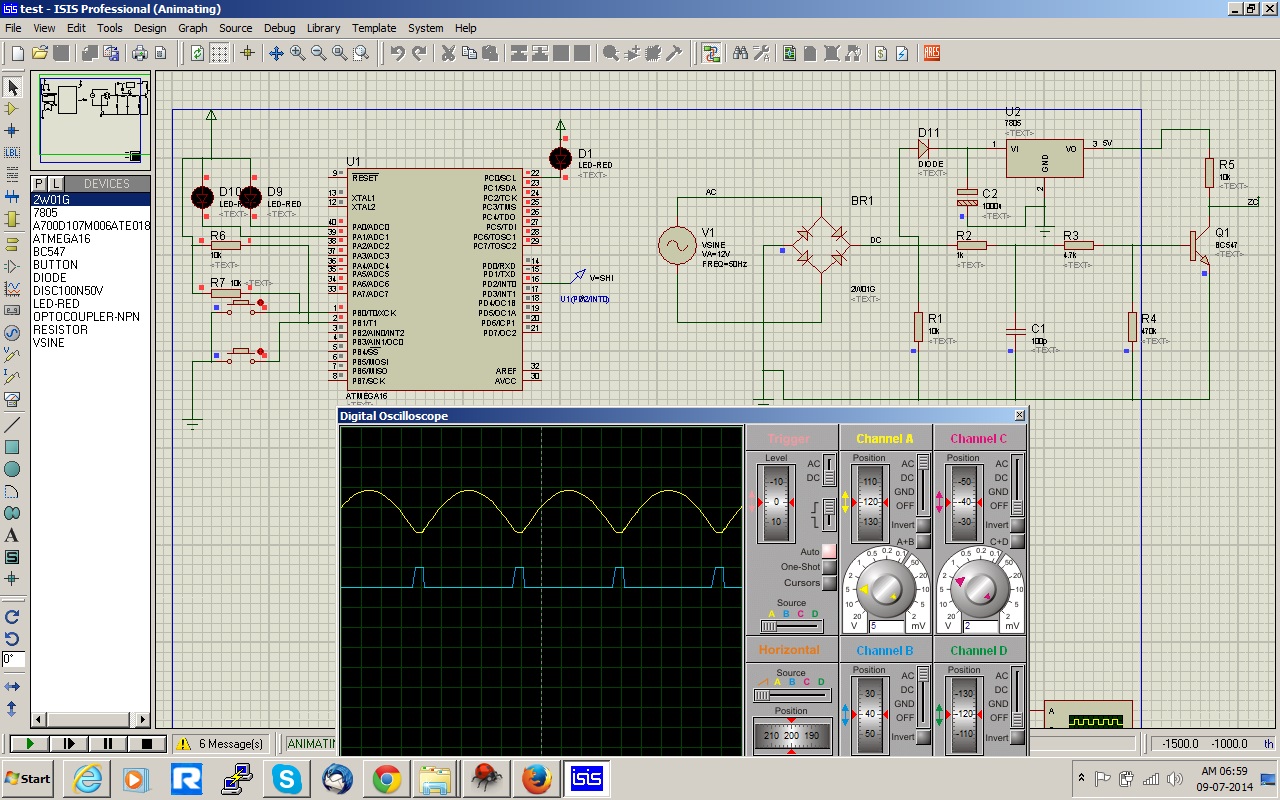

I am working on AC dimmer circuit , for that i have have interfaced the Zero Cross Detection circuit with ATmega16 INT0 pin. INT0 is configured as a rising edge. here i am attaching image which shows the working of Zero cross detection is good. but when i interface its output with ATmega INT0 pin, the Zero Cross Pulsed gets down and nothing happen on INT0 pin. i have tested INT0 code separately which also working as expected. I am not getting where i am doing anything wrong? please somebody help me who has worked with such project ever before
Here is a code snip which gives INT0 routine and Int0 Configuration as rising edge.
When i use this Zero Cross Detection pulses as a normal switch its working good, but when i use it with INT0 pin the pulse get destroyed and nothing happens as attached images
