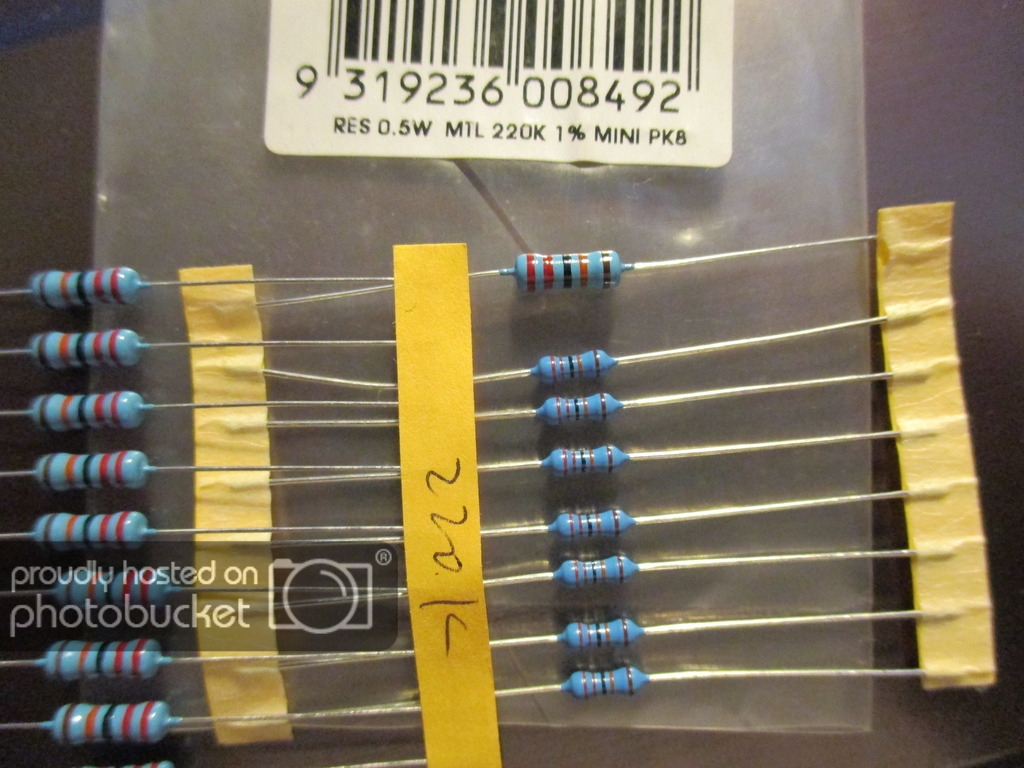

I'm home and I've taken a photo of the 1/4 watt, "Supposed" 1/2 watt and the bigger 1/2 watt and I've taken a photo next to a ruler and it seems that the 1/4 and the small 1/4 are the same size but I did find the pack that the small 1/2 watt were in and it said it was "mini" could that be the reason it's so small?

thermal resistance in the way. So, given two resistors of the same physical dimensions, one rated 1/4 watt and the other 1/2 watt (and labeled "mini") there are several options. The most obvious one is the label "mini" is meaningless as far as power dissipation is concerned. It could just means smaller than regular size. Then, along with the small size, come limitations on power dissipation that are probably comparable or identical to the resistor identified as 1/4 watt. In other words, both resistors, despite the labeling and hype, are both 1/4 watt resistors.
There is a second possibility. The 1/2 watt resistor in a 1/4 watt-sized package may be of high-temperature construction, designed to run hotter without failing, changing resistance, or other undesirable characteristics. A lot depends on material selection. But one thing is certain: the "mini" resistor will run a LOT hotter with 1/2 watt dissipation than the 1/4 watt resistor with 1/4 watt dissipation. This is simple thermodynamics. There is the same surface area from which to dissipate heat (usually by air convection) but twice the power to dissipate. Ergo, hotter resistor with 1/2 watt dissipation, no matter what it says on the package.
