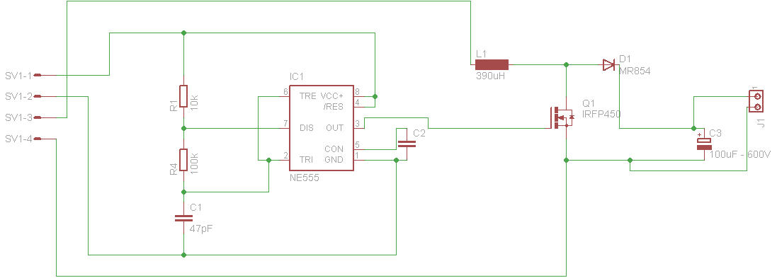

hi guys, goes as follows...
i have 4 x 150watt solar panels (600watts) each of 16v and 8,41 Ampere max (those at best conditions, but i can expect 400/500watts)
and i need a circuit (at least 90% efficiency) to charge the 16kW battery of my electric car with the solar panels,
the battery is 330v @ 50Ah with 400v charging voltage, i only need 400v @ 1Amp or 1.5 Amp at the output (400 / 500 Watt)
(50Ah / 1A = 50 Hours needed to charge from completely empty to full)
i found this schematic that will boost 12v to 400v, but the IRF450 only can handle with 15Amps,
so im thinking in using 2 sets of 2 panels in series, and those 2 sets then connected in parallel to have around 24/32v 15Ampere input
what modification do i need to do to this circuit so it can provide stable 400 v at the output,
independent of the load and independent of input voltage (since the panels vary voltage from 12 to 16 depending on the current amps demand)
i suppose i need a voltage divider from the output diode to the 555 chip, but not sure where to connect i
