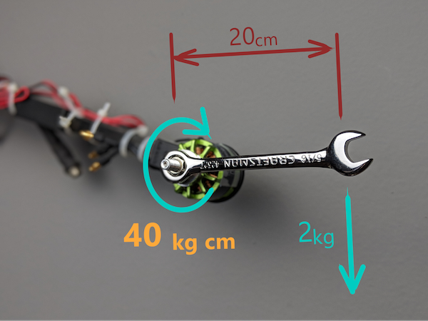

Torque is calculated by multiplying a linear force and the distance that force is exerted from the center of rotation. The classic example of torque is a wrench being used on a nut. If you have a wrench that is 20 cm long, and you push down on the wrench with 2 kg of force, the torque on the nut is (20 cm x 2 kg =) 40 kgᐧcm.
A classic example of torque is seen when you use a wrench to affix a nut.

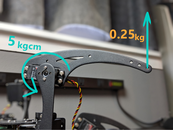

When we look at motors, the calculation for torque is the same—a force multiplied by a distance.
The only difference is that, unlike with a wrench where a force is applied to the arm, with a motor, torque is directly applied at the center of rotation, producing a linear force at the end of the arm. When thinking about a motor’s torque, you could imagine the motor using an arm to lift a weight. The maximum weight the motor is able to lift will be its maximum torque.
torque explanation using a motor
In motors, torque is applied at the center of rotation to produce a linear force.
Motors that are designed to deliver greater torque are able to exert greater forces on other objects.

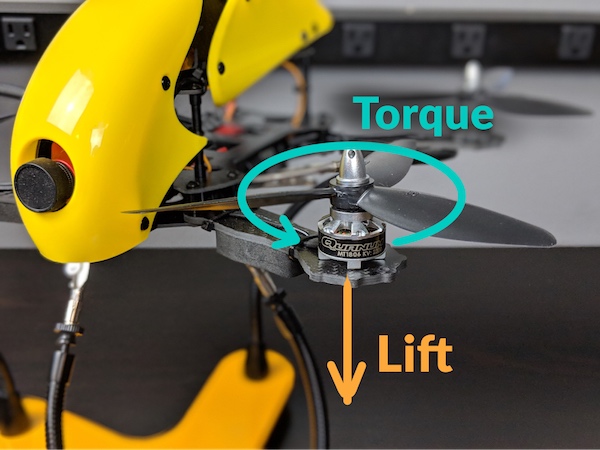

For aircraft, the torque delivered by the motors directly determines the maximum lift the propellers can generate.

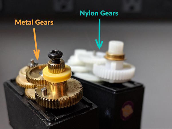

The first is the mechanical properties of the materials involved. Different servo models are a good example of this design consideration.
Cheaper, lower torque servos use plastic gears, usually made from nylon. Plastic gears are inexpensive to produce, making servos with nylon gears cheaper to manufacture and cheaper to buy. Nylon gears are also lightweight compared to metal, which is an important consideration for robotics or aircraft. However, if too much torque is exerted on these nylon gears, they will break.
Servos with higher torque ratings have metal gears so they can deliver higher torque without breaking. The materials used in a motor's construction play a huge role in determining how much torque the motor is able to deliver.
Motors are made with a variety of materials, but generally, those made with metal have a higher torque rating than those made of nylon or another plastic.

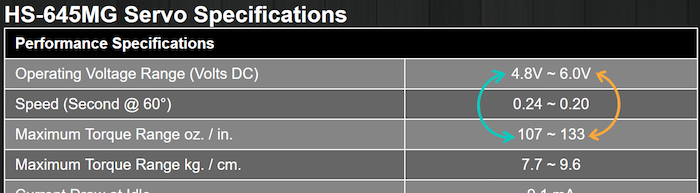

The second factor affecting a motor's maximum torque is the maximum voltage the motor is designed to accept. If you take a look at any servo specs page, you will find different torque ratings for different voltages. Higher voltages give the motor more power to deliver higher torque. However, the motor, and it's driving circuitry, can only accept so much voltage before overheating and burning out. The maximum voltage the motor can accept without failing factors into its maximum torque rating.
motor maximum voltage relating to torque
A motor's maximum voltage is given in the specs provided by manufacturers.
