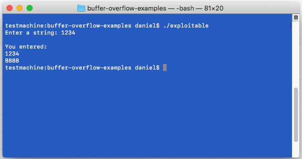

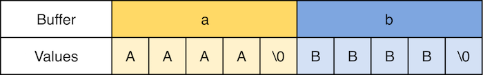

The following example demonstrates what a vulnerable program looks like. In the application, two buffers, a and b, are created. Both have a fixed size of five characters. Because these buffers represent strings, the last character is a null-byte and the buffer’s effective size is, therefore, four bytes:
bufferoverflow_example_fixed program
This example contains two buffers with four bytes each.
The program then prompts the user to enter a string. When the user hits the enter key, the entered string gets written to a and the contents of both buffers get printed to the console:

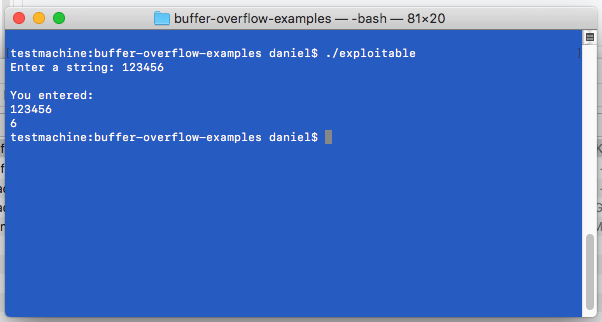

As you can see, when a user enters four characters (1, 2, 3, 4 in this case), the program behaves as it should. However, if more than five characters get entered, this is what happens:
entering a string of five or more characters
Entering more than five characters shows the program's vulnerability.

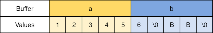

Buffer a now seems to be six characters long while b seems to contain only one character. However, what they seem to contain is not what they actually contain. Both buffers are still four characters long, but the value of b — or at least the first two bytes — got overwritten:
buffer b overflowed
Entering more than four characters causes buffer a to overflow and buffer b to overwrite.
As you can see, the string-terminator is missing in a. Instead, it got stored in b after the first character. More importantly, buffer b was overwritten because buffer a overflowed. Furthermore, the application now behaves unpredictably.

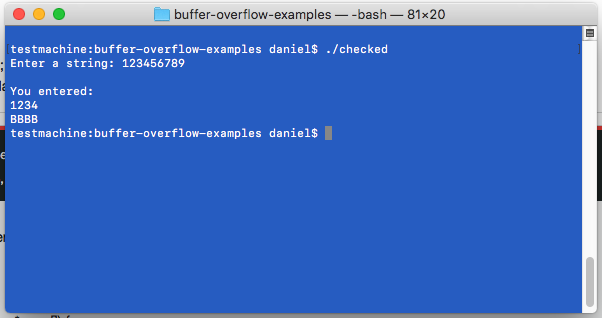

Those mechanisms, however, won’t protect your code from crashing when a user enters a malformed input string. An effective and simple countermeasure is to always check input values. Furthermore, avoid using functions like strcpy. Instead, use their length-limited version (for example strncpy). The vulnerability described in the example above can be fixed by using fgets instead of scanf:
use fgets to avoid buffer overflow
Using fgets instead of scanf helps prevent buffer overflow in our example.
Pay close attention when checking for boundaries and make sure you stop at the correct length. As shown above, strings need a terminator and you can, therefore, not utilize the entire buffer.
