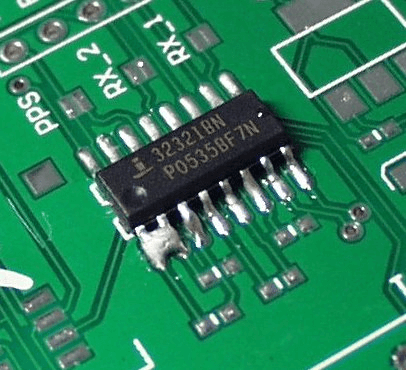

Furthermore, you should inspect the solder connections on the board. Make sure that all pins are connected, and there aren’t any bridges where they aren’t supposed to be.
Solder bridges create an electrical short capable of causing the entire design to malfunction. Image credit: Sparkfun.
You can use the continuity function of a multimeter to test for broken traces and shorts. Lifted pads and solder bridges can be found by visually inspecting the PCB.

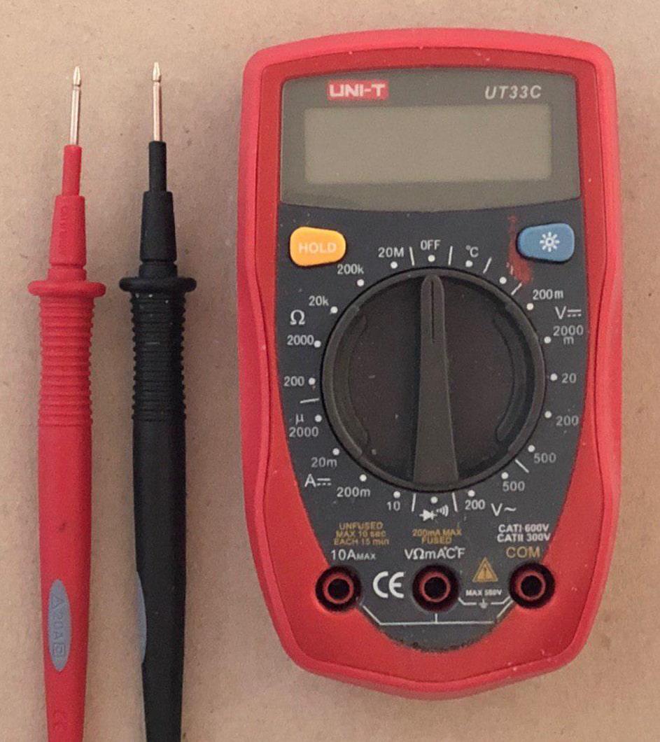

Once you visually inspected the board to make sure that all the traces and pads are intact, it’s time to use a voltmeter to check whether the components in your circuit are supplied with the right voltage.
Start by measuring the input voltage and then the supply voltage of each component. Make sure that each part is supplied with the correct voltage. If it isn’t, check whether the GND pin of that component is correctly connected with a continuity tester.
You can also try to measure the current the circuit draws. If the measured value greatly differs from what you expect, something is likely wrong. This could indicate that one or more components are broken, something has shorted out, or that you have one or more broken traces on your PCB.
A multimeter is a handy tool to have when troubleshooting various types of circuits.

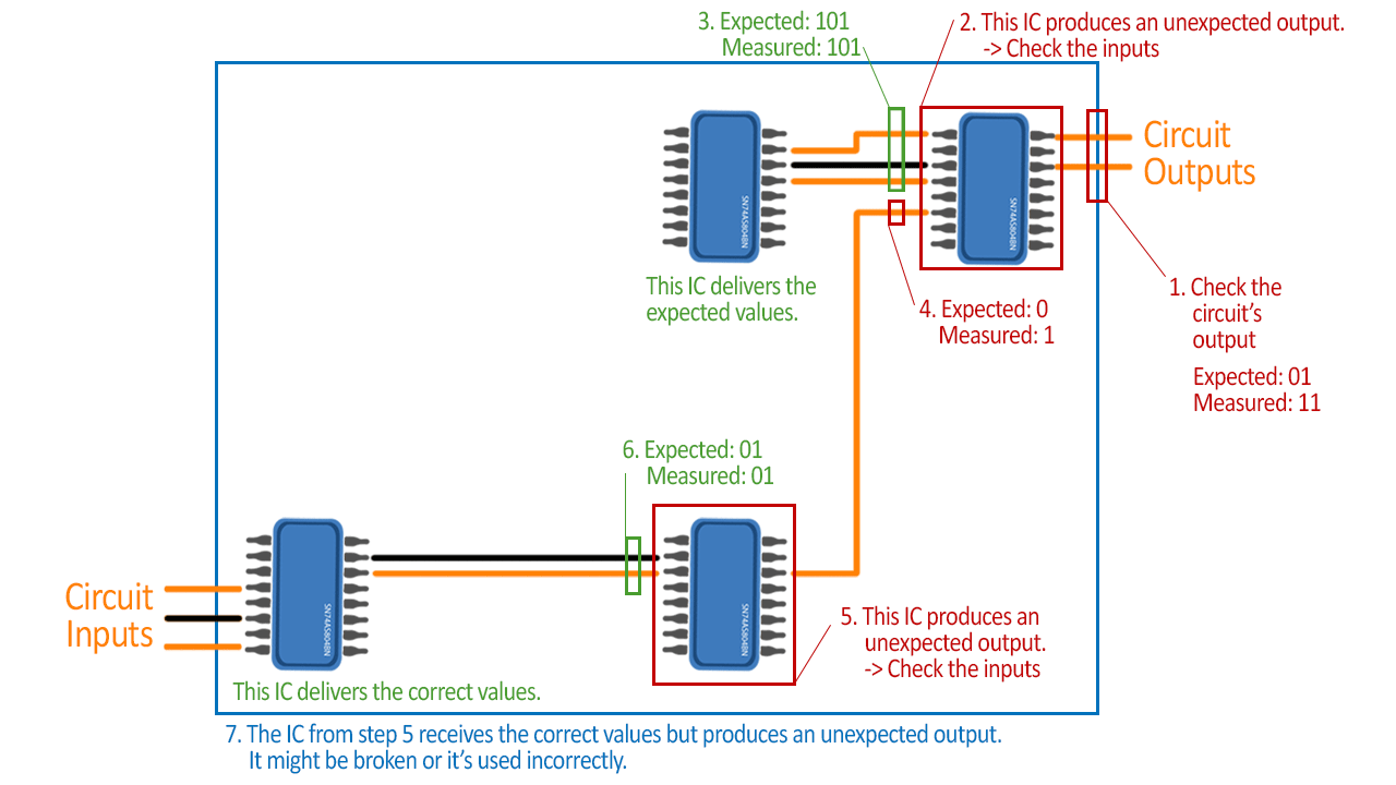

Make sure to inspect every signal of the circuit. I prefer to start at the output of the circuit itself. If it's correct, then you’re done. Otherwise, you have to take a look at the input pins of the device that produces the output.
Check whether the input signals are what you expect them to be. If they are, then the device itself might be broken (or is being used incorrectly). If the inputs are incorrect, look at the next device in the chain (the one that produced the incorrect signal). Repeat these steps until you find the point of failure.
