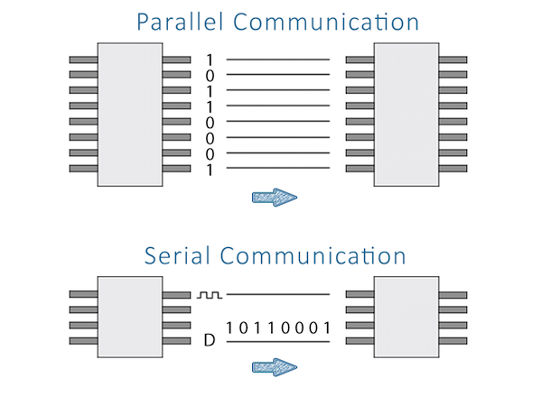

There are two different methods of communicating over wires: serial and parallel. While each requires its own respective protocol, parallel communication is easier to realize because timing — while still being relevant — is not critical for successful transmission.
When you read values from a RAM chip, for example, you’ll most likely have to supply the address bits all at once and the RAM’s data lines will contain the information you requested. Each bit has its own line and the transmission works in parallel.
In comparison, many EEPROM chips communicate over a single data line via a serial interface and the data has to be sent one bit at a time in a strict time frame:
parallel and serial communications
