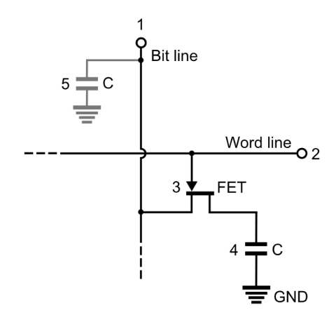

Dynamic Random Access Memory (DRAM)
DRAM uses capacitors to store each bit of data within an integrated circuit. The capacitors can either be charged or discharged to represent the two states of a binary digit:
Internal Circuitry of DRAM
The capacitors will discharge over time and therefore lose the stored values if they are not refreshed periodically. This is done by a memory refresh circuit that’s responsible for rewriting the data in the capacitors. Furthermore, dynamic RAM is more complicated to use as it requires more precise timings than SRAM.
However, this simple design allows the RAM chips to be small and therefore this type of memory is mainly used in modern computers, smartphones, game consoles, and typically everywhere else, where large amounts of relatively cheap memory are needed in a small package.

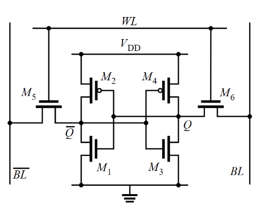

Static Random Access Memory (SRAM)
SRAM, in contrast to DRAM, stores the information with transistors instead of capacitors:
Internal Circuits with Transistors in SRAM
This type of memory is more complicated, larger, and more expensive than DRAM. However, it’s also faster and doesn’t need to be periodically refreshed. Furthermore, it uses less power than DRAM. These positive properties make SRAM perfect for when you need smaller amounts of fast memory, for example as local caches in a CPU.
