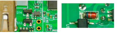

Through-hole Glass Diodes
Through-hole signal diodes with a glass housing are the most common diode type. They include a band that identifies the cathode (negative lead).
The glass structure comes with the diode type printed on it.
Example: A common diode is the 1N4148.
These diodes are common, but not worth salvaging. They are also fragile because of their glass structure and require careful handling.
Through-hole glass diodes are easily mistaken for Zener diodes, which are also available in a glass housing; but they can be distinguished by the reverse voltage printed on the Zener casing.
Glass diodes on various PCBs, a glass diode and it's anode/cathode. Images courtesy of Omegatron [CC BY-SA 3.0]

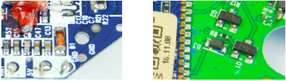

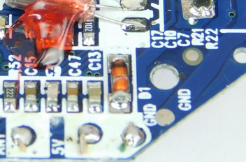

SMD Zener Diodes
SMD zener diodes are available in a range of packages; one of the more popular includes three pins.
The use of three pin packages ensures that the diode is inserted correctly (a three pin SOT-23 part can only be inserted one way).
zener diodes are also available in glass housing with plastic pin parts. The glass structure identifies the cathode with a thick blue band and the plastic varieties have a thick line beside the cathode.
Three pin zener diodes and a glass SMD zener diode.

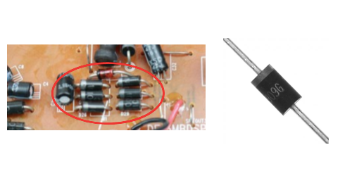

Through-hole Schottky Diodes
Most through-hole Schottky diodes are housed in a black plastic cylinder with a single silver ring that indicates the cathode.
These diodes can range in size, but are almost always much larger than signal diodes (one of the common ones being the 1N5817).
Through-hole Schottky diodes have their part number printed on the outside of the cylinder body and are easy to spot on a PCB.
Schottky diodes attached to a radio and a standalone Schottky Diode.

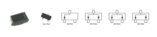

SMD Schottky diodes, like other diodes, come in many different packages, but unlike Zener diodes, some Schottky packages have more than one.
Two pin packages often have a thick bar next to the cathode and a part identifier; three pin packages only have a part number.
The BAT54 range of Schottky diodes are the well known SMD diodes, as they contain two diodes in different configurations for ESD protection.
For example, if a circuit needs to connect to an external device that may experience ESD, then the BAT54 is used to protect both digital and analog connections that are linked to a microcontroller or IC.

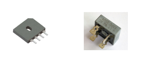

Full-Wave Rectifiers
Full wave rectifiers are diode packages that combine four diodes in a full-wave bridge rectifier arrangement.
These packages are often more convenient than other diodes as they combine all components in one package and are available in both through-hole and SMD.
Through-hole Rectifier Diodes
Through-hole rectifier diodes range in size and their size typically corresponds with their power capability.
Small rectifiers are not much larger than TO-92 transistors and are cylindrical in shape. Large rectifiers have big, thin, rectangular houses with thick legs.
Sometimes, rectifiers have metal backs that allow them to be directly mounted to heat sinks.
They are mainly AC/DC conversion in power supplies. They aren’t the most valuable component to salvage otherwise.
Through-hole rectifiers often have printed part numbers and a pin indication such as positive (+), negative (-), and AC input (~).

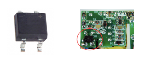

SMD Rectifiers are easy to spot. They are square in shape and have markings next to each pin that indicates their function (positive +, negative -, and AC input ~).
These parts, like other SMD parts, are not worth salvaging, as they are difficult to use in projects, require SMD soldering, and have limited applications.
SMD rectifiers are also inexpensive and easier to purchase as new parts rather than using older components.
An SMD rectifier and an example of one on a PCB. Image courtesy of Digi-Key.
