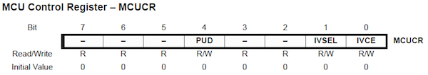

The Atmega168 has a bootloader area of memory that allows it to re-write its own program memory on the fly, which can be useful for firmware updates. Therefore, where the ISR vector table will sit in memory is important. If the table sits in the bootloader area, it can never be updated (not recommended) if the bootloader is enabled.
Therefore, if there is no bootloader, you should put the vector table at the bottom of memory (near address 0x0000), but if you use the bootloader then you should move the vector table above the bootloader. This can easily be done by changing several bits in the MCUCR Register.
- If IVSEL = 0 then ISR is at the start of vector table else ISR resides in the bootloader. For now, leave this at 0 since we are not using the bootloader
- If IVCE = 1 then the ISR switchover is performed. Leave this at 0 for now

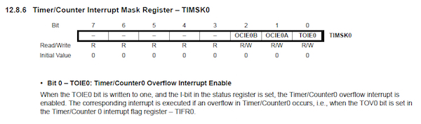

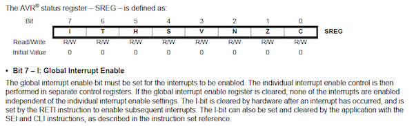

Each interrupt source (I/O pin, peripheral, etc.) has an associated interrupt enable bit. Like the PIC, there is a global interrupt enable bit found in the STATUS register, which needs to be set to allow interrupts to work. To find out where these interrupt flags reside, you need to consult the specific peripheral chapter on the datasheet.
For example, we will be using the overflow interrupt on timer 0, so if we look at the timer 0 chapter, we find that the interrupt enable bit is found in register TIMSK0 (page 89), and is called TOIE0. This bit needs to be set to 1 for the timer overflow to fire. This register also has two other interrupt sources, overflow on A match and overflow on B match, which can be useful for PWM functions (this will be covered in the future).
Note, setting the I bit in the SREG is not done using the SREG itself, instead, use the function sei(); to set the I bit and cei(); to clear the I bit.
