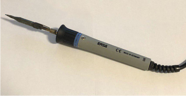

To allow a clean, easy solder with thick wires and large components on PCBs, you need to make sure to get a soldering iron with enough power. However, I don’t recommend getting the most powerful iron either, especially if the power can’t be regulated manually. Otherwise, you run the risk of destroying delicate components.
Your soldering iron should also have a changeable tip.
A soldering iron.
You can, of course, get a soldering station, too. Personally, I’ve never really found them particularly useful because they feel less versatile. You’ll have to decide for yourself which type you prefer.
It’s important to note that you don’t have to get the most expensive soldering iron, especially if you’re a beginner. However, I definitely can’t recommend getting the cheapest one either. For a good soldering iron, expect to pay at least around 35 to 50 dollars.

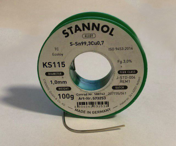

Getting the Right Solder
For beginners, the solder you choose won’t make a huge difference. However, you should try to find a lead-free one and, like the soldering iron, don’t try to get the cheapest product you can find. Cheap solder usually performs poorly, making the job unnecessarily hard, especially for beginners.
An example of solder material. Try to find lead-free solder.

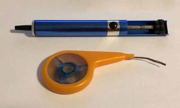

You can get a desoldering pump to help you remove parts from PCBs. Solder wick essentially serves the same purpose. However, both of these are optional. As a rule of thumb, you should get a pump for desoldering through-hole components and solder wick for SMT chips.

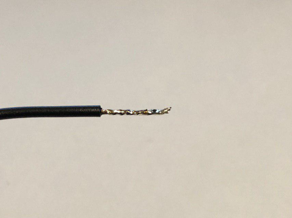

Wire tinning is the process of melting solder around the strands of wire to make it more robust and easier to work with. It’s a very simple technique that you’ll often use in projects and it’s a great way to practice soldering.

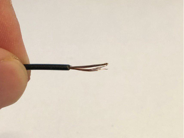

To begin, Grab the wire you want to tin and strip off the insulation.
Strip the insulation off of your wire.

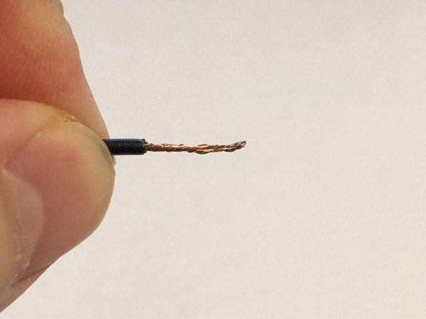

Then hold onto the uninsulated part of the wire and twist the individual strands together so that they form a thicker metal core.
Twist the wire strands together.
Use the soldering iron to heat up the bare metal of the wire for about ten to twenty seconds.
NOTE: The necessary time for heating the wire varies depending on the soldering iron you use and the thickness of the wire.
Apply some solder to the heated part of the wire until it melts.
Apply solder to the heated wire.
Make sure to heat the wire from underneath and add the solder from the top. That way, gravity helps the solder flow. It will melt and fill in the voids between the wire’s individual strands.

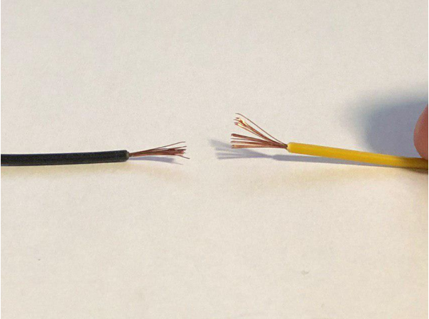

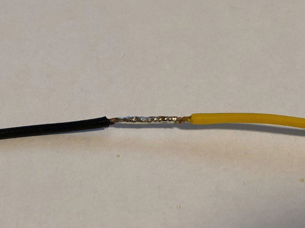

Connecting two wires works almost the same as tinning a single wire. Start by removing about a half-inch of the insulation on both of the wires you want to join.
Remove the insulation on both wires you want to join.

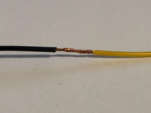

Then connect the two wires by gently weaving their individual strands together. This will hold them in place and give the solder a good structure to flow into.
Gently weave the wire strands together.
Then, just like with wire tinning, heat the bare metal part up for a few seconds and apply a little bit of solder until it melts and gets pulled into the strands of the wires.
Apply solder to the heated wires.
Whenever you connect two wires, you should consider adding a bit of heat-shrink tubing to one of the two wires before adding the solder. Once you’re done, heat the tube up for a few seconds until it shrinks. This replaces the missing insulation. The following video illustrates the entire process.

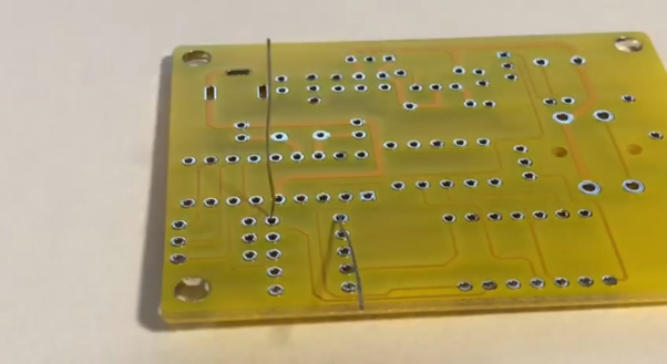

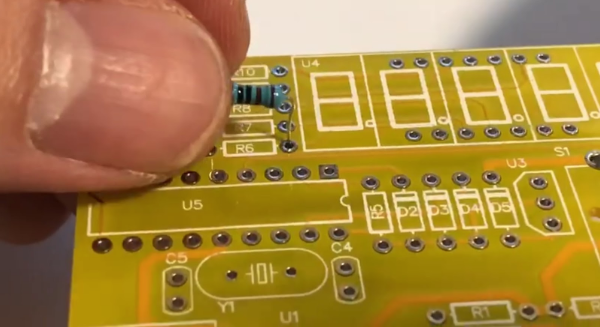

Start by bending the pins of the part you want to solder so that they fit through the intended holes on the PCB.
Bend the pins of the component to get them to fit through the PCB’s holes.
Turn around the PCB and bend one leg of the component, if you want to, to make it stay in place:
Bend one pin of the component so it stays in place.

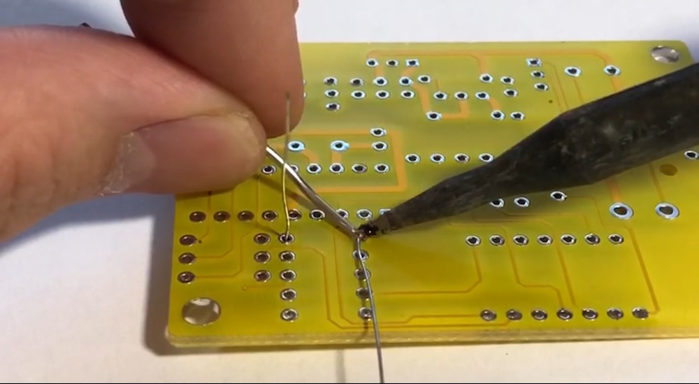

Heat up one leg and the pad on the PCB simultaneously for about one to two seconds. Then bring in the solder. It should immediately melt and flow onto the pad and the pin of the part.
Heat the pin of the component and then add solder.

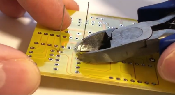

When you’re done, let the part cool down for a few seconds and bend the legs of the part back up and cut them off.
Let the solder cool, then snip the pin.

  • When soldering components, don’t trim their legs off too close to the board because the solder joint might crack.
