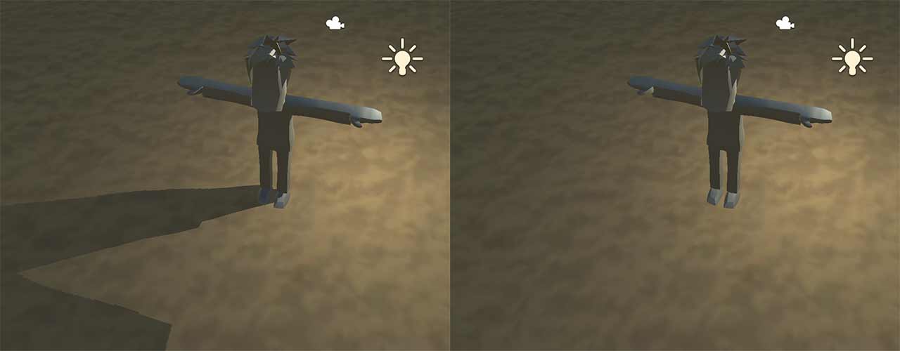

Light and shadow are very important. They are used to give perspective to a scene. The lack of shadow will make a scene look fake. The picture below shows the difference. If there is no shadow, you can't really tell if the man is standing on the plane or floating in the air.
You can see the difference in 3D above, and so it will definitely be the same in Augmented Reality as well. This article will guide you on how to be render light and shadow with Unity and Vuforia SDK (here is a beginners guide to Vuforia, if you are unfamiliar) for Augmented Reality applications. The idea behind this should also work on other SDK or game engines.

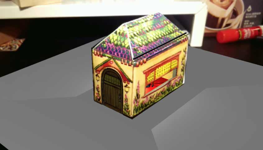

In Unity, if you want to render light or shadow, there has to be a mesh. But if we add a mesh on, we can't see the camera's view. As you can see in the picture below, with the gray plane I can't see the desk's surface.

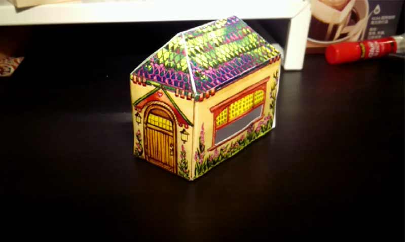

So I separate everything into three layers—background, light and shadow, and 3D object layer—and then mix them together. Here is the background layer, which is just the camera's image:

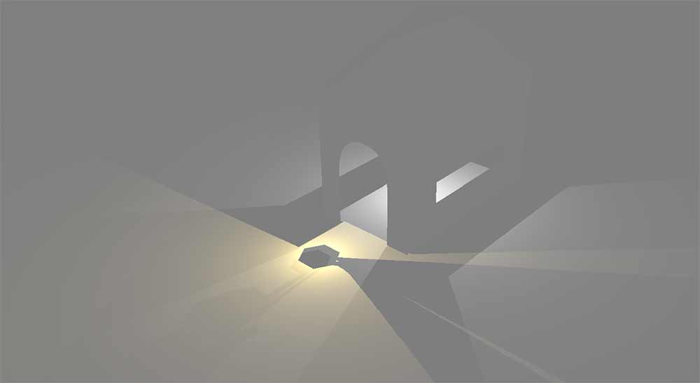

This is the light and shadow layer:

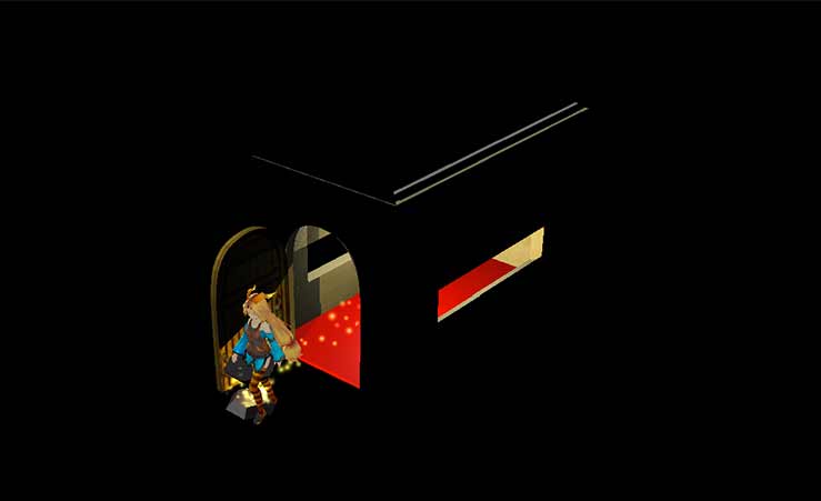

And the 3D object layer:

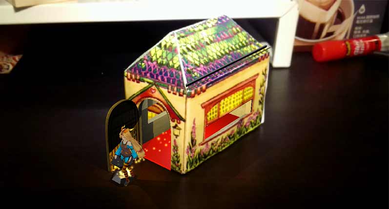

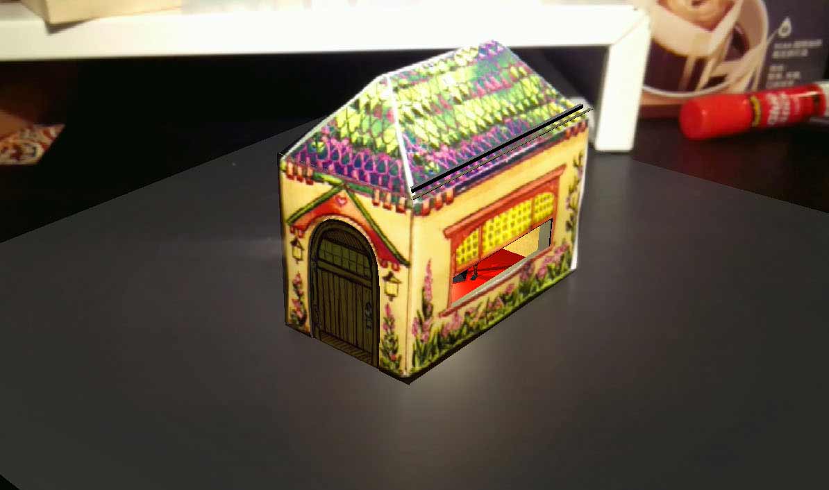

The final result with all 3 layers:
In the image above, the desk is so dark, you can't see the shadow properly. But you can check this demo video to see better:
