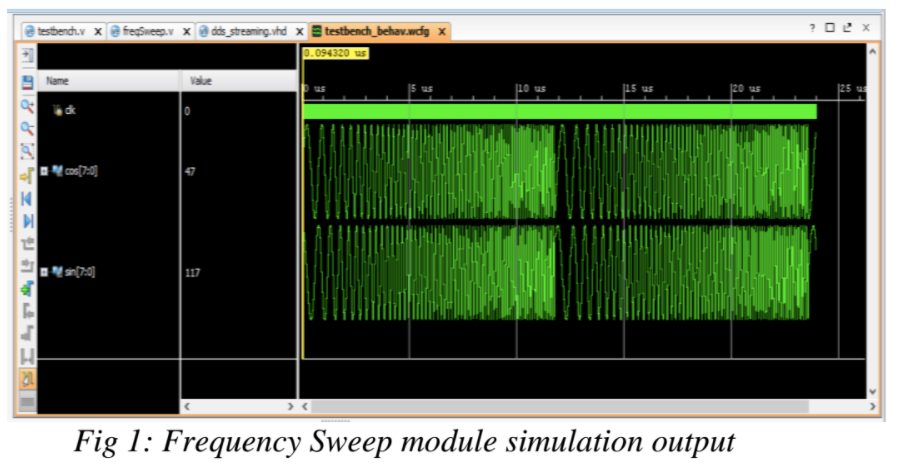

Output
Since the mode of operation used is the standard mode, the output obtained is close to the precise output.
Conclusion
This method is implemented to give a frequency sweep waveform, which is used to test various digital filters. This frequency sweep is a chirp waveform with an increase in frequency from 1MHz to 10 MHz, all n a timespan of 10us.
