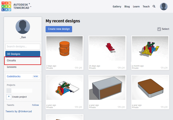

To get started, visit Tinkercad's website and create an account or log into an existing one. Then select “Circuits” on the left side of the screen:
tinkercad homepage
After logging in to Tinkercad, click on "Circuits" on the left-hand side.

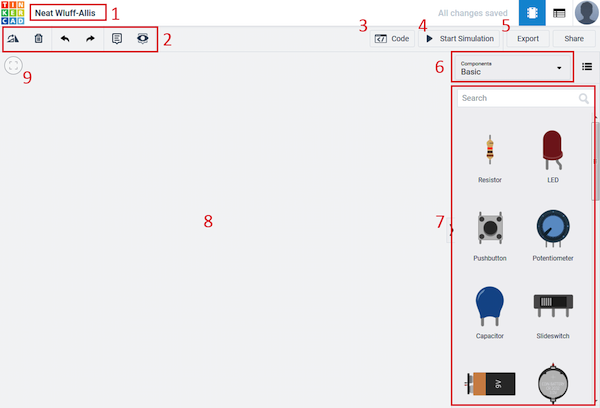

Select “Create new Circuit” on the next page and you’ll be greeted with the following screen:
create new circuit homepage in Tinkercad
The "Create New Circuit" homepage in Tinkercad.
To familiarize yourself with the circuit design homepage, let's go over the areas I've marked with numbers:
  1. Change the name of your design here
  2. This is the main toolbar. From the left to the right: Rotate the selected part clockwise, delete the selected part, undo and redo your last action(s), create annotations and toggle their visibility.
  3. Some parts allow you to change their program. Click here to do so.
  4. Start the simulation
  5. Export your design to Autodesk EAGLE.
  6. Choose the parts to display in the list below. I recommend choosing “All”.
  7. These are the parts you can use.
  8. The main work area. Drag and drop parts here to add them to your design.
  9. Fit everything into the view.
The camera can be moved by holding down any mouse button and moving your mouse without hovering a part.

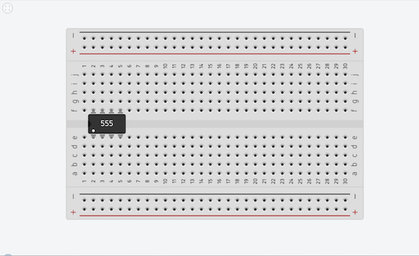

Start by dragging a breadboard into your design and place a 555-timer IC on it:
add 555 timer to Tinkercad design
Start by adding the 555 timer IC to your design.

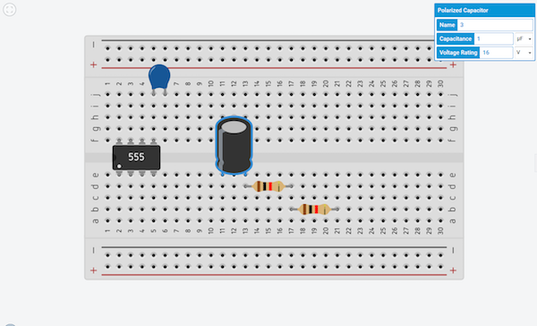

Proceed by adding the other components including:
  • Two 1K resistors
  • One 0.01 micro Farad capacitor
  • One polarized capacitor with a capacitance of 1 microFarad
You can enter the values of each part after placing them or by clicking on a part:
add additional components to circuit design
Add the additional components to the circuit design.
**Hint: You can use the R-key to rotate a selected part clockwise.

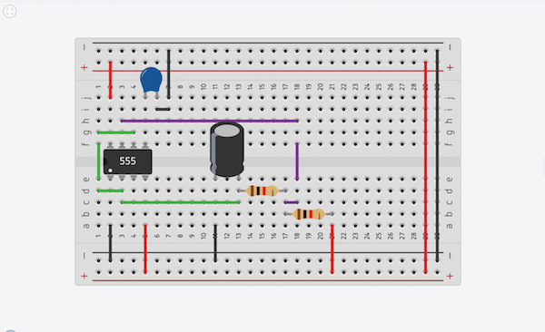

Now it’s time to connect the parts. Click anywhere to start a new connection. Click again to create an endpoint. You can change the color of the wire afterward. Connect the parts to create a simple clock:
Add the connections between components
Add connections between the components.

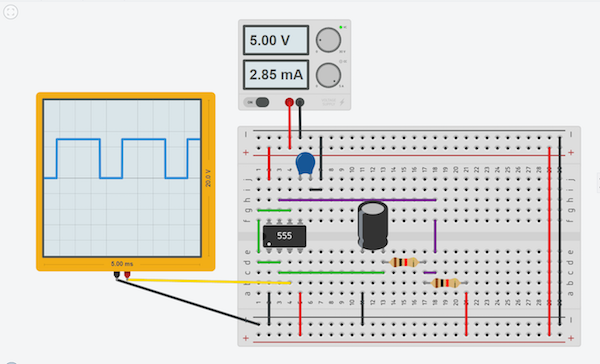

You can add a voltage source and an oscilloscope to test your circuit. Hit “Start simulation” to check your design:
test your circuit with the online voltage source and oscilloscope
Add a voltage source and oscilloscope to test the circuit.
You can change the oscilloscope’s settings by clicking on it.

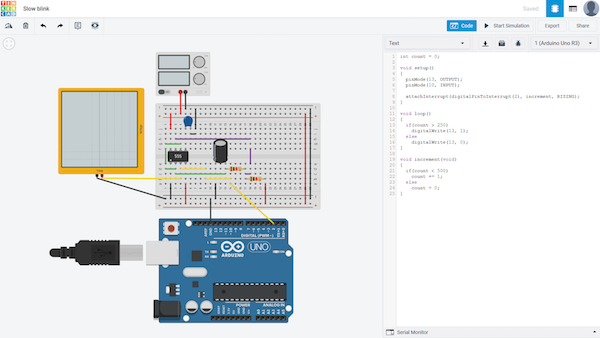

Now that the clock is functional, let’s connect it to an Arduino and write some code. Add an Arduino to your design and connect the timer’s pin three to pin two of the Arduino.
Don’t forget to connect the ground of the Arduino to the one on the breadboard. When you are done, click the “Code” button in the top menu bar:
Click the "code" button to begin programming your build.
The code window will show the “blocks” editor by default. I changed it to text only by clicking the dropdown-list and selecting text. Enter the example program code (found below) and start the simulation. The LED on the Arduino should blink slowly.

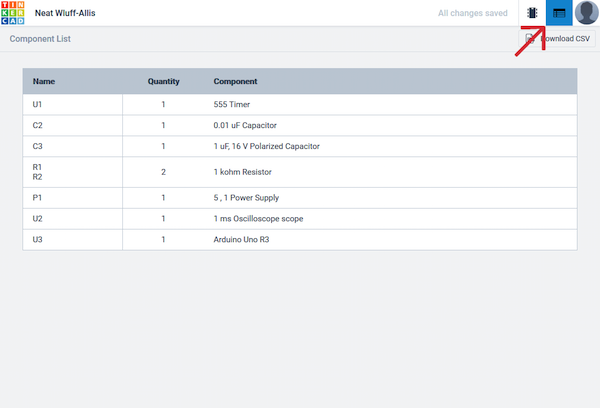

After you are done, you can export your work to Autodesk EAGLE to create a PCB design or you can generate a list of the necessary components and then build it. To display the list, click the button next to your profile picture:
export list by clicking icon next to your profile picture
Export your list by clicking the icon next to your profile picture.
