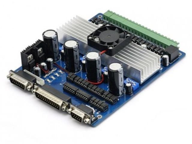

A generic TB6560 CNC axis stepper. Image courtesy of Amazon.
I have owned several CNC controllers (all unbranded Chinese models) that are powered by TB6560 stepper controller ICs. Despite having checked the CNC machine itself and the computer, the CNC would miss enough steps to result in PCB traces being too thin. Not only did all the controllers miss steps, they would eventually break down, and either go off with a bang or just not work at all.
After owning the third controller, it was obvious that the problem had to be with the controllers themselves. After inspecting the controllers (yes, I kept them all despite all being broken), and doing some research online, it became apparent that whoever designed the controllers was either incompetent or was intentionally being cheap (more on this later).

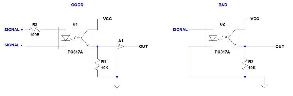

Opto-Isolators and Long Rise/Fall Times
When looking at digital signals, it is important that they conform to timing requirements by the receiver (the device receiving the digital signal), and contain as little noise as possible. The TB6560 controllers all used opto-isolators to isolate the parallel port from the CNC controller, so the parallel port would not be damaged by voltage spikes and accidents.
However, the opto-isolators had a very long fall time, which violated the maximum rise/fall time for the step input. This results in the TB6560 missing steps, as it cannot fully recognize the step pulses, and so this needs to be changed.
The solution involves connecting the output of the opto-isolators to Schmitt-triggered buffers (such as the 74HC14 or 40106) as this will produce sharp transitions when the output of the opto-isolator crosses the voltage thresholds of the Schmitt trigger.
But there was an even bigger problem with the opto-isolators: They were not even isolating!
The role of an isolator is to electrically isolate two circuits from each other. However, the designers made the ground on the controller common to the ground on the parallel port by connecting the grounds on both sides of the isolator together. This means that the parallel port is still susceptible to noise spikes and large EMFs that can potentially be generated by the controller.
Fixing this issue is next to impossible, as all of the electronics are integrated onto a single PCB; therefore, the best solution is to just bypass the opto-isolators entirely or design a custom parallel port isolator that sits between the controller and PC.

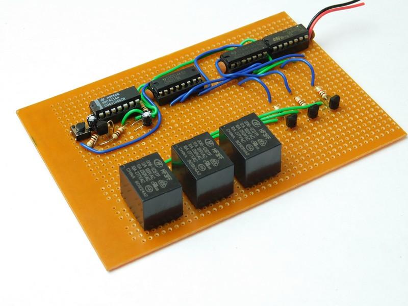

Many components use a single rail supply (such as the 4000 series), but there are some that have multiple supply rails. The TB6560 has two separate power supply pins: one is for the internal logic and control, while the other is for the stepper motors. The Chinese controllers will typically have a single input voltage supply ranged between 12V and 48V, which is then regulated down to 5V. This 5V is used to power the TB6560’s internal logic, while the 12-48V input is connected to the TB6560’s motor power supply. However, this is dangerous, and every time the circuit is powered, there is a chance that the TB6560 will break. This is because the TB6560 has a specific power-on sequence that requires the logic power rail (5V) to be present and stable before the motor power is enabled. Luckily, this is very easy to solve using a previous DIY Hacking/Maker Pro project, the power on sequencer. First, the voltage input to the controller is completely bypassed with the motor supply and 5V rail being identified. These supplies are then connected to the corresponding relay on the power sequencer so when the circuit is turned on, the 5V rail is enabled first, and then the motor supply is enabled afterward.
The Power Sequence DIY project is great for the TB6560

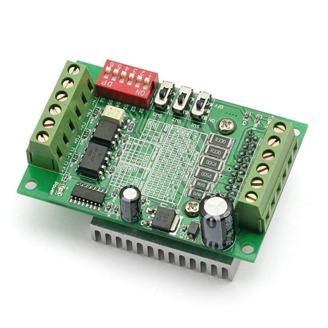

Many TB6560-based CNC controllers require extra components that are missing on the PCB, so these may need to be included (refer to the datasheet to see if they are required).
This PCB is missing quite a few surface mount parts. But is this OK for the design?
