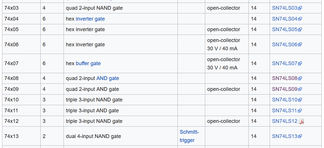

Before I build a complex digital circuit, I always take a look at this table, which lists all official 7400 series ICs, regardless of their current availability.
This list allows me to make sure that the circuit I want to build doesn’t already exist. Many standard functions are already implemented in a single IC, and this way can make sure that you save your time and money.
The list also links an appropriate datasheet for each component, and it describes the most important aspects of each device.

Next, I look at the output of each IC. If you examine the output column of the list mentioned earlier, you’ll find that the majority of devices either have nothing stated, a three-state output, an open-collector, or a driving output. Let me quickly summarize those types.
No Info Supplied
For this table, “No Info Supplied” means that the device has a regular push-pull (totem-pole) output that can be used to drive other 7400 inputs but can not be used to draw a lot of current. Furthermore, you can most likely indirectly connect the outputs of this IC to the outputs of other devices.
Three-state Output
Devices with a three-state (sometimes also called tri-state or Z-state) output have a special high-impedance mode that allows you to connect their outputs to the outputs of other ICs. This is especially useful when you want to build a data-bus that connects multiple devices.
Open-collector Output
An open-collector output in an IC is either connected to ground or it's open, meaning that every output pin of a device, with open-collector outputs, will require external pull-up resistors. Consult the datasheet of the specific device for details.

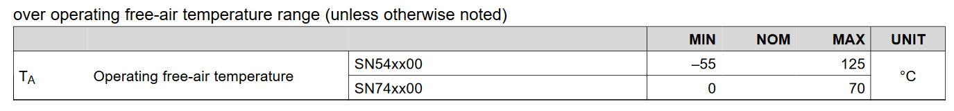

Some areas, like the automotive, medical, and military industry, have specific conditions in which the ICs have to work. If your project also has certain rules that must be met, make sure that all your components are rated appropriately.
Some models of an IC can, for example, only operate between 0° and 70°C, while others work between -55 and 125°C.
