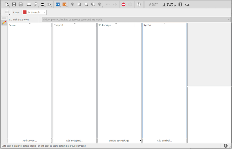

To organize our custom part in the Autodesk EAGLE application, we'll start by selecting 'New' under the 'File' menu, then 'Library' to open up a new window.
A library window in the Autodesk EAGLE software with the 'Symbol' column selected.

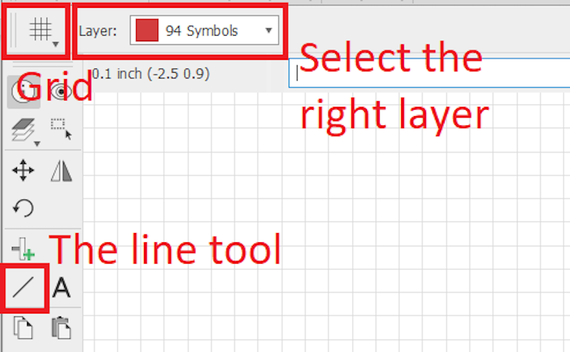

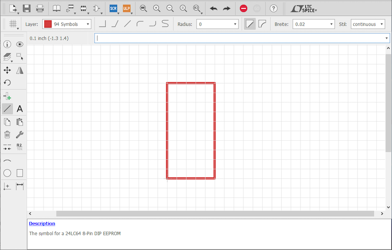

To draw the symbol, start by defining the component's outline. You can do this either manually or entering the coordinates of a rectangle within the command line.
Regardless of the method you use, select the line tool and make sure that 'layer 94' is selected and that your grid is properly configured.
Image highlighting location of layer 94, grid configuration button and the line tool in Autodesk EAGLE software application.
A simple outline of a box drawn in the Autodesk EAGLE software application.

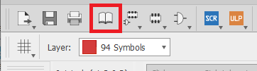

Save the drawing and return to the library window by clicking on the icon shown in the image below.
Image highlighting the location of the button which returns the user to library window in Autodesk EAGLE software application.

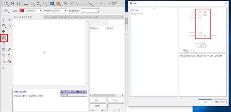

Once in the library editor feature, click "Add Device..." and name it. Now select the "Add part" button in window that opens up.
Image displaying the location of  the "Add Part" and "Add Device" buttons in Autodesk EAGLE software application.
Select the symbol created earlier in this tutorial and place it anywhere in the main panel area. Then select 'New' and 'Add Local Package' on the right side of the window.

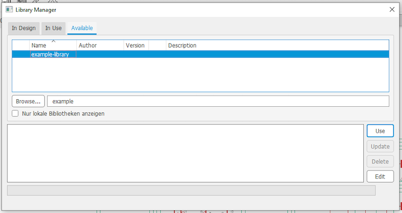

To access your custom part, navigate to libraries, then 'Library Manager' from the main menu bar.
Image displaying Library Manager window in Autodesk software application.
Select your newly created library under the 'Available' tab and click the 'Use' button.
