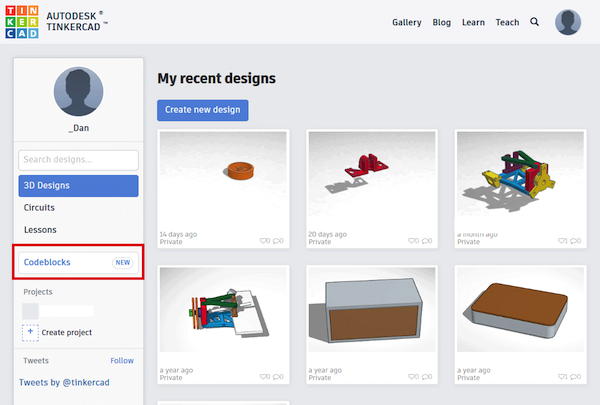

To get started with Codeblocks, visit the Tinkercad website and click the Codeblocks button on the left-hand side of the screen:
codeblocks button on tinkercad user dashboard
The Codeblocks button can be found on the left-hand side of the user dashboard in Tinkercad.

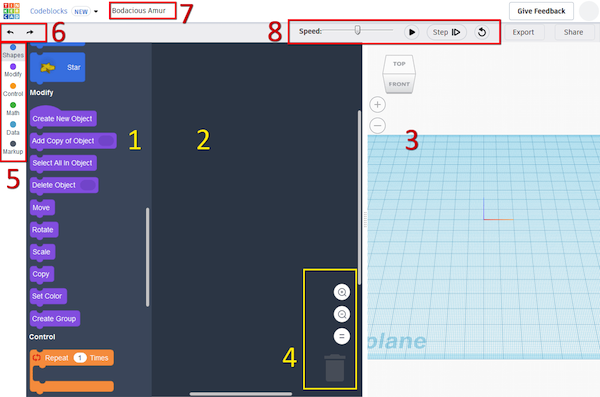

After opening Codeblocks, choose “New design” in the window that pops up. You’ll be greeted with the following screen which is split into three sections:
new design window in codeblocks
The new design window in Codeblocks.
Each number on the image above indicates an important feature in Codeblocks. Here's a reference key:
  1. The code blocks you’ll use to define your program
  2. This is the panel where you will “write” the program. You won’t need to have any knowledge of a programming language to use this tool. The program is defined by combining the code blocks in the same way you would combine building blocks.
  3. When you execute your code, the output gets generated here.
  4. Make the code blocks larger or smaller or reset their size. The trash can is used to remove unwanted blocks.
  5. You can use these buttons to quickly scroll through all available code blocks.
  6. Undo and redo your last steps.
  7. Change the name of your design here.
  8. Execute your program and control its speed.

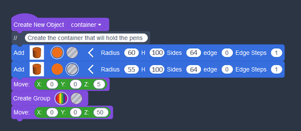

Start by defining the main container by dragging these blocks into the working area:
codeblocks starter project first step
Define your new project with the above blocks.
Add two cylinders. Make the second one define a hole by selecting the grey circle next to the color.
Code blocks will only affect the objects they are attached to. Since the first move-block is connected to the second cylinder, it won’t move the first one! By creating a group, you combine the two cylinders to one object and the next move-block will, therefore, move both.

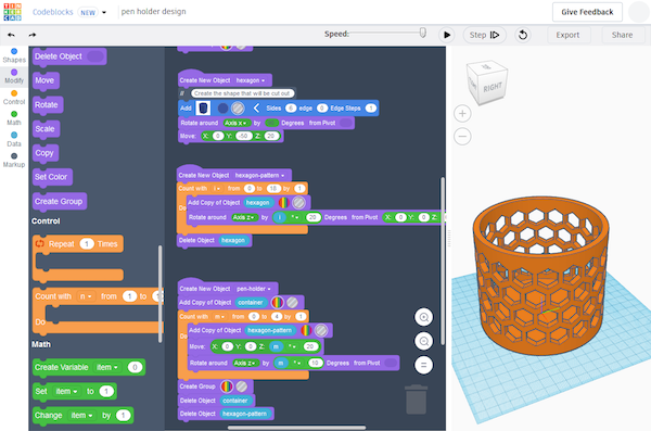

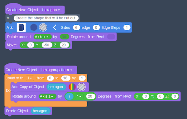

Proceed by generating the shapes that will be cut out:
generating cutout shapes in tinkercad codeblocks
Generate the shapes that will be cut out of the final design.
In the last “Rotate around”-block, nest three blocks within each other: the variable “i” gets multiplied by 20 and the result is fed into the rotate-block.

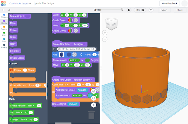

You can run your program at any time. Right now, the output looks like this:
rotate around block in codeblocks
With all the shapes defined, they now need to be combined to create the final product.

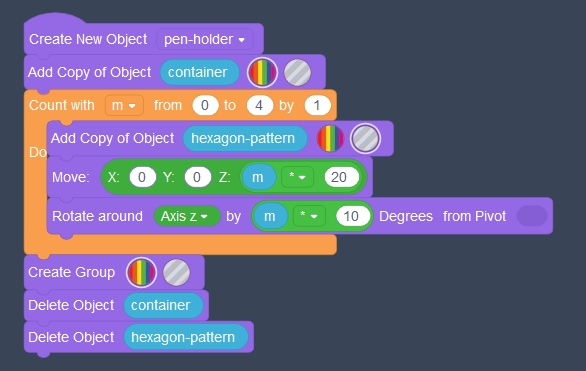

To do this, create a copy of the hexagons and the cylinder. Then duplicate the holes four times and move them up, slightly rotating each line to create a cool effect that covers the entire pen holder.
Duplicate the cutouts to create holes that cover the entire pen holder.
You can see that I deleted the originals in the end. This way it’s possible to group the duplicated shapes without altering the templates. Run the program and watch it generate your pen holder.
