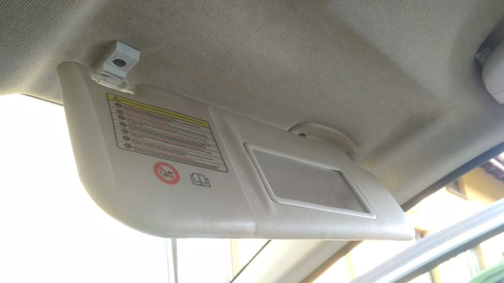

A visor clip in my car has recently broken and I want to show you how I modeled it in SelfCAD.
Look how easy it is when you use SelfCAD - an online 3D modeling application.
Welcome to the next SelfCAD instructable.

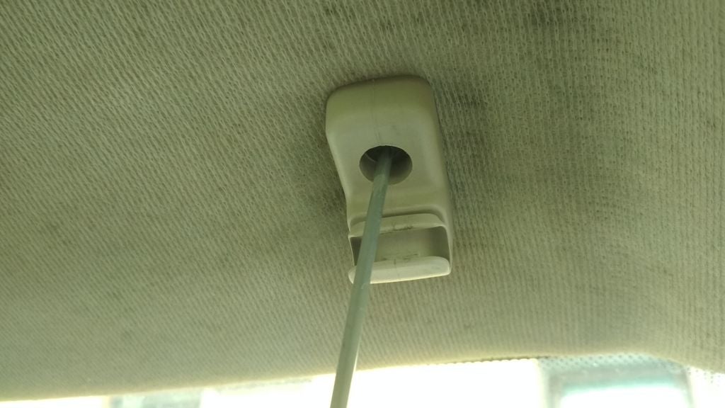

A visor clip in my car has recently broken and I decided to print my own instead of buying a new one.
Step 1: Unscrew the Second Clip and Measure It
There are probably differences between your parts and mine, so model your own object.
First I unscrewed the second clip to see it's geometry and measurements.

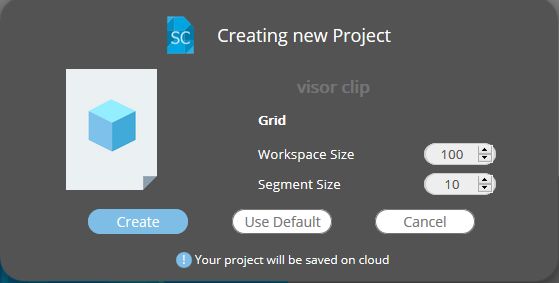

Step 2: Create New SelfCAD Project
Launch SelfCAD editor and create a new project. The visor clip is a small object, so workspace size equal 100 mm is definitely enough. The segment size isn't important in this project. I set it to 10.

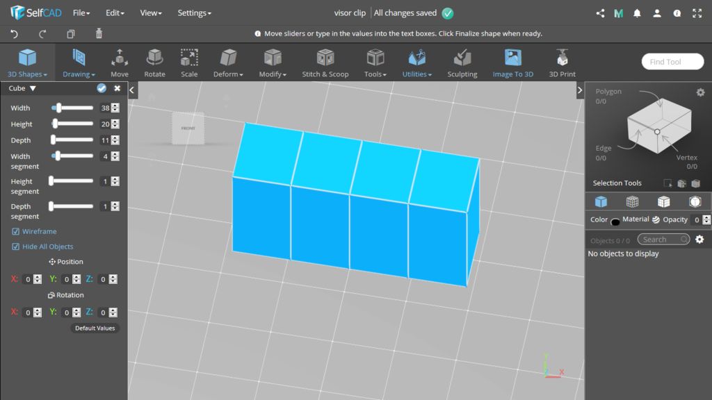

Step 3: Add a Cube to the Scene
There is also a faster way to model the clip. You can use Free Hand and draw its shape. However, we need to use Stitch & Scoop many times and this tool works better with 3D Shapes.
Add a cube to the scene. Set its measurements as you need. My clip should be 20mm high, 38mm long and 11mm deep. I also needed 4 width segments.

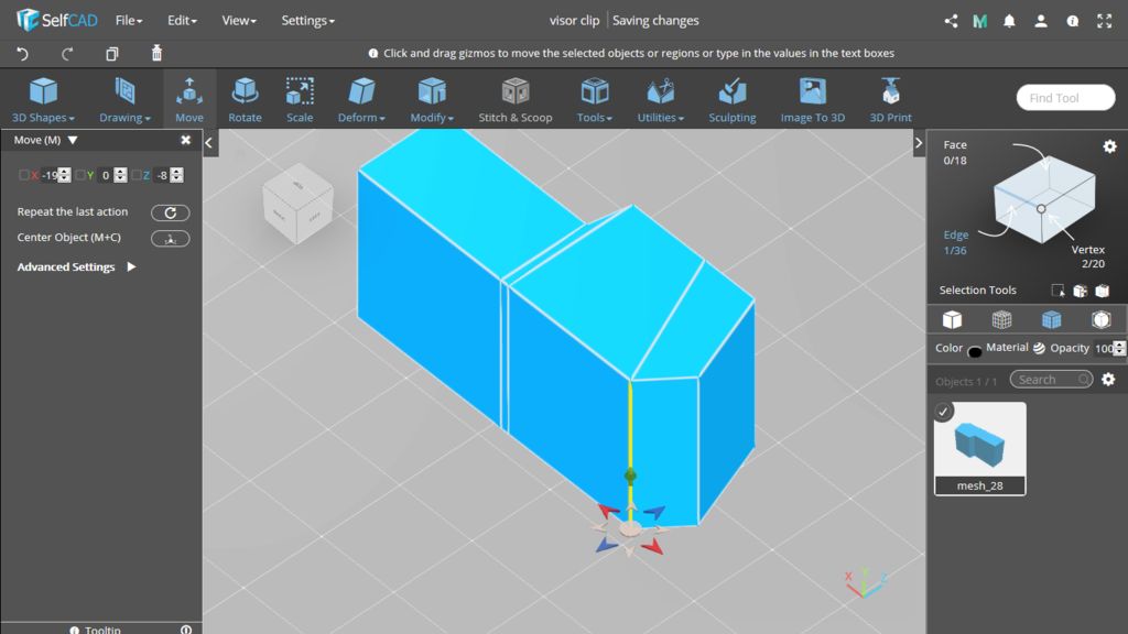

Step 5: Move the Edge Loops

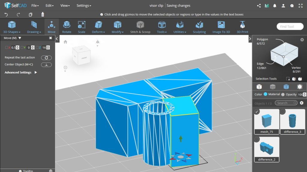

Step 6: Move Faces
Step 7: Move Edges

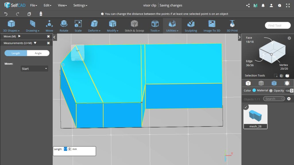

Step 8: Use Measurements Tool
You can always use Measurements tool located in Utilities.

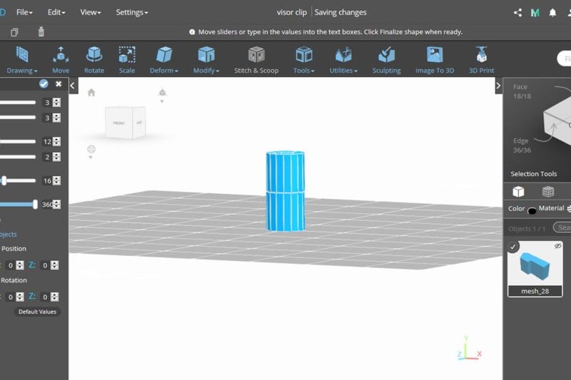

Step 9: Add a Cylinder
Now we need some cylinders. The first one, with a radius of 3mm, is 12 mm high.

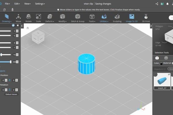

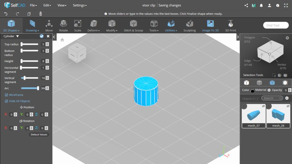

Step 10: Add Second Cylinder
The second one, with a radius of 5mm, is 8 mm high.

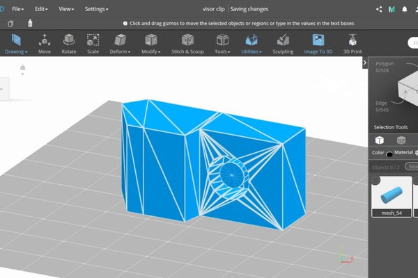

Step 11: Subtract Cylinder From the Cube
Use the last cylinder to cut a hole in the base. Select both objects and choose Stitch & Scoop tool. Use Difference to subtract cylinder from the cube.

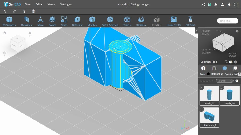

Step 12: Add Next Cylinder and Use Union
Select all three objects and use Stitch & Scoop again, this time use Union.
The third cylinder: radius 5 mm, height 4 mm.

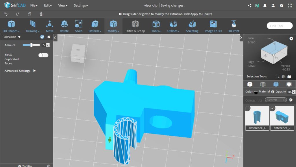

Step 16: Extrude and Move Faces to Complete the Model
Select the faces as in the image and use the Extrusion tool to connect the base with the clip. Now move the vertical edges to set their positions. These edges should be somewhere inside the clip object. Use Union to connect everything into one object.

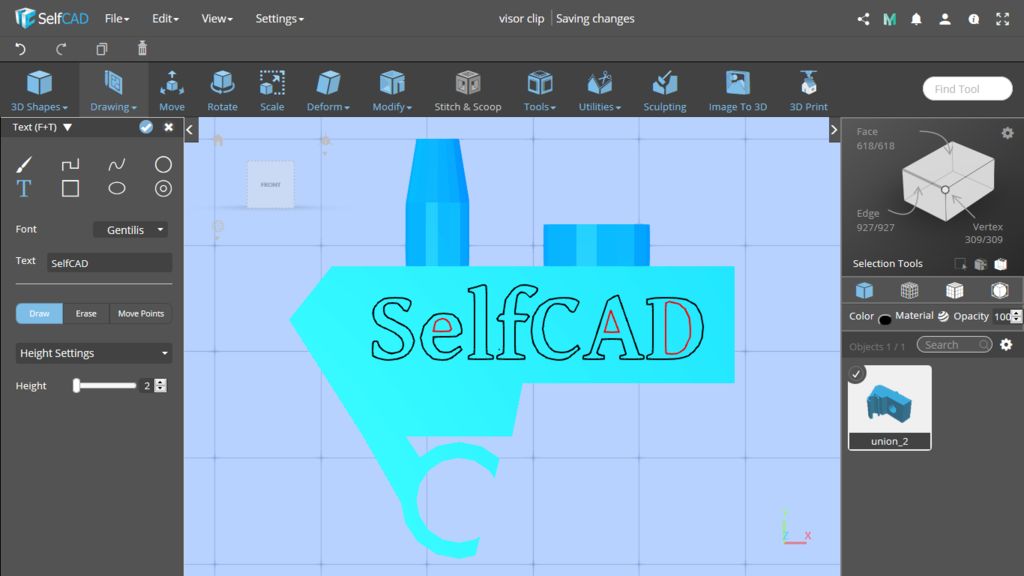

Step 17: Customize the Object
The best thing about modeling such things is that you can freely customize them as you want. You can change its shape, add a pattern or text.
