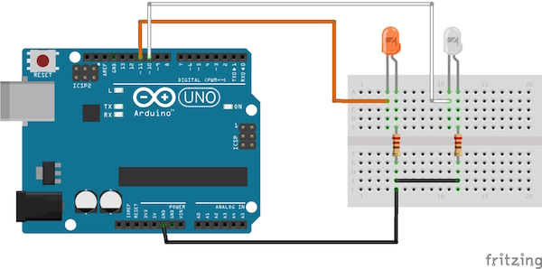

Connect pin 11 of Arduino to the positive lead of the orange LED and connect the negative lead of LED to the ground of Arduino through the 220 ohm resistor. Similarly, connect the positive lead of the white LED to pin 10 of Arduino and the negative lead of the LED to the ground of Arduino through the 220 ohm resistor.

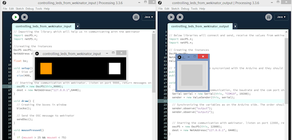

First, load the code that is provided below for Arduino in the Arduino IDE. Then upload the given code to process in the processing IDE.

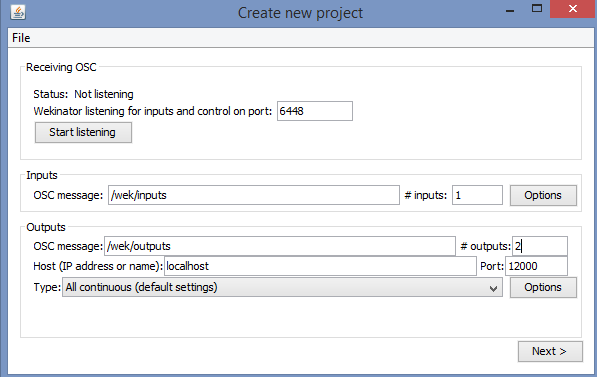

After that, open Wekinator and change the inputs to 1 and outputs to 2 and leave the other options as they are.

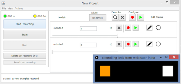

Click on “next” and a new window will come up. Now from the input window of processing, click on the orange box and in Wekinator, enter 1 in the output-1 box, and start the recording for half a second.

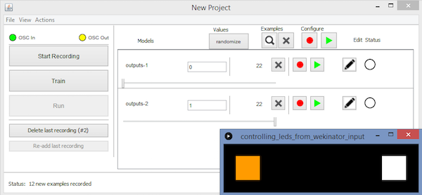

Now, click on the white box in processing, and in Wekinator, enter 0 in the output-1 box and enter 1 in the output-2 box and start recording for half a second.
Now click on “Train” and then click on “Run”. Now, when you will click on the orange box, the LED connected to pin 11 will light up, and when you click on the white box, the LED connected to pin 10 of the Arduino will light up.
