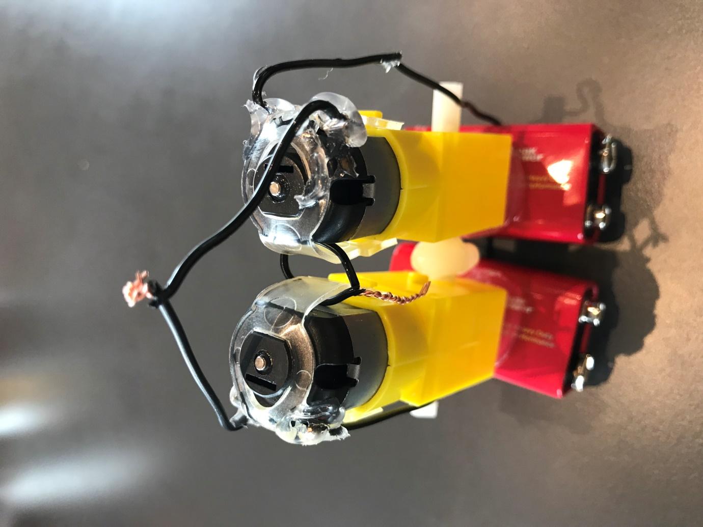

We cut the yellow protrusions underneath the motors in the picture.
Step 3: Siliconized Motors
Then we stick the motors with silicone like in the picture. Here is the part that needs attention; first apply some silicone on the white part and stick the white part of the other motor here, wait a long time to make sure it sticks. Make sure that the silicone does not touch the yellow parts of the motor!
Step 4: Siliconized Batteries to the Motors
Our motors stick together! Now we stick the batteries to the motors.
Step 5: Circuit Design
Now we can constitute the circuit. Solder the cable in the picture to the cross-ends of the motors, then silicoze.
We continue to constitute a circuit like the picture.
The circuit is over! Let's test the robot by opening and closing the switch. If the robot is not running, it means that you made a mistake in the circuit constitute.(if your batteries are full :P) Check connections again.
