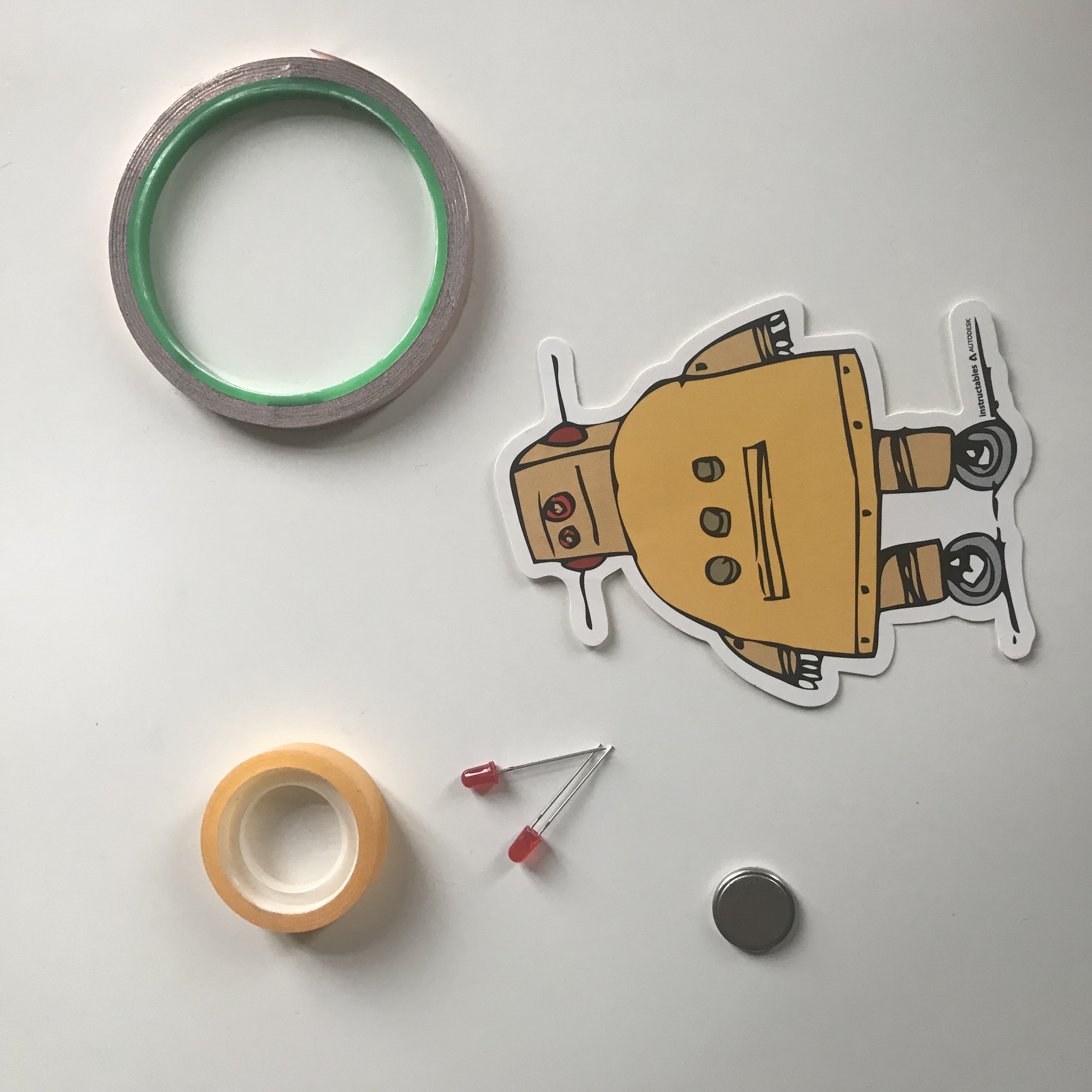

Step 1: Required Materials
- Red 5mm LED (2)
- Copper Tape
- 3V CR2032 Coin Cell Battery
- The picture of Instructables robot. ( I wanted to make this project with the picture of Instructables robot. You can draw your own robot if you want.)
- Adhesive tape

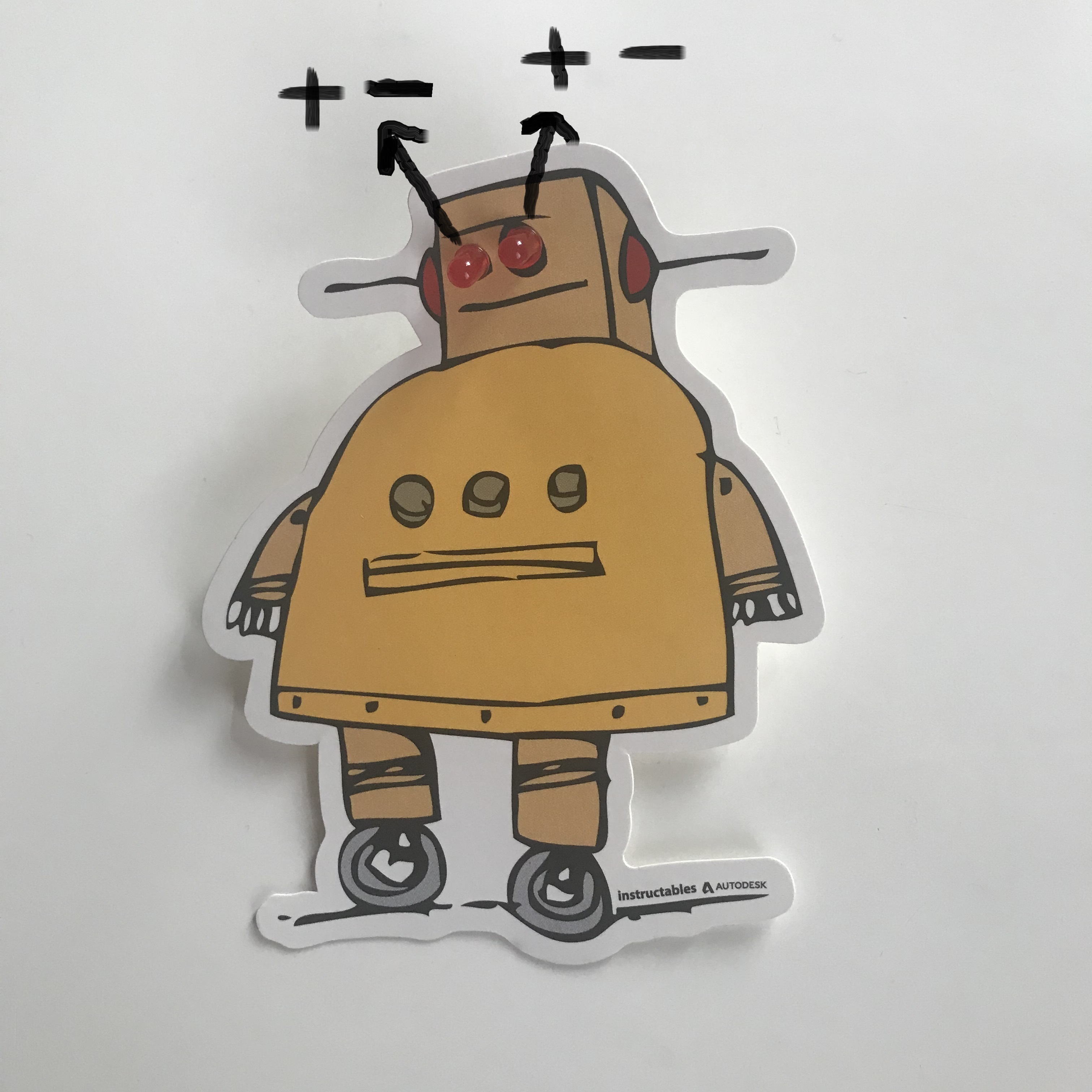

Put the leds on the robot’s eyes as shown in the picture.

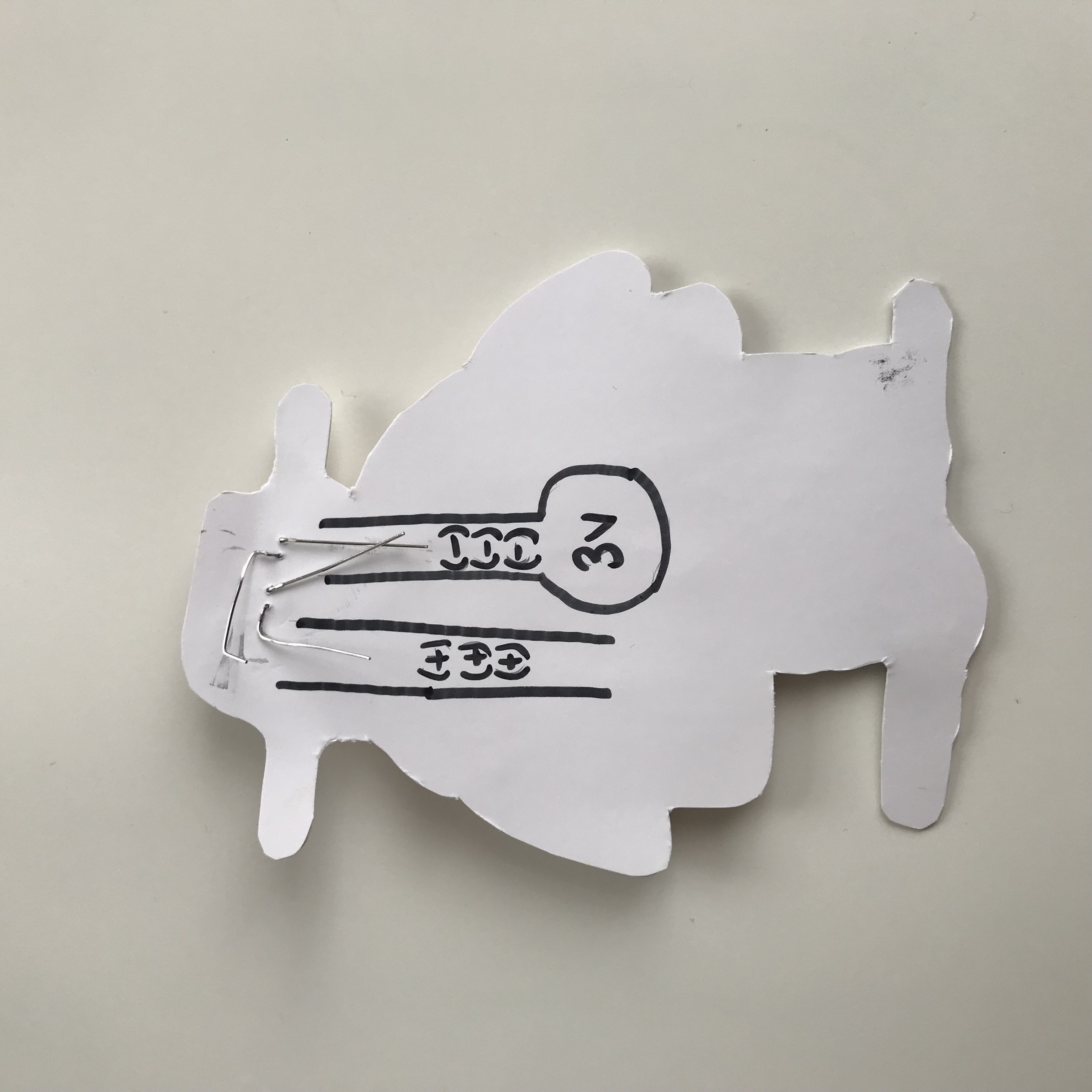

Step 3: Drawing Circuit Diagram - 2

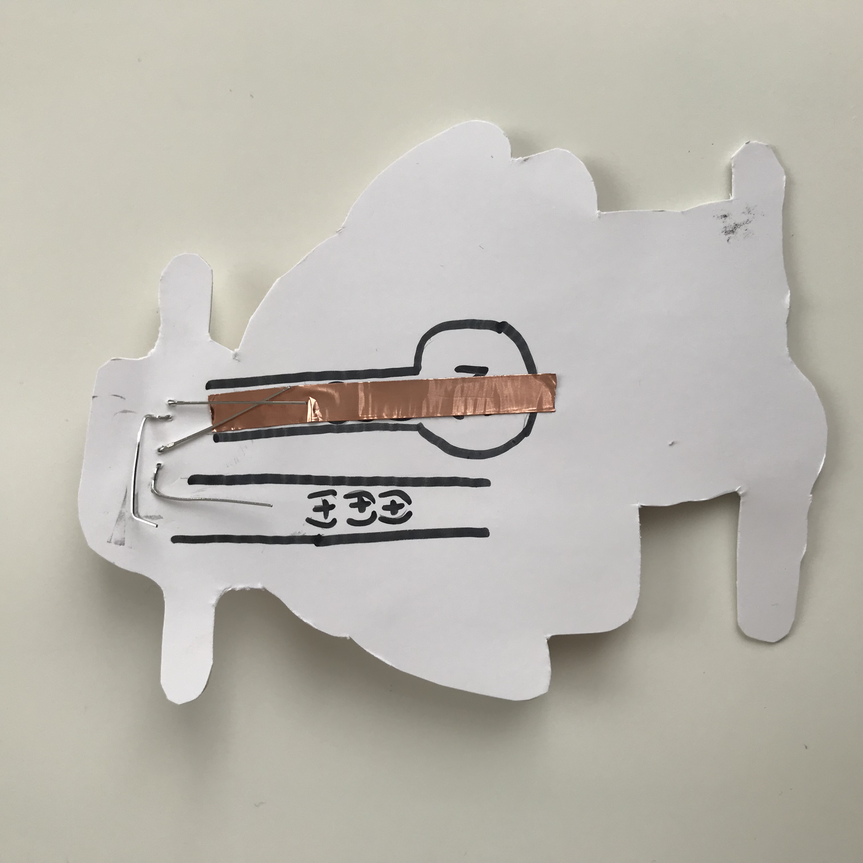

Let's draw the circuit as shown in the picture. Bring the minus legs of the leds together and do the same for other legs (+) as shown in the picture.

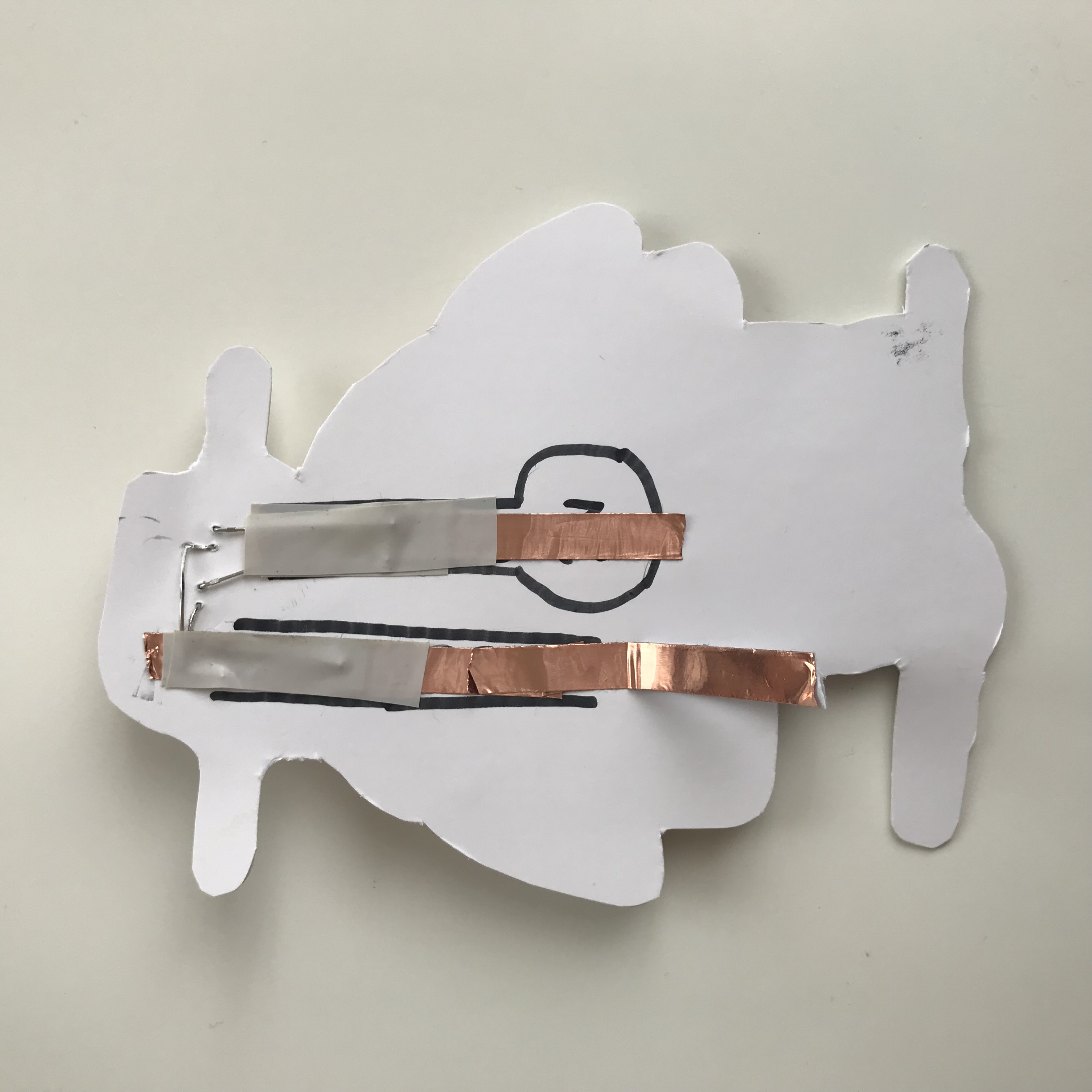

Step 4: Drawing Circuit Diagram - 3
Stick the copper tape by following the way of the circuit. Stick adhesive tape on the legs of the leds.

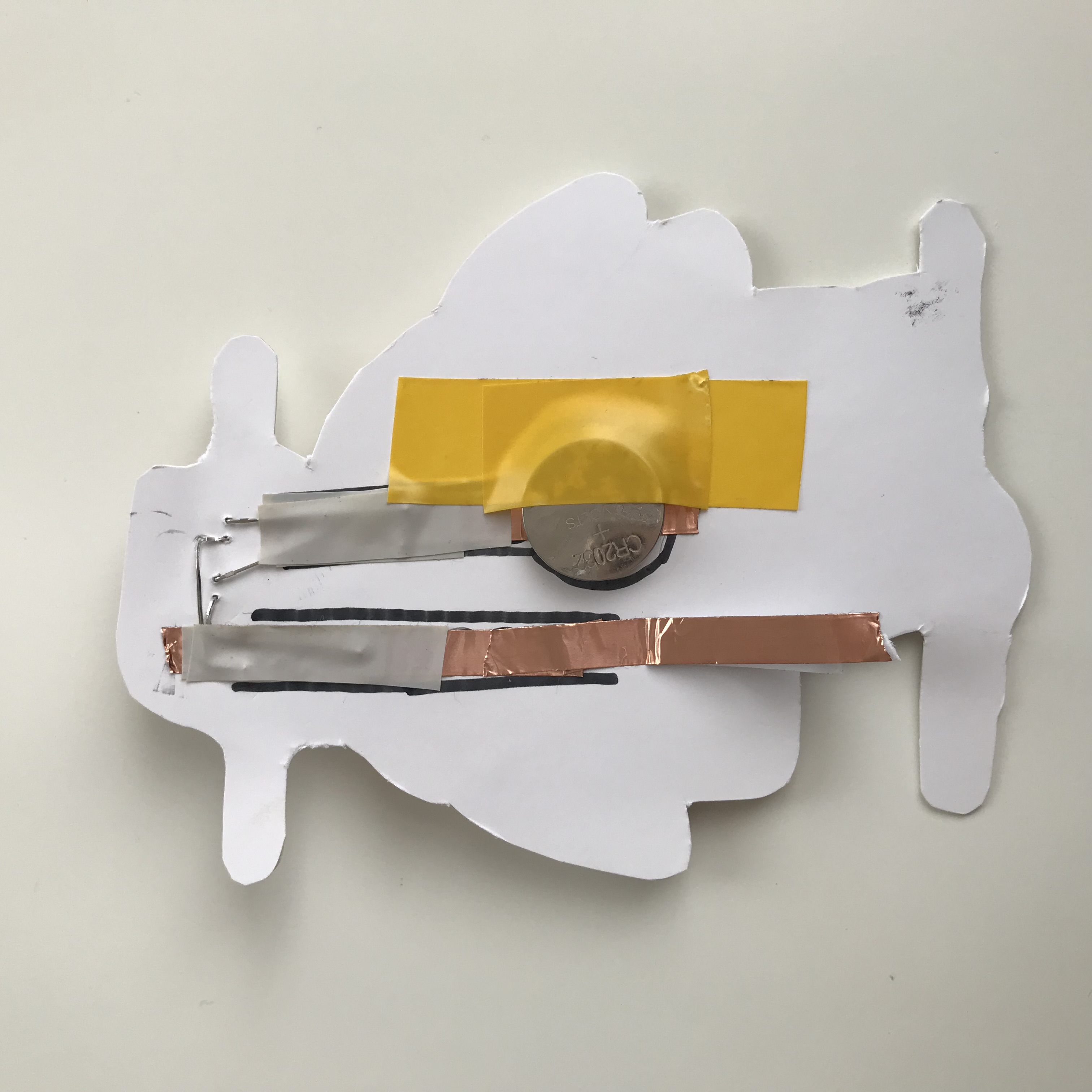

Step 5: Drawing Circuit Diagram - 4
Glue half of the 3V battery with adhesive tape as shown in the picture.

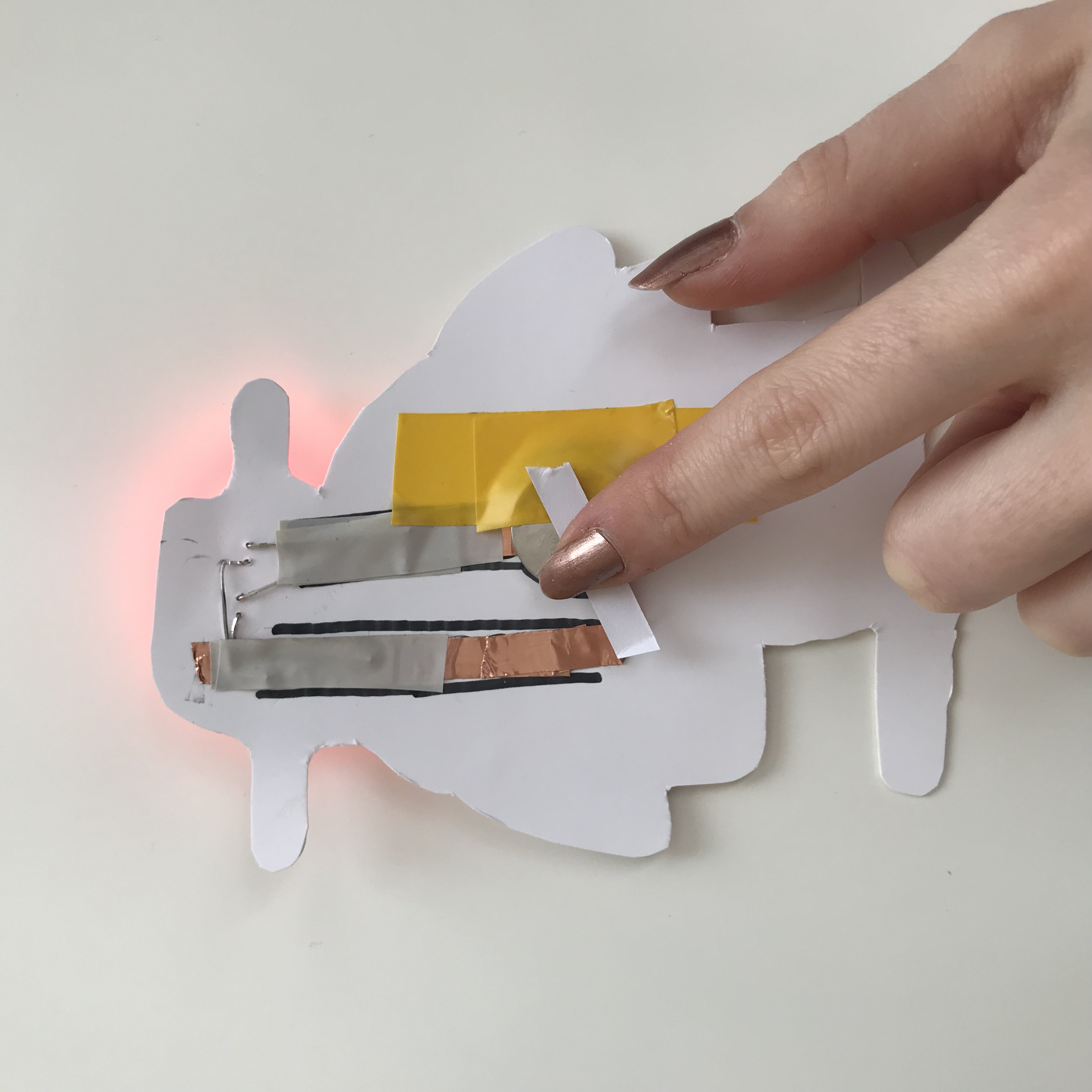

Step 6: Drawing Circuit Diagram - 5

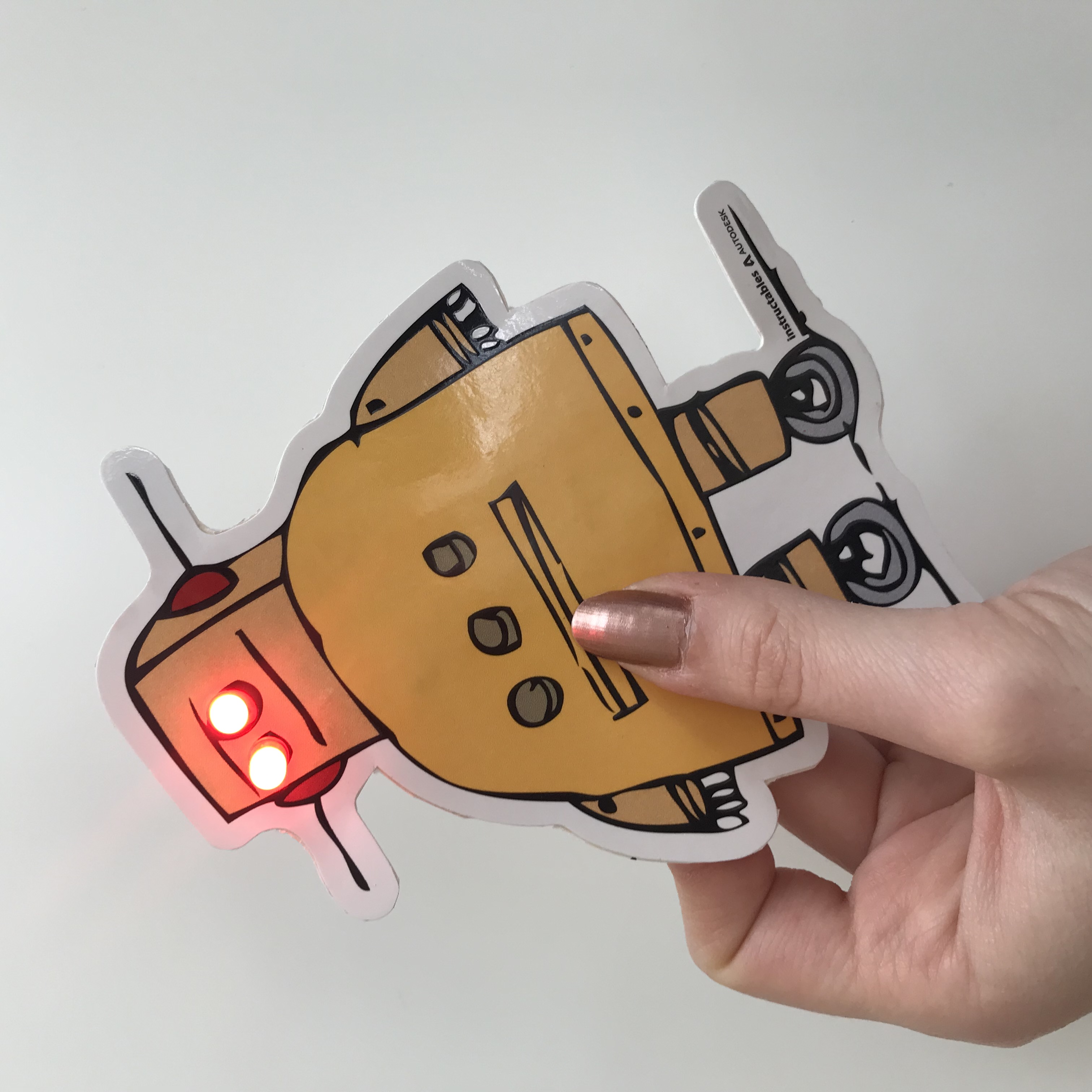

The robot's eyes will light up when you press the copper tape onto the battery. If it doesn't, check the circuit.)

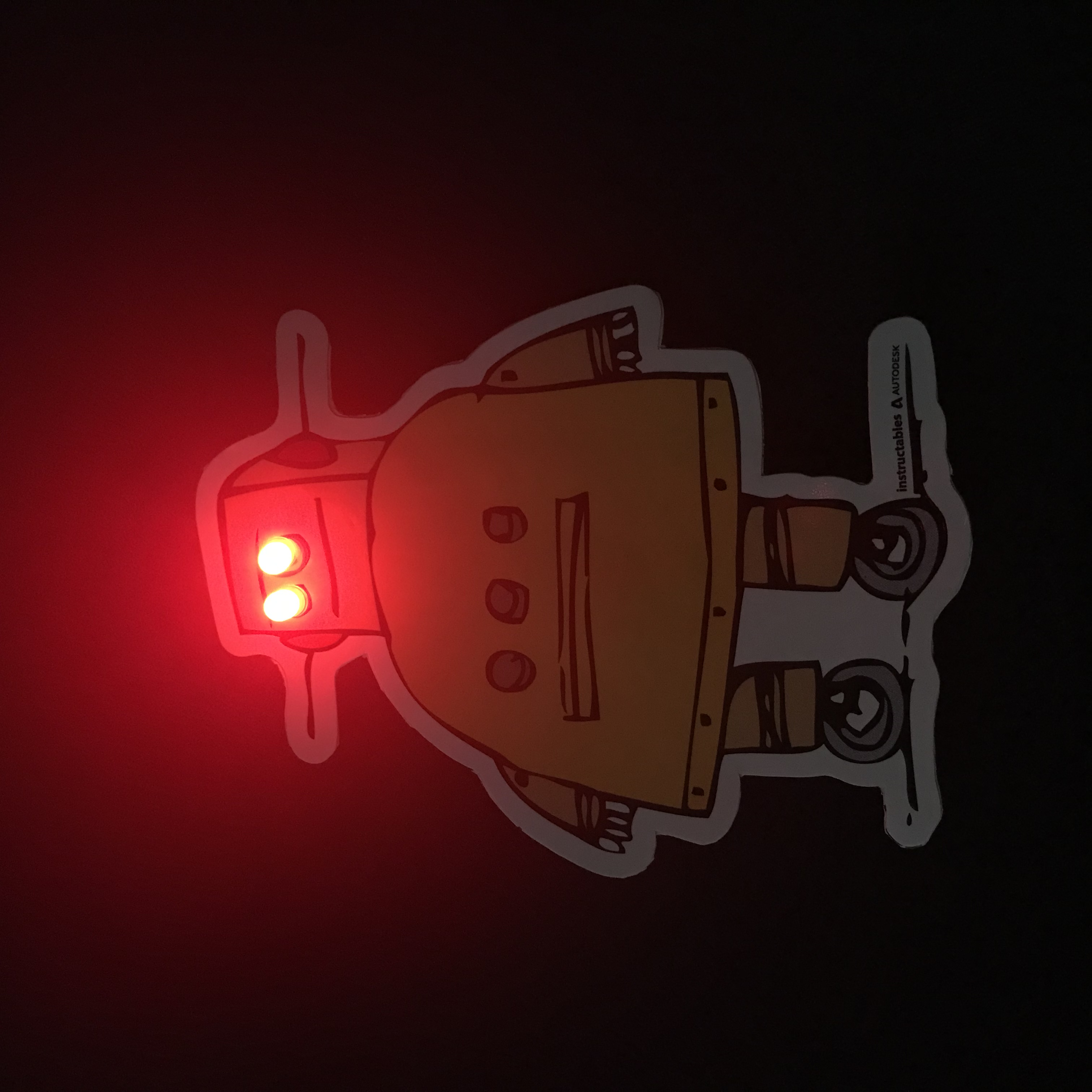

Step 7: Final Step
Paper circuit projects are very easy and fun. You can decorate any picture with leds with a little creativity and simple electronic knowledges. We will make parallel circuits in my next project! Waiting for your comments.
