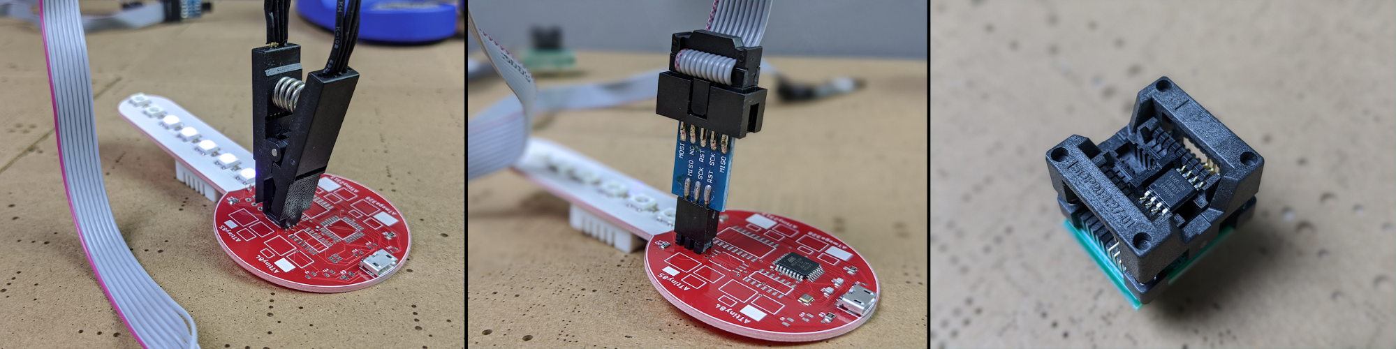

In this article, we will be taking a look at three different methods of programming your ATtiny microcontrollers that allow for programming SMD packages, and can be used for scaling up production from small prototype runs of under 100 units, up to runs of tens or hundreds of thousands of units:
  • Using an IC test clip along with an ISP programmer for in-situ programming,
  • Incorporating PCB headers or test points for interfacing an ISP programmer with a PCB using a header or pogo pins,
  • Direct programming using an SMT test clip or getting chips factory-programmed before soldering the microcontrollers to a board.

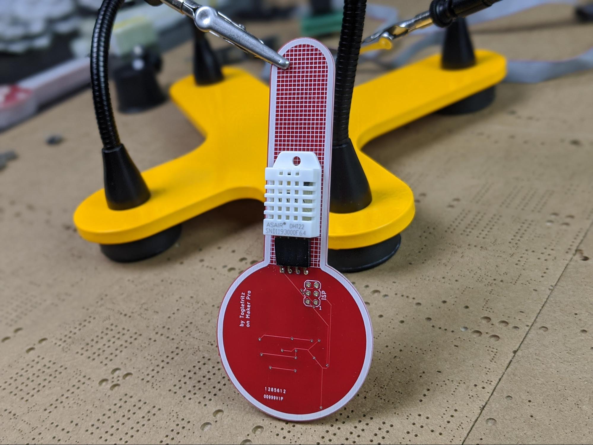

The PCB is a thermometer with a DHT22 temperature-humidity sensor on the backside. This sensor takes a reading of, in this case, just the temperature.
The back view of the custom PCB with a DHT22 sensor attached.

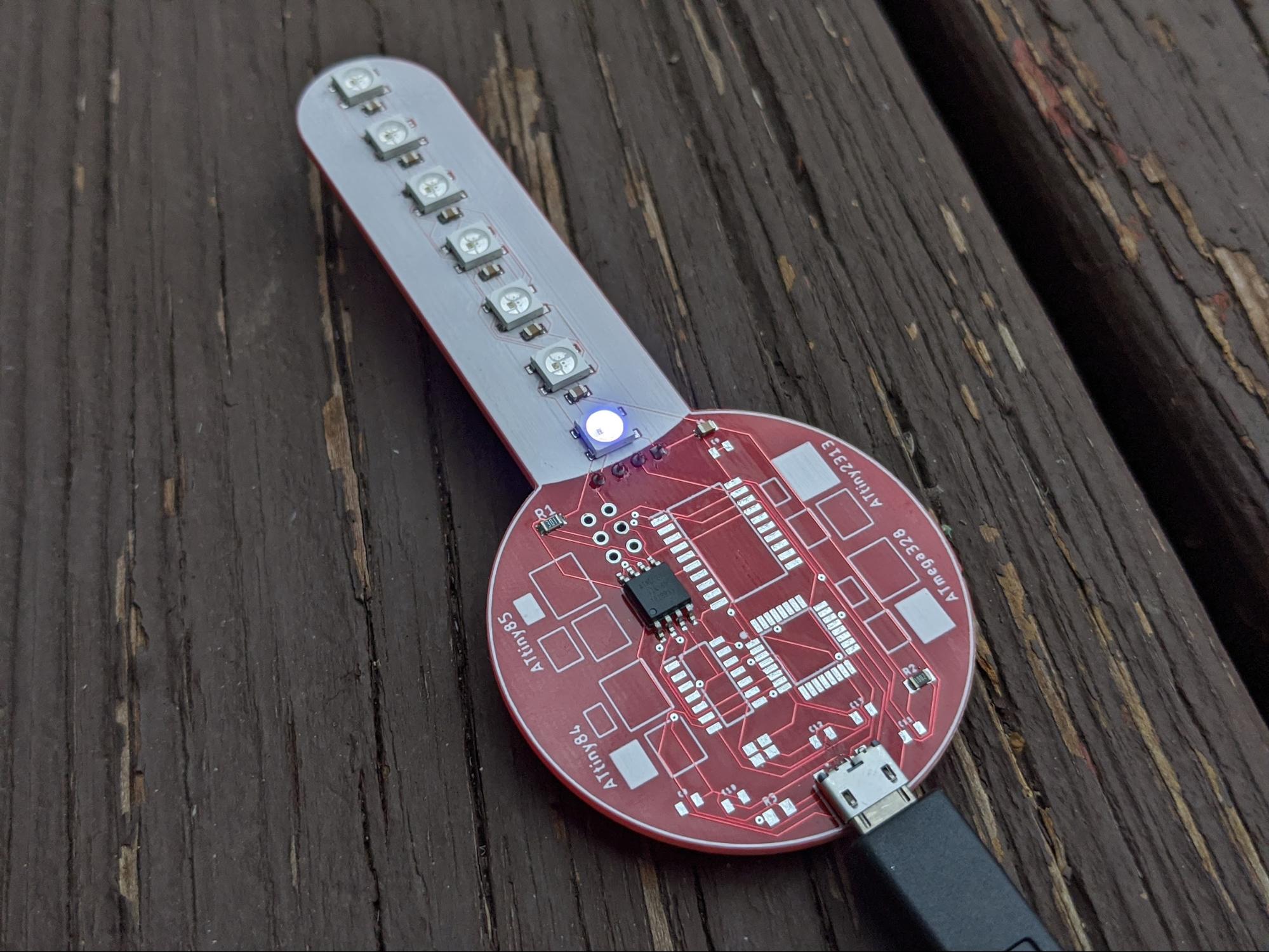

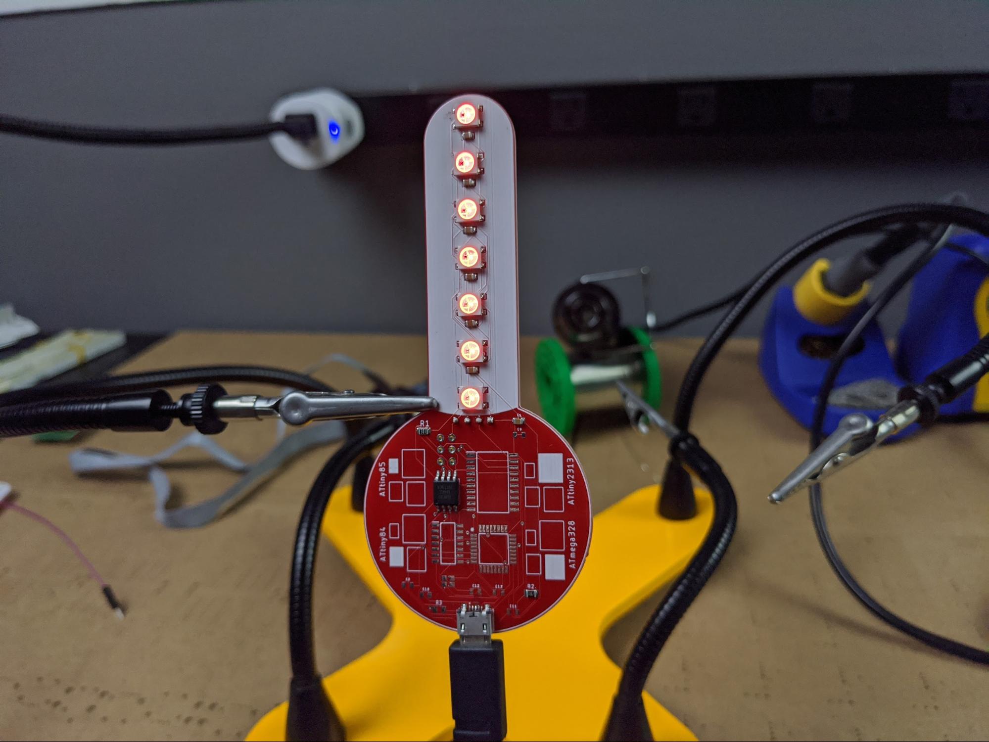

The test board also features a line of LEDs on the front, like the tube of mercury/alcohol on an analog thermometer. More LEDs light up at higher temperatures and, additionally, the LEDs change color from blue to red between low and high colors.
custom pcb with leds
At cold temperatures, like outside in the winter, the LEDs glow blue and fewer will illuminate.
At high temperatures, like in front of a heat gun, the LEDs illuminate red and more of them turn on.

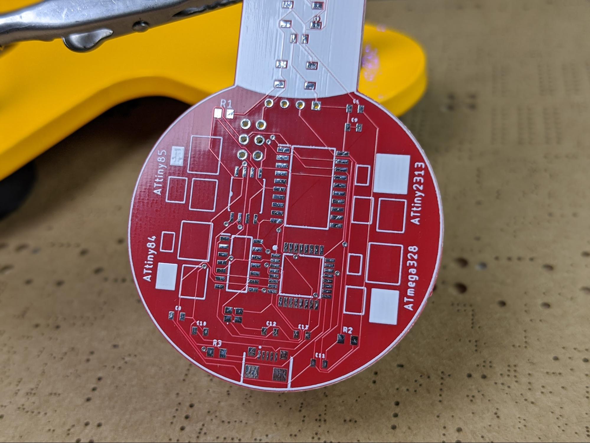

The main part of the test board has footprints for installing one of the ATtiny series microcontrollers: ATtiny84, ATtiny85, ATtiny2313, ATmega328. Each microcontroller also has a few passive components to make everything work.
footprints on PCB to attach ATtiny MCUs
The PCB also contains footprints for installing an ATtiny 84, ATtiny 85, ATtiny2313, or an ATmega328.
