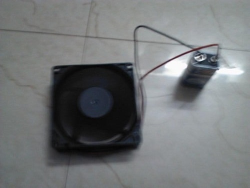

1. Connect the leads of the CPU fans to a 12V battery in the correct polarity and ensure it's working properly.

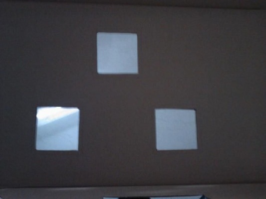

2. Mark the positions for the CPU fans on the shipping box and cut the marked places using a cutter. You will now have a box with three holes as shown in the picture below.

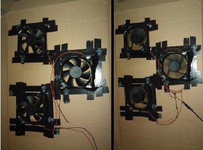

3. Fix all three fans inside the box using wiring tape. Make sure that the fans are positioned such that they blow air away from the laptop that will be placed on top of the closed box once the cooler is completed.

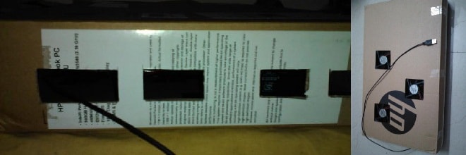

5. Using the pencil and cutter, cut a few holes on either sides of the box. This will help in proper circulation of air. Take the USB cable out through one of these holes.

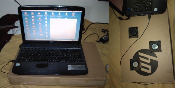

Congrats!! You have now finished making your DIY laptop cooler. Below is a picture of the finished product.
