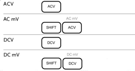

Voltage Test
First select the test type and range of a voltage, then insert the red and black test lead into the main input end and the common end for measurement。

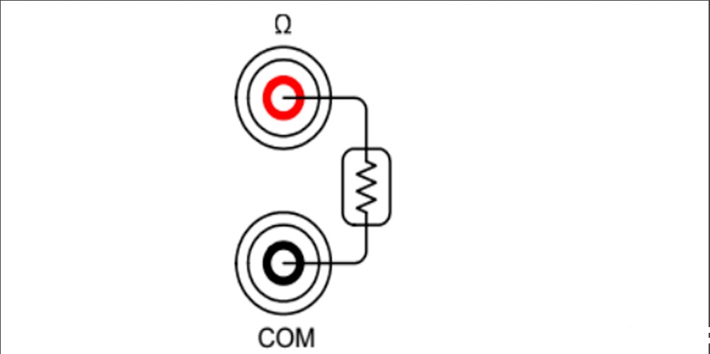

Resistance Test
Press [Ω], insert the red test lead and the black test lead into the main test port and the common terminal respectively, and then measure the resistance.
