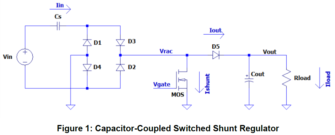

At a basic level, shunt regulators consist of two elements: a voltage regulator in parallel with the load (shunt) and a current-limiting element in series between the supply and load. The shunt regulator used in this project is specifically a capacitor-coupled switched shunt (CCSS) regulator (Figure 1). When the switch is closed, it short circuits the input current to ground. When it is open, diode D5 diverts the input current to the load. Besides the series capacitor (Cs), the highest voltage seen by the other components is one diode drop above Vout.
As with all shunt regulators, input current to a CCSS regulator is constant regardless of load but varies with input voltage and the series capacitance. Although current will always be drawn even under no-load conditions this current is mainly reactive with a small real. Input current can be estimated with the following equation:
??? = ??? / ?c
Output voltage regulation is achieved by controlling the duty cycle of the switched shunt. The MOSFET shunt turns off when the Vout is below the desired regulation threshold, sending all the input current to the output. When Vout exceeds that threshold, the MOSFET shunt turns on, sending all the input current instead to ground and back to the input. The shunt is synchronized to turn on when the voltage across it (Vrac) is low to minimize the applied voltage step across Cs resulting in a more efficient operation.

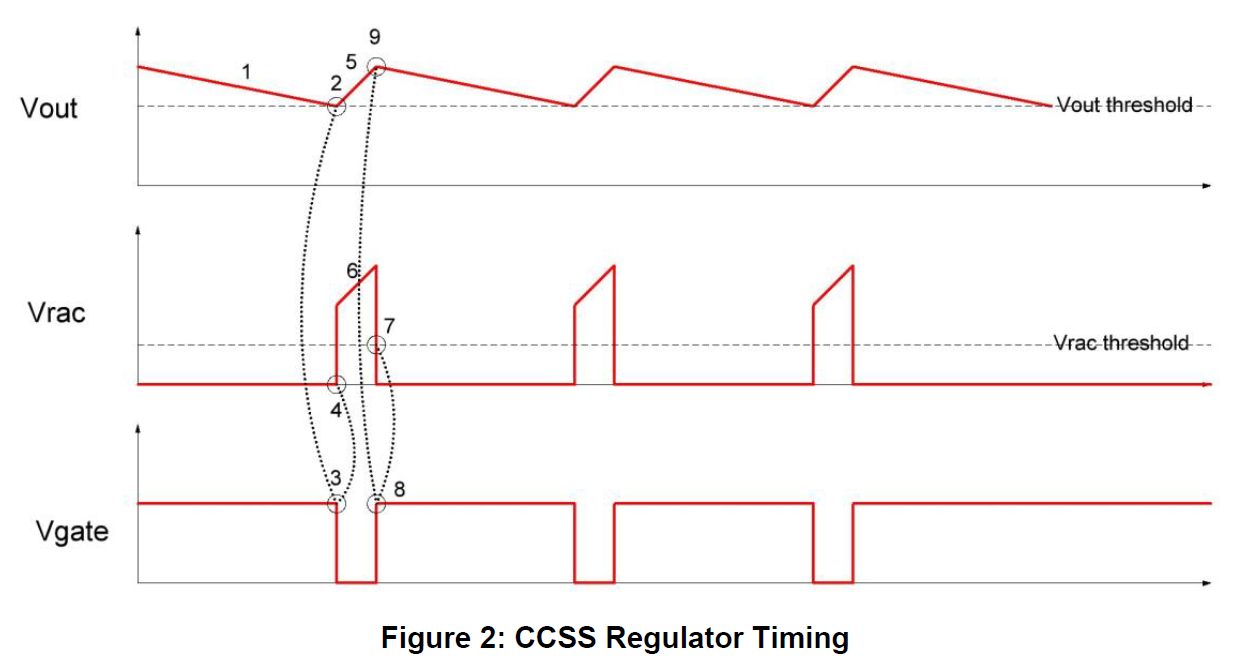

The following diagram shows the operation of this control manner from a timing perspective.
Figure 2 describes the CCSS timing diagram:
Output voltage decays under load until
It hits the Vout threshold which
Turns off the shunt
Freeing the Vrac from GND
Vrac is clamped by D5 (Vout-0.6V) when Vout starts to rise until
Vrac falls below Vout as AC input
Vrac falls to Vrac threshold …
The shunt is turned on, Vrac is clamped by GND …
Output voltage decays under load and the cycle repeats.

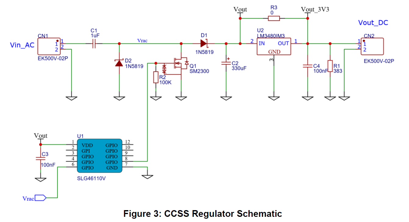

Circuit Schematic and Layout

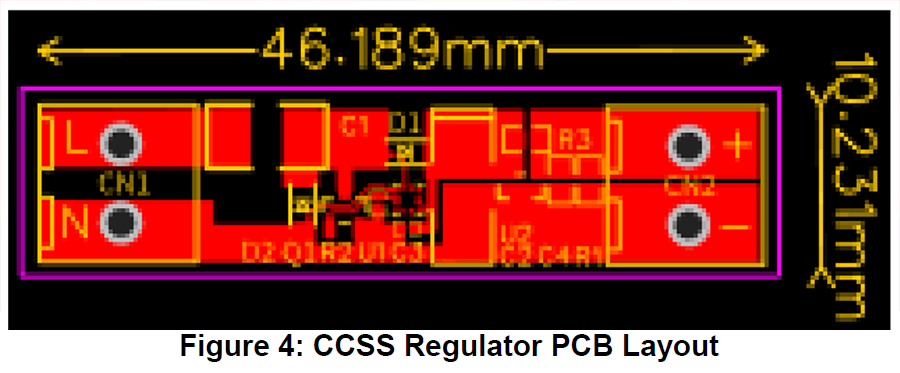

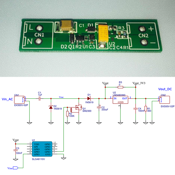

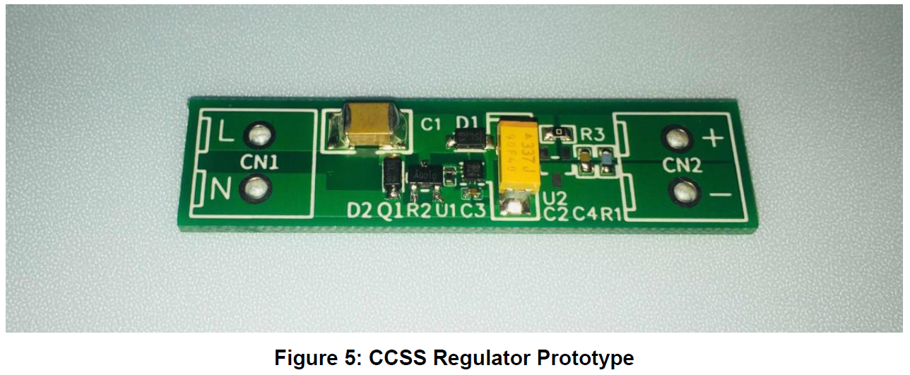

Figure 3 depicts the circuit schematic of the low-power AC-DC converter module. It uses the SLG46110 (U1) to control the CCSS. The module operates at an input AC voltage range from 90V to 260V(CN1), and over a non-isolated output of 3.3V (CN2). An optional LDO (U2) is added after the Vout to further stabilize the output voltage. The SLG46110 device generates the control signal that switches the MOSFET shunt (Q1) based on the Vout and Vrac threshold levels. 1N5817 Schottky diodes were used for D1 and D2. Since the dissipation factor (DF) of CS has a large effect on the efficiency of the circuit, a 1µF capacitor with a relatively small DF of 40 x 10-4 is used for CS. Figure 4 shows a picture of the PCB Layout of the board. Figure 5 shows a photograph of the complete design PCB described in this project.

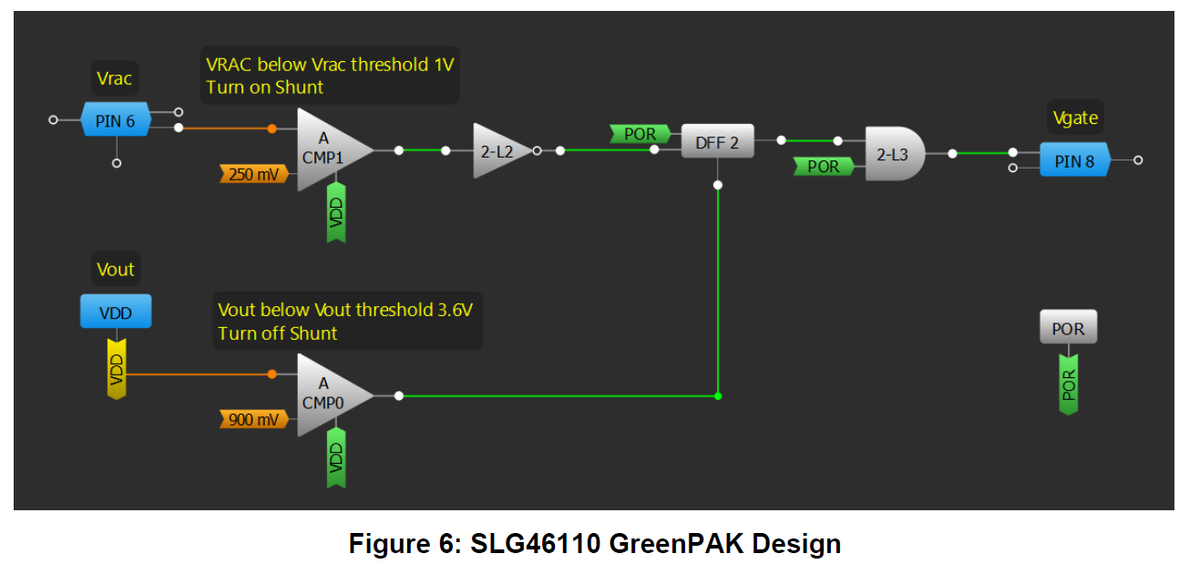

The project design developed in GreenPAK Designer is shown in Figure 6.
Comparator Configuration

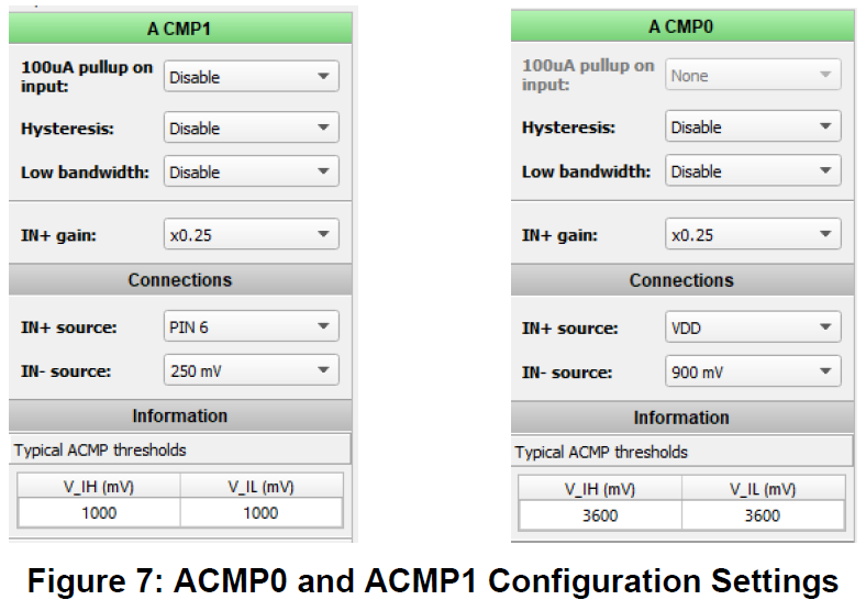

As shown in Figure 3 VDD of the SLG46110 device is connected to Vout and PIN6 to Vrac. ACMP0 is used to sense Vout voltage. With the additional logic, it will turn off the MOSFET shunt when Vout < 3.6V. ACMP1 is used to sense Vrac voltage. It will turn on the MOSFET shunt when Vrac < 1V. Refer to Figure 7 for the ACMPs settings.

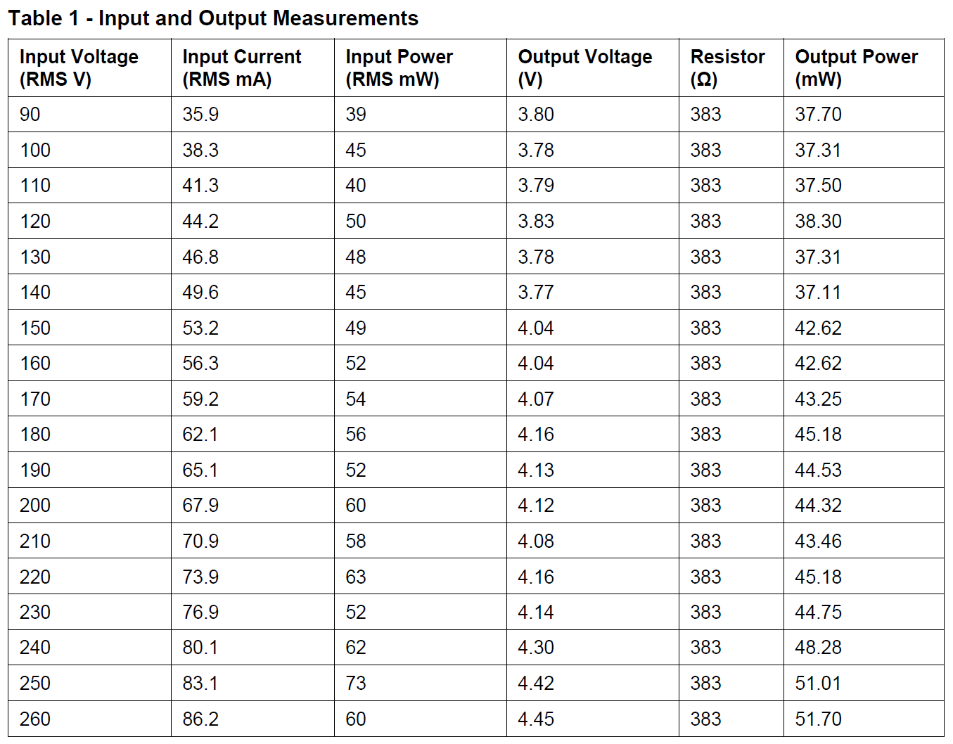

Below in Table 1 are the input and output measurements. The input RMS power is calculated with an AC power meter and the output power is calculated by multiplying the output voltage by the squared value of the resistor. As stated previously, Cs is a 1uF capacitor with a DF of 40 x 10-4.
