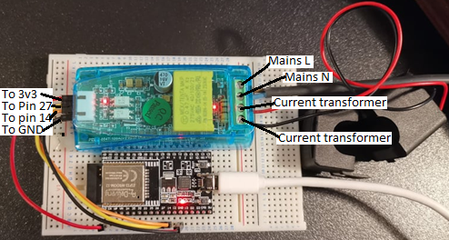

Hardware:
ESP32 Wroom-32 Module with integrated Wi-Fi. (Other ESP32 modules can be used). I am using a Wroom version, but the Lolin will work just as well.
Solderless Breadboard
Micro USB LEAD
4x Male / Female Dupont Jumper Wires
Mains rated twin-core cable protected with a maximum 3 amp fuse.
Power monitor PZEM-004T.
The version I bought has a plastic enclosure (Vital to prevent mains shock) and a 100A Split transformer:
IMPORTANT HEALTH WARNING: Mains can kill. Only attempt this project if you are competent at mains wiring!
I would recommend the mains of PZEM-004T to be wired to a 3 amp fused mains plug.
Only purchase the PZEM-004T that has a plastic casing

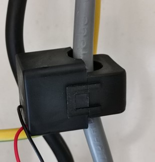

Note: The split current transformer only clips onto a single wire of the consumer unit:
You will notice that 5V of PZEM-004T connects to 3V3 of ESP32.
That is not a typo!
The Wi-Fi board supplies the power to the PZEM-004T, not the other way around.
Since the ESP32 pins are only 3V3 tolerant, the PZEM-004T works just as well at 3V3.
As there is less hardware involved, you will not need to level shift.

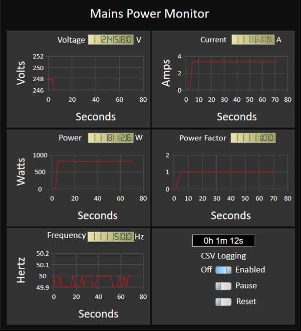

This is the end result using Flowcode App Developer:

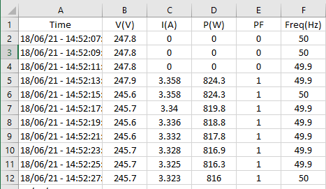

Below is a small sample of what the logs look like that is saved on the P.C.:
Example from the generated CSV logs:
From Row 46 is when I switched my kettle on.

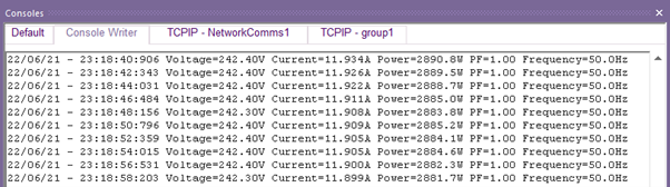

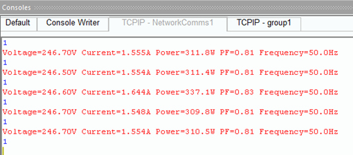

There is also a Console view (View Tab, Console):
Also Console Writer View:

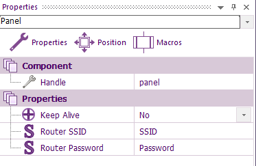

9. Select View, Component Properties:
Or you can select View, 2D panel and right-click on a blank area, choose Properties.
Replace SSID and Password with the ones for your router:

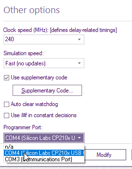

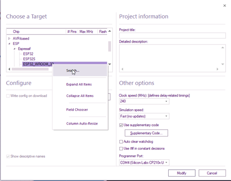

10. Select Build Ribbon, Project Options, select the correct Programmer Port:
Select Modify.
The board we are using is ESP32-Wroom 32.
If that is the board you have, then skip to 13.

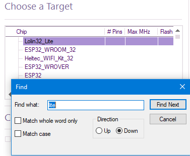

If you have a different board, e.g. Lolin Light, then while you are within Project Options, you will see ESP32-Wroom 32 highlighted.
Right-click and select search & enter a keyword, e.g
lite or loli etc.
Select Find Next, and the new board/Microcontroller will be highlighted.
Select X or Cancel Then Modify.

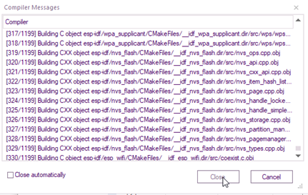

11. Staying within the Build ribbon, Select Compile to Target.
If, when compiling to target, you see error messages about not a recognised command, try restarting your P.C.
As This will be the first time of compiling, the time taken to compile may take up to a couple of minutes:

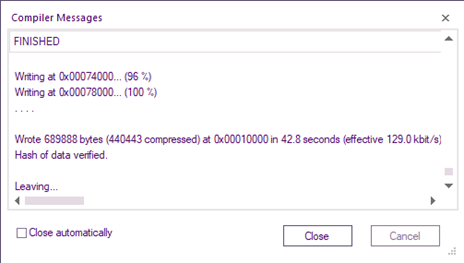

All being well, the Esp32 board should be programmed:

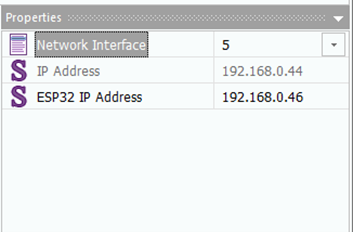

Select the drop-down arrow and keep selecting different network interface numbers until you see your P.C.’s I.P. Address:
Sometimes I have found this only works on P.C.’s that have a connection to Wi-Fi.
My main P.C. is only Ethernet.
I have tried with Ethernet connections and can only see 0.0.0.0 for the I.P. Address.
What I did was order a cheap USB Wi-Fi adapter, and that worked perfectly!
When you see the correct I.P. address of your P.C., enter the I.P. details of your ESP32 board (Espressif Inc.) from The Wireless Network Watcher

When you enable CSV logging, the X.Y. charts will also start logging.
So the CSV file does not get too large and unmanageable, a new CSV file with an incremented number will be automatically generated after every 86400 rows.
When you click on the Reset switch, the number will reset back to 1.
So make sure you have all the CSV files backed up first.

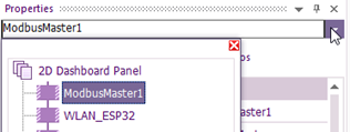

1. MODBUS is at the wrong frequency.
Check those MODBUS properties are set for 9600 Baud.
Within properties, select ModbusMaster1 from the drop-down arrow
You can check the frequency of ESP32 is correct by doing a one second Flash test.

1. Make sure that the correct router SSID and password is correctly entered within the properties:
Select the drop-down arrow then 2D Dashboard Panel on the popup window to enter SSID and Password.
