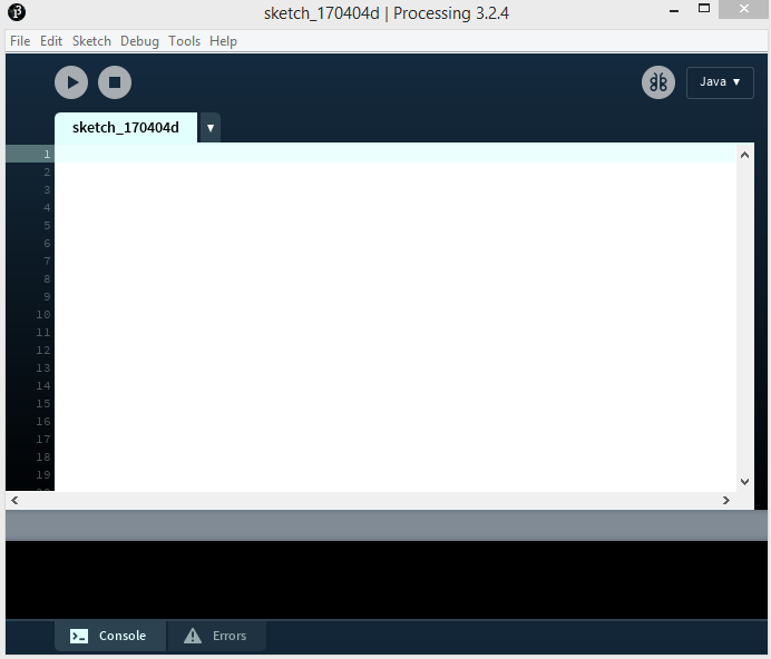

If you do not have already installed the Processing IDE, then you need to install it first. To install it, go to the link below and download the latest version of processing IDE. https://processing.org/download/
After downloading the latest version, open the Processing IDE setup and install it. After installing, open the Processing IDE and you will see something like this.

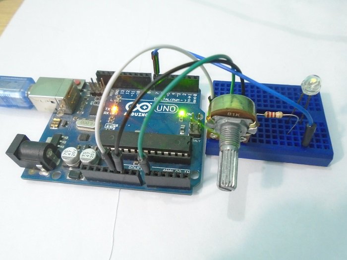

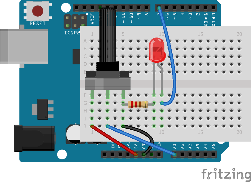

The connections for this tutorial are very easy. Connect the two end pins of the 1k potentiometer to the 5V and the GND pin of the Arduino. Then connect the middle pin of the potentiometer to the A0 on Arduino. Then connect the positive pin of the LED to pin 7 on the Arduino and the negative pin of the LED to the GND pin through the 220 ohm resistor.
