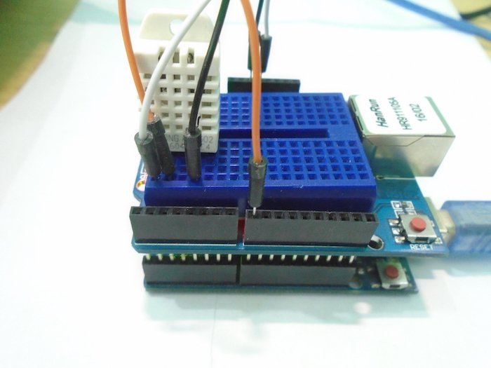

The Ethernet Shield sitting on top of our Arduino

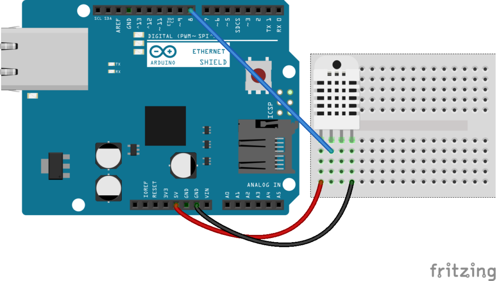

Circuit Diagram
First of all, place the Ethernet shield on the Arduino and insert the SD card in the SD card slot on the Arduino. Then make the connections for the DHT22 sensor with the Arduino as follows:
  • Connect the First pin on the DHT22 which is the VCC pin to 5V on the Arduino
  • Connect the Second pin on the DHT22 which is the Data pin to pin 8 on the Arduino
  • Connect the Last pin of DHT22 which is the GND pin to GND on the Arduino
View the full-size schematic
