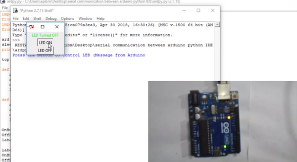

In Python, we are going to make a simple GUI application in which we will create two buttons to send the data to the Arduino.
You can find the Python code as a downloadable Zip file at the end of this article.
Create two buttons in Python to send data to the Arduino.
It is important to enter the correct Com port in the below code, so make sure to double-check your code!
