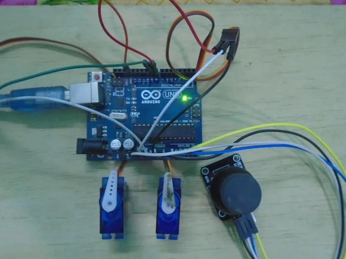

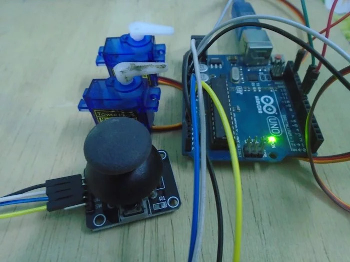

The hardware part of this project is very easy to make. First, connect the joystick module with the Arduino. The connections for the joystick module and the Arduino are as follows:
  • Connect the VCC on the joystick module with the 5V pin on the Arduino
  • Connect the GND pin on the joystick module with the GND on the Arduino
  • Connect the VER pin on the joystick module with the A0 on the Arduino
  • Connect the HOR pin on the joystick module with the A1 on the Arduino
After that, connect the servo motors with the Arduino. The connections for servo motors with Arduino are as follows:
  • Connect the black wire on both the servo motors with the GND on the Arduino
  • Connect the red wire on both the servo motors with the 5V pin on the Arduino
  • Connect the yellow wire on the first motor with pin 8 on the Arduino
  • Connect the yellow wire on the second motor with pin 9 on the Arduino
How Does It Work?
When the joystick module moves in the horizontal or in the vertical direction, it gives us values from 0 to 1023. So we can apply a condition in the code that if the value is less than 300 or greater than 700, then the servos will move.
When the joystick is moved in the horizontal direction, the first servo will move towards right or left and upon moving the joystick in the vertical direction, the second servo will move towards the right or left.
