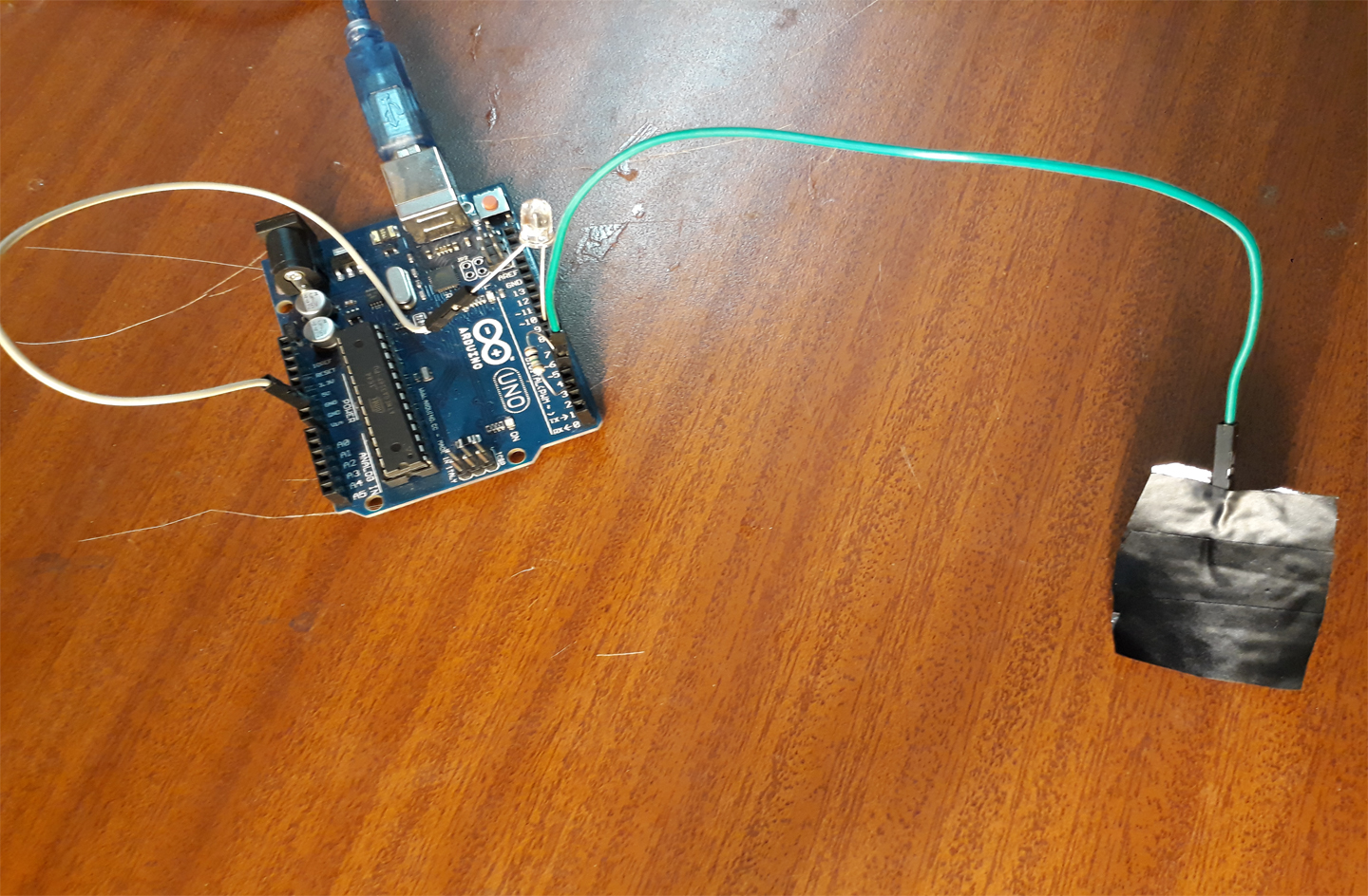

Prototype
In this project I made a touch controlled light that works based on Arduino Capacitive Sensing Library. You can make a touch sensor by using a aluminium foil(any metallic object will work). you can turn on or turn  off light by touching on  a aluminium foil.

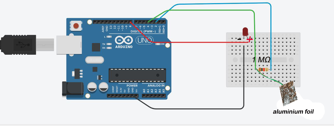

Making Touch Sensor :
The touch sensor can be made from any metallic objects.I have used aluminium foil to make this.
For many applications, a more useful range of values is obtained if the sensor is covered with paper, plastic, or another insulating material, so that users do not actually touch the metal foil.
So I have covered it with a insulation tape ,and it works well :)
Circuit Diagram
