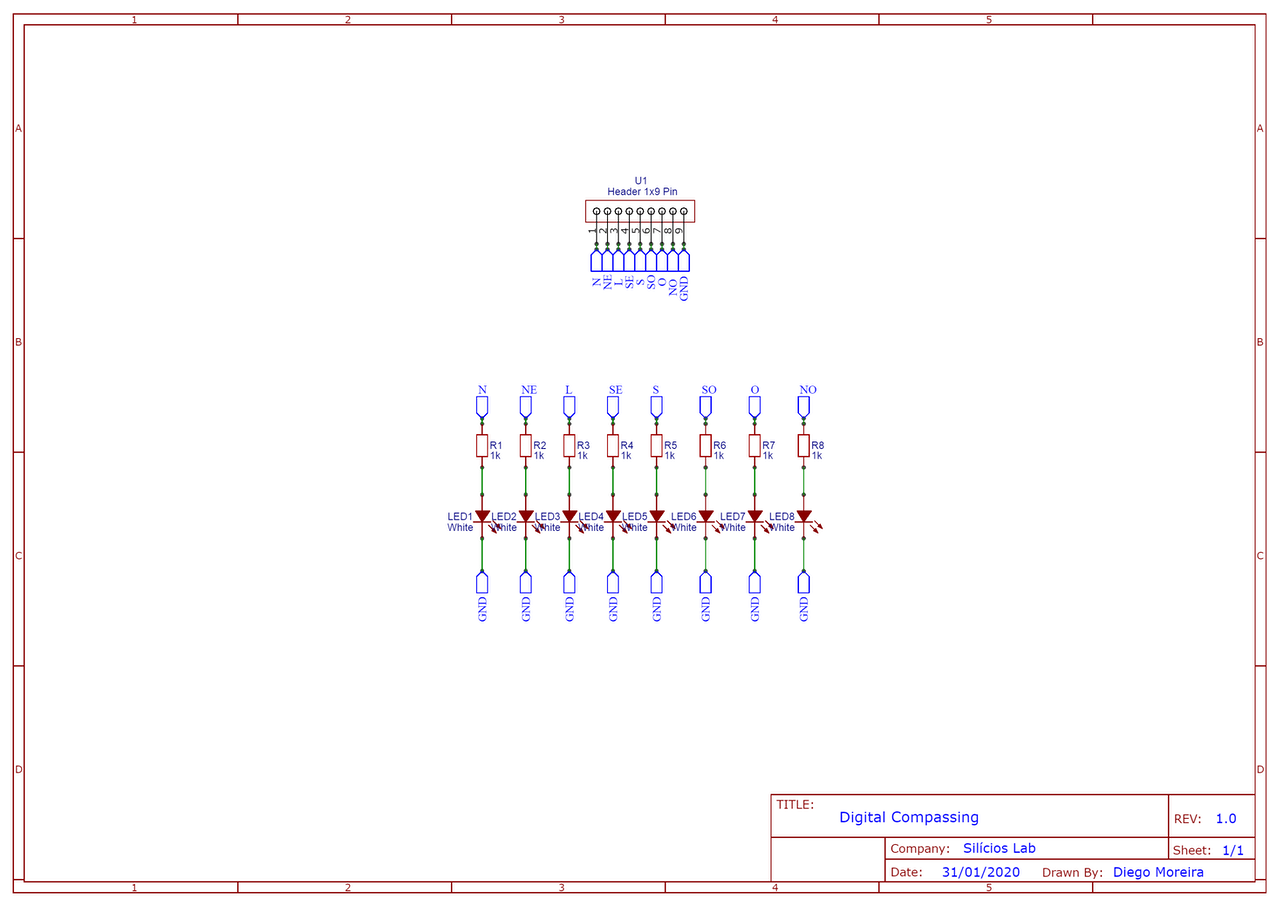

To start the development of the printed circuit board of the digital compass, it was necessary to develop the circuit with 8 LEDs and a 9-pin male connector.
Each LED represents a specific direction of the compass rose. The circuit is shown in Figure 2.
Figure 2 - Electronic Schematic of the Digital Compassing.

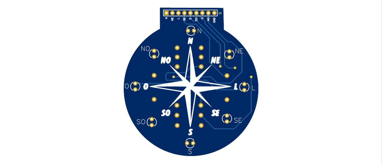

After the construction of the electronic schematic, the electronic board was developed. The PCB design is shown in Figure 3.
Figure 3 - Printed Circuit Board of the Digital Compassing.

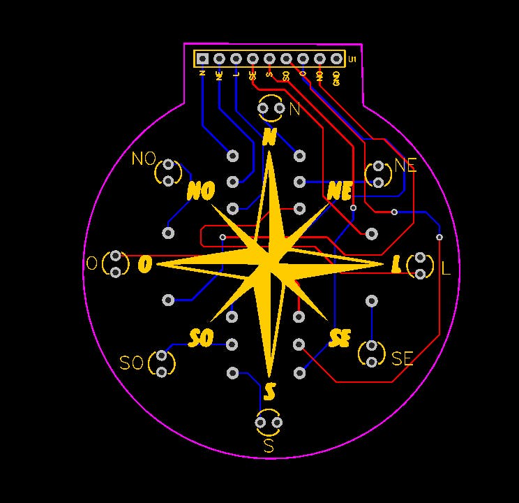

After the construction of the electronic board project, we can see its structure just below in Figure 4.
Figure 4 - Compass Rose PCB.

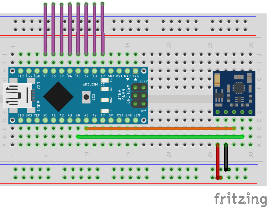

Now, I will show you how to build the circuit with the Arduino and the HMC5883L sensor. From this circuit, we will be able to detect the orientation of the robot and then activate the specific LED of the compass rose.
Step 2: Circuit Development of the Arduino with the HMC5883L Sensor
In the circuit below we present the Arduino Nano connected with the HMC5883L sensor.
The HMC5883L sensor is responsible for detecting the direction from North to South, and then the Arduino will receive and process this information.
From there, the Arduino will trigger one of the outputs from D2 to D9. These outputs will be connected to the board developed in step 1.
Therefore, each LED will represent a specific direction. The Electronic Schematic is presented in Figure 5.
Figure 5 - Electronic Schematic of the Arduino and Sensor HMC5883L.
