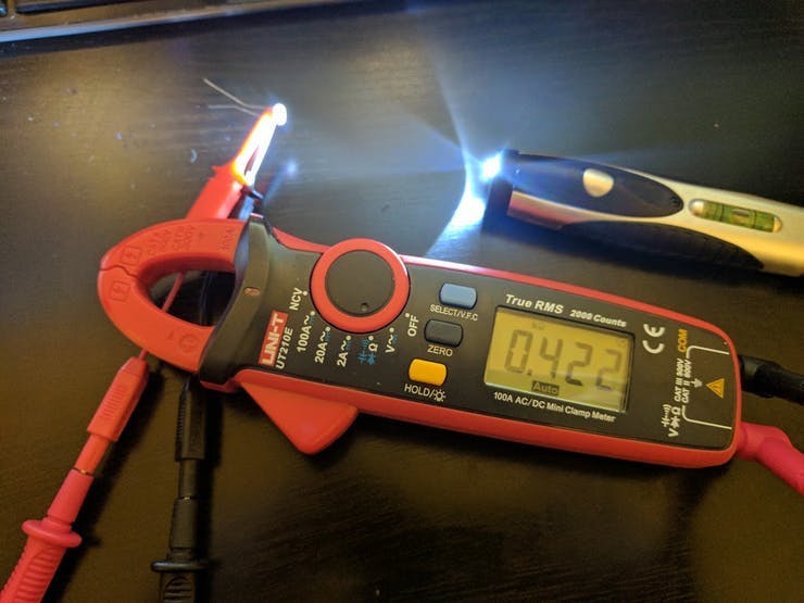

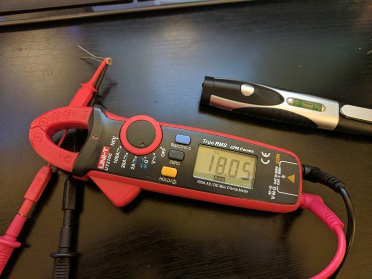

To build the op-amp comparator circuit, the effective resistance range of the photocell needs to be determined. To do this, test the resistance of the photocell under ambient light conditions and then with your light source shining on it. Note: a laser pointer would be ideal, but a flashlight works well enough.
Ambient Light Resistance
Resistance When Illuminated

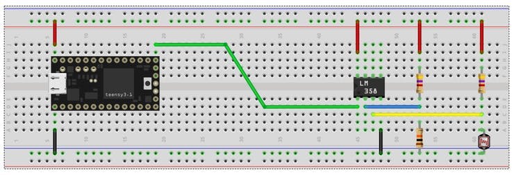

For the comparator circuit, you'll need two voltage dividers. One divider will serve as your reference voltage to the op-amp and the other (with the photocell) will fluctuate around that reference voltage. The range of resistances with the photocell under these conditions is between about 0.5k and 18k. Choose a resistance value somewhere in the middle, say 10k. This will be the value for resistor R3. Resistors R1 and R2 should match. I've chosen 4.7K. To a certain degree, these resistor values are arbitrary, but make sure they match (nominal values) for dependable readings. The voltage output from the photocell voltage divider only needs to alternate between higher and lower than the voltage divider with the two resistors.
Teensy Tachometer Breadboard

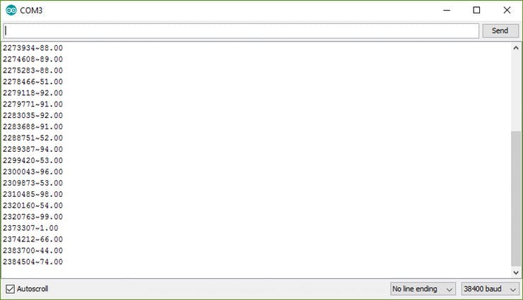

For this project, I've elected to use a serial monitor to record motor speed values. This way, I can easily collect a history of the data and analyze it later. Using the data from the serial monitor in the Arduino IDE, I've graphed the output in an Excel spreadsheet below. With the code provided, the serial monitor outputs lines in the format "time elapsed~RPM" (where time elapsed is in milliseconds and the tilde is used as a delimiter). The serial monitor screenshot below shows the output of the tachometer (the drops in RPM are due to programmed pauses).
Arduino IDE Serial Monitor

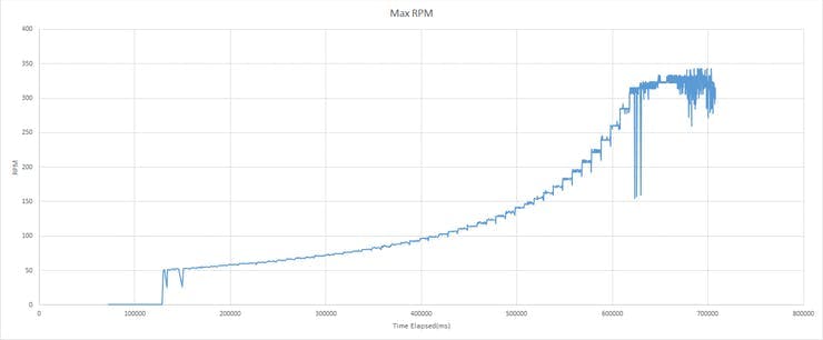

In the graph below, the code on the Arduino Uno with an Adafruit Motorshield v2 (used to control the motor) sped up the motor incrementally until the top speed of the motor was reached. The top speed can be easily visualized in this graph; the speed began to fluctuate wildly above 300 RPM. That value was pretty much expected using this controller-motor combination.
What was not expected was the difference in programmed speeds versus actual output. For instance, I found that when 150 RPM was commanded, the actual output was steady at 98 RPM. For this reason, the tachometer serves as an invaluable diagnostic and debugging tool for the larger project/competition.
