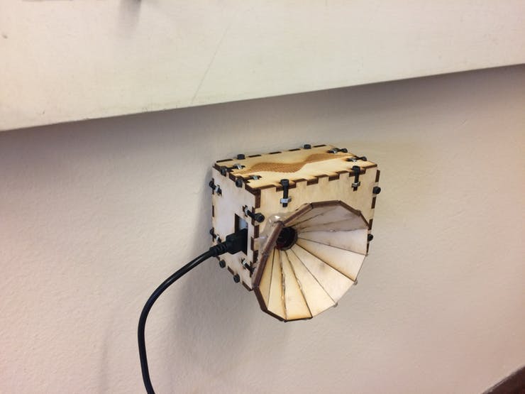

For the final product, we used a wood box as our enclosure. The box uses T-slots so that we can open and close the box when necessary. The box has 2 openings, one for the microphone of the sound sensor to stick out of, and the other for the power cord.
Attached on the box is a cone that we added to help direct the sound towards the microphone. We also engraved our contact information onto the box for anybody who had questions about what data we were collecting.
We had an issue with our breadboard fitting into the box because of a mistake with the size of the inside of the box compared to the size of the breadboard with the sensors attached. We fixed this problem by angling our breadboard inside of the box.

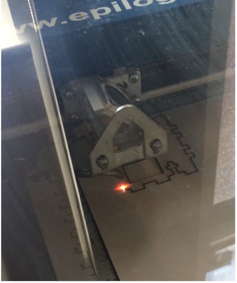

Laser cutting the sides of our box from Baltic Birch Plywood

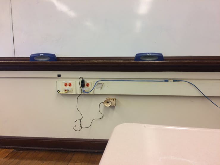

We deployed our sensor in the front of a math class room. The classroom is on the 3rd floor of Lane tech and is used for the majority of the day including periods 1, 2, 3, 5, 7, and 8. The classroom is set up so that all of the desks are facing towards our sensor with the teacher lecturing at the front of the room adjacent to our sensor.
the sensor in place under the whiteboard
Our sensor under the whiteboard, attached by command strips and powered through an outlet.
We had originally wanted to determine if our peers are more likely to talk in the back of the room, or in the front of the room. We had to change our idea because the week that we collecting data was also the week of SAT testing which caused all the class schedules to be different. We felt that the combination of scheduling and moving the sensor would cause our data to be inaccurate.

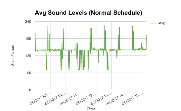

Data Collection Results
When we stopped collecting data we had over 150, 000 data points. We found that the average sound levels did increase throughout the day with spikes during the beginning and end of a class period. These same spikes are also seen in our minimum and maximum data, minimum barely changes while maximum has a spike for the start and end of each period.
There are also low points in our "Avg Sound Levels" graph during the middle of the class periods, especially from 10:45-1:25 which we believe is because many students leave the school for lunch.
We also noticed that each day had a higher average than the one before it. This shows that not only does the sound increase as the school day comes to an end, but also as the week comes to an end. When comparing data collected before and after school, we noticed that the graphs mirrored each other. The major spike in both graphs represents students rushing to class, and rushing to leave school. We were surprised that after school did not show a slower decline because we assumed that kids would stay longer to go to clubs or sports.
