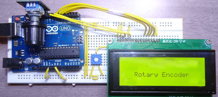

Rotary Encoder with Arduino
Once the hardware is ready, you need to just upload the code to the Arduino board and power up the Arduino Board. Power it with the help of the USB cable or a 12V adapter. When it gets powered the LCD should display the message and then get blank. Then rotate the rotary encoder and you can see the value start incremented or decremented depends on the direction you rotate. You can see the below image.
And when the button is pressed, the second line will display that the button is pressed.

 * Power LCD and Rotary encoder from the +5V pin of Arduino
 * LCD RS -> pin 7
 * LCD EN -> pin 6
 * LCD D4 -> pin 5
 * LCD D5 -> pin 4
 * LCD D6 -> pin 3
 * LCD D7 -> pin 2
 * Encoder Switch -> pin 10
 * Encoder Output A -> pin 9
 * Encoder Output B -> pin 8
